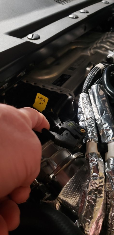

[Quote = mikelr; 806399]? Každý, kdo ví, co je uvolnění kabelu pod krytem motoru pracuje [/ quote]
Can you please take a picture of the exact location?

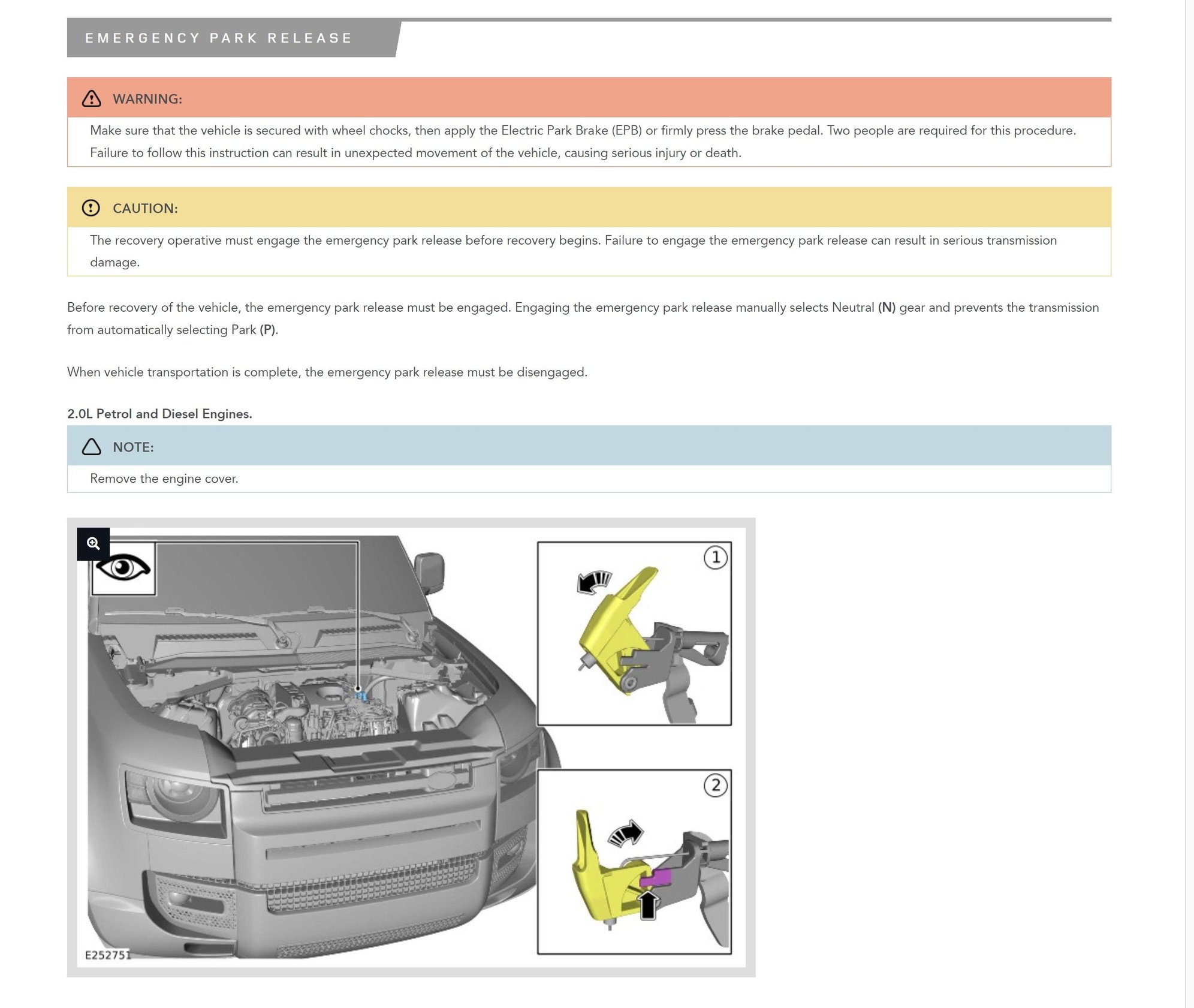

@_Allegedly has previously posted a Workshop Manual in another thread. I thought that I found this in iOwner, but the Search is proving to be a PITA. So here it is out of the WS Manual:
At one time, I thought I saw a document on towing the Defender that went into all of this in TOPIx. I can't relocate it either there or in the Owner's Manual, but I distinctly remember reading a lot of doom and dread if you didn't do this before towing the Defender. In fact, I think they distinctly recommended this before flatbed towing as well because it would drag the Defender onto it before leveling otherwise. I'll keep looking, but if one of the other members who have access can find it I'd appreciate the assist. With JLR, you have to get the terms just right. There's no AI on that search.

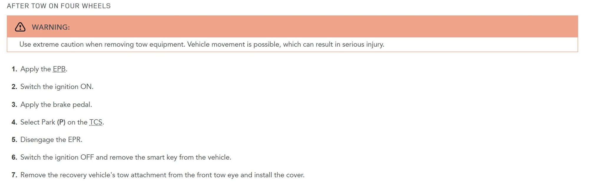

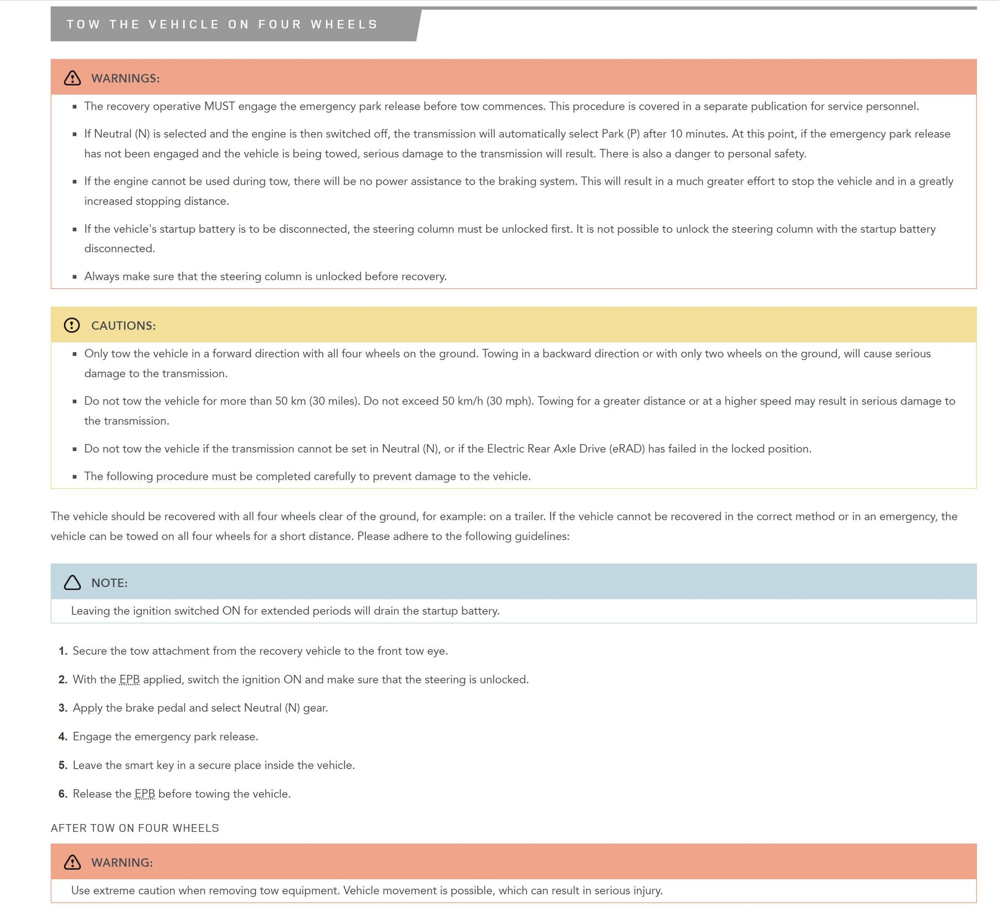

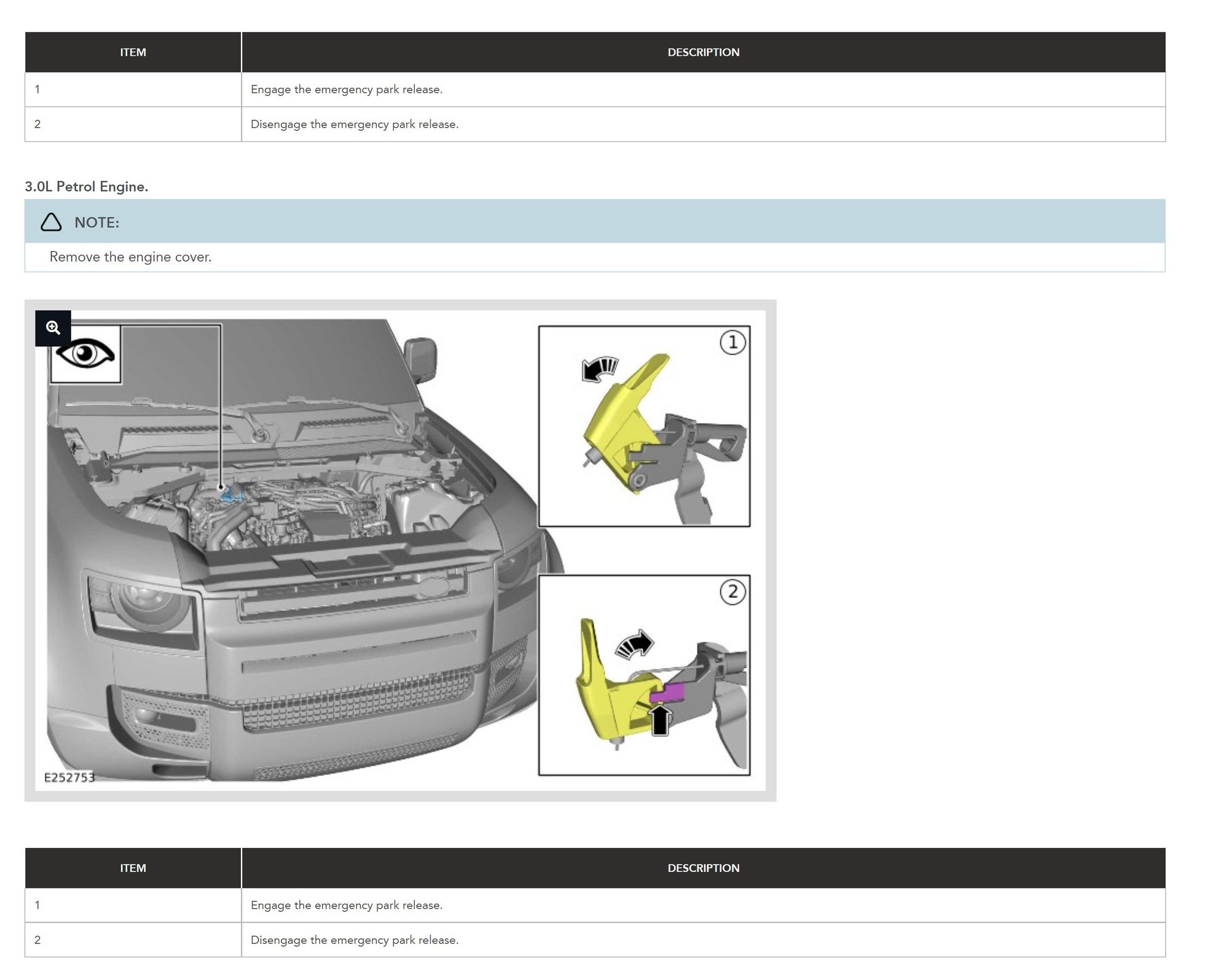

Here's the recovery parts. This should be WIDELY shared amongst any owner as the likelihood of a tow is high.
