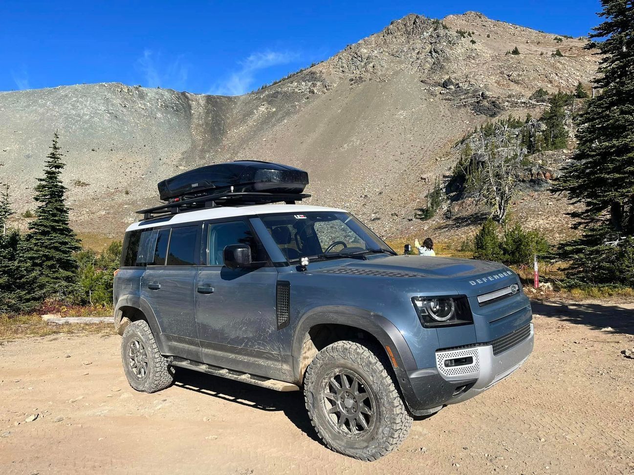

I use a Thule XL motion.
It has a recessed floor designed for optimal use with crossbars.
I modded two bars of the rack with some 1/2" plastic spacers and longer bolts. Raises two bars and allows the box to fit. Cost is about $10 Here's the details
This year I decided to try mounting the box without the mod. It mounts just fine. The floor of the box bends a bit but it's solid. Not a problem.
No mod used
No mod used
