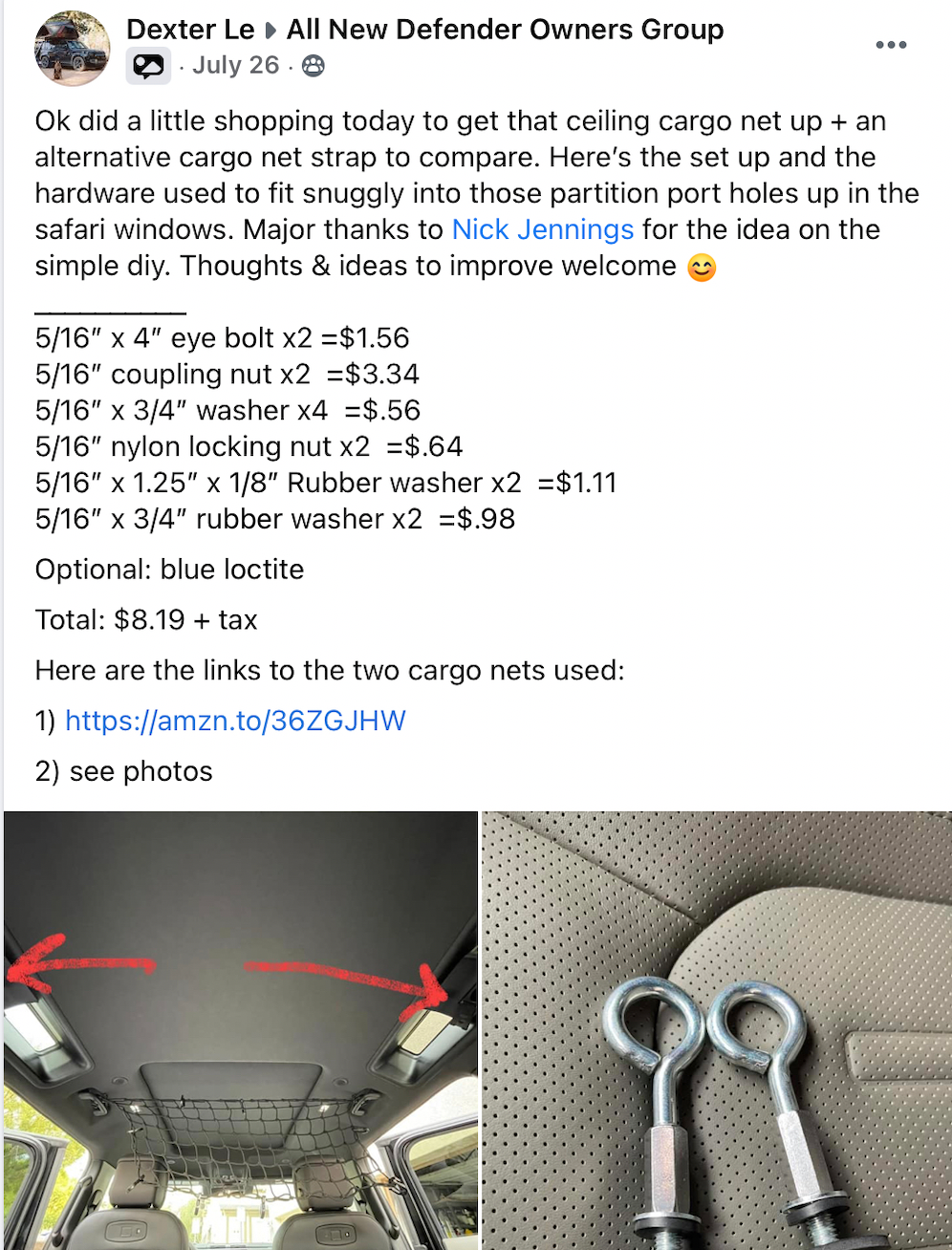

It has been awhile since this was posted but maybe you are still on this site. I am interested in the rings that are attached to the opening between the two safari windows. Do you recall where you got these? Thank you
Old May 4, 2025 | 09:58 PM
Bjs1234's Avatar
Joined: Jan 2021
Posts: 122
Likes: 51
@Jemez Springs NM Here's the screenshot with the ingredients. Hope this helps.
Old May 4, 2025 | 09:59 PM
Bjs1234's Avatar
Joined: Jan 2021
Posts: 122
Likes: 51
Also, PowerfulUK make a fancy one: https://www.powerfuluk.com/products/...jXYuw4NxHGhBx-

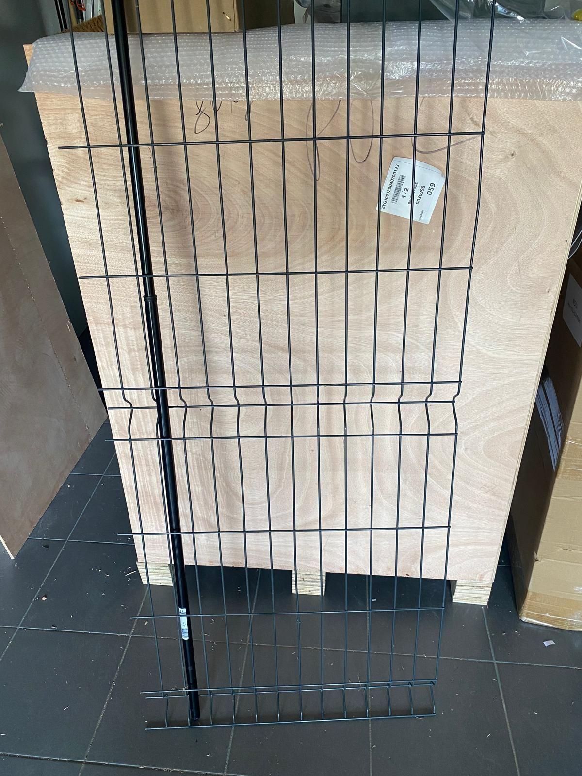

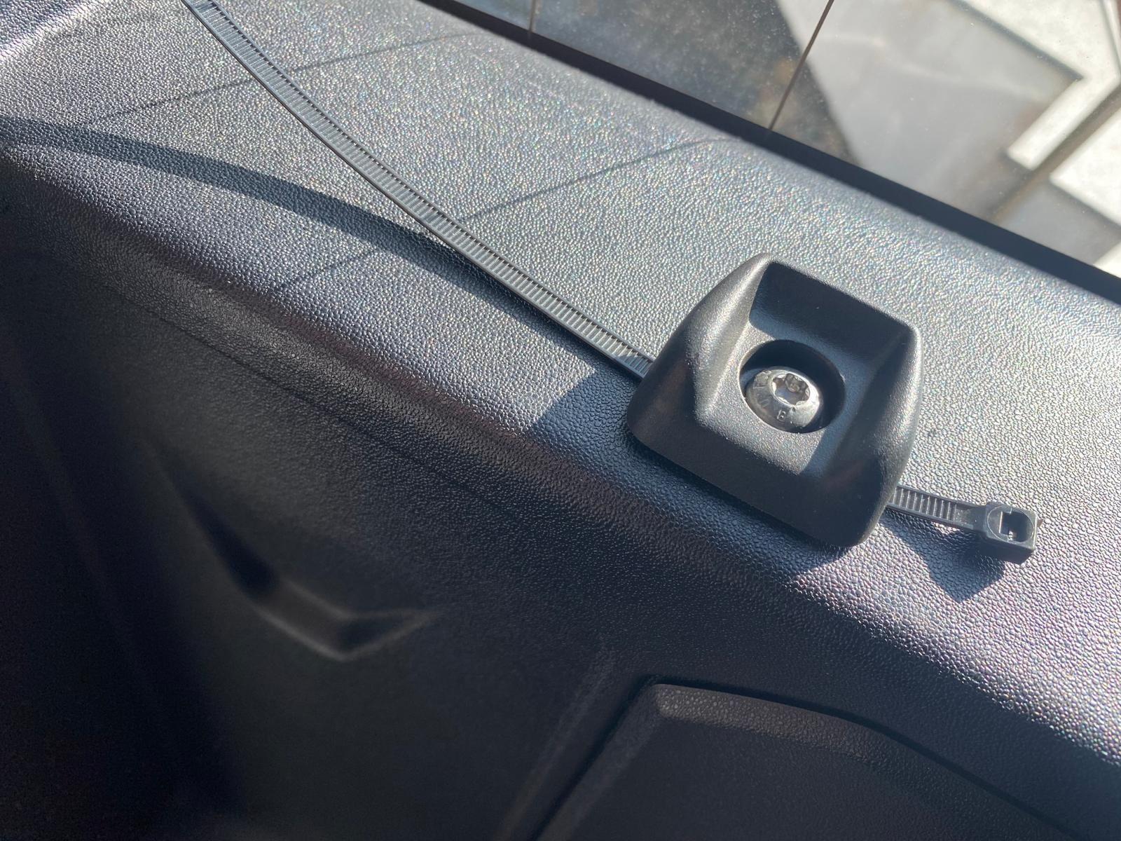

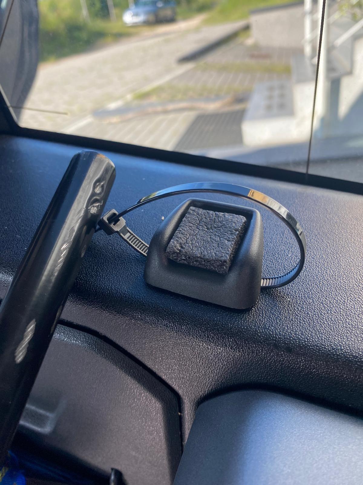

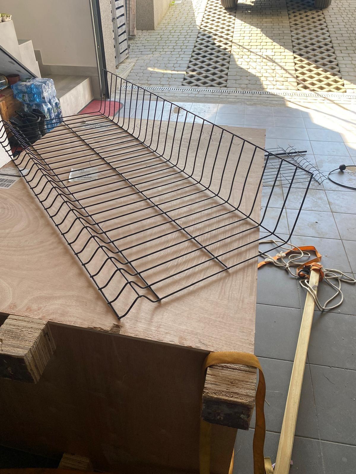

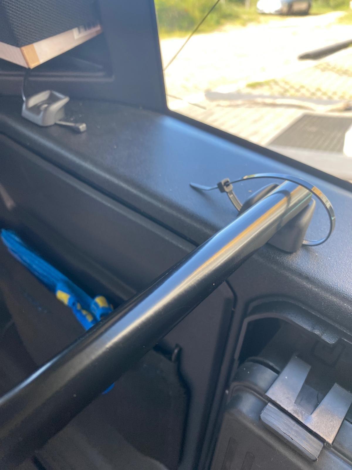

I'll be on the trip tomorrow morning and had to come up with the cargo shelf idea. Here is the result of mine DIY project
Could I do it better: probably YES
Could I do it cheaper: probably NOT
Resources used:
  • 2 telescopic steel painting poles (1-2 m) 5 EUR each (removed plastics on both ends)
  • zip ties
  • fence panel (leftover from my backyard)
  • self-adhesive foam (for shock-proof and sound/vibration prevention)
  • 2 hrs workload
PROs: cheap, fast setup/removal
CONs: less payload (tested with approx 20 kg and was OK) comparing to professional ones
