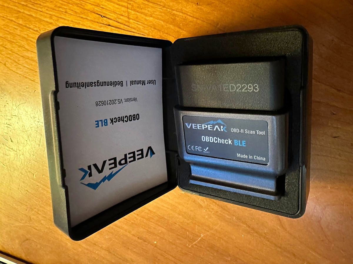

This is a classic example of why it is worth it to spend the $15 to buy a code scanner. Your light can be anything from your gas cap is loose, to impending tranny failure. So buy a scanner that will work with your phone off eBay or Amazon and get an app that will support. Personally, I like OBD Fusion's app. It has loads of features and supports a host of OBD readers. I just recently upgraded my reader to a Bluetooth one, vice WiFi version. It is a Veepeek and does all the scanning functions, just hooks up faster to the wireless. OBD Fusion offers a lot of gizmo functions, like lots of user selectable gauge packages that will display on your iPhone or iPad and also do maps showing milage along a route. Guess what, It shows that the car uses more fuel going uphill vice downhill. Who would have guessed. Anyhow you get a cool looking map color coded to milage.
So do yourself a favor and get a scanner. Why the dumb display does not tell you this stuff, like have a maintenance page, is infuriating. But no car out today seems to have that. Then you can sound all knowledgeable and tell the dealer that you engine is misfiring on #4 cylinder. BTW, new/used, big price difference. Get a used one on eBay for a whole lot less, they don't exactly wear out.
