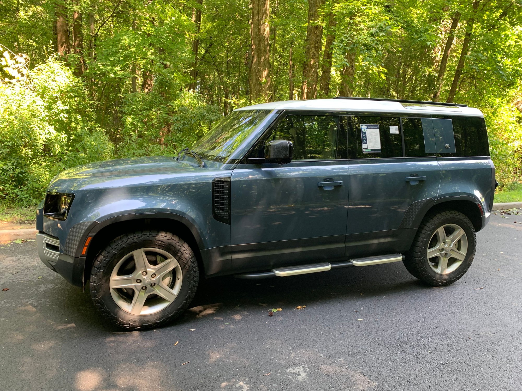

Long time LR owner here having had almost all varieties since the mid 1990s. Currently have a 2004 Discovery 2 and have had my eye on the “new” Defender since introduction. Now that the used market has brought the price down to my level I found a really nice Tasmin Blue 110 SE, P400, 37k miles, full glass sunroof, 20” alloys with some nice off road tires already fitted.
What if anything should I be concerned with and/or be sure to consider.

Well I pulled the trigger today on this 2021 110 SE in my favorite Tasmin Blue. It mimics the 1995 Arles Blue NAS station wagon I never should have sold.
