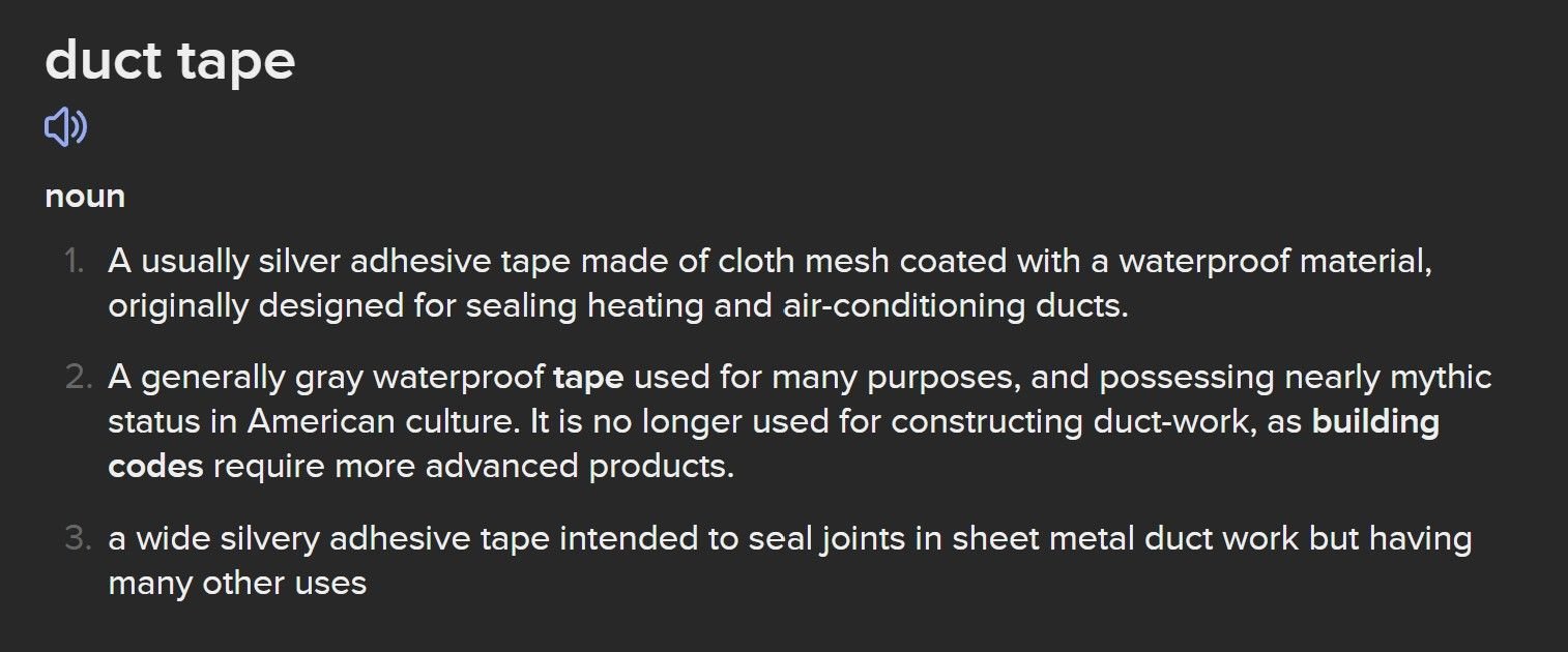

I'm well acquainted with that technique. Shade tree mechanic's purchase duct tape by the case.
Air intake leaks, what do I have on hand that can seal that flow of air.....?
BTW - Make sure that part is on order for when the roll runs out.
