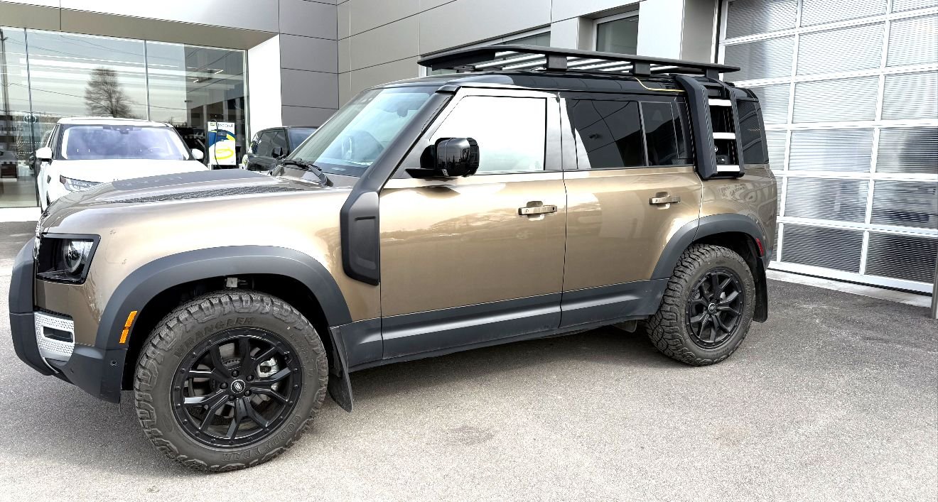

Folks,
I searched quite a bit before purchasing and have found that a lot of info was not quite right, hence why I’m sharing this here.
First of all, the installation is extremely easy, thank God cause they came off immediately after I came back from my test drive.
Reviews on the net and youtube mention that the highest one should go is 1.5 inch cause any higher creates a stiff bouncy ride.
Well I got news for you my friends. My one inch lift rods created a very noticeably stiffer ride. The road around my house has quite a bit of damage and the test drive caused my to feel all the cracks in the road, which I had forgotten about ever since trading my Jeep wrangler for the new Defender back in January.
I got back home, dove under the Defender, reinstalled the stock rods and went back… relief, all was smooth again. I will not stand a stiffer ride, just for looks. But speaking of looks, suddenly, my 275/55r20 were looking a bit small in the higher wheel opening.

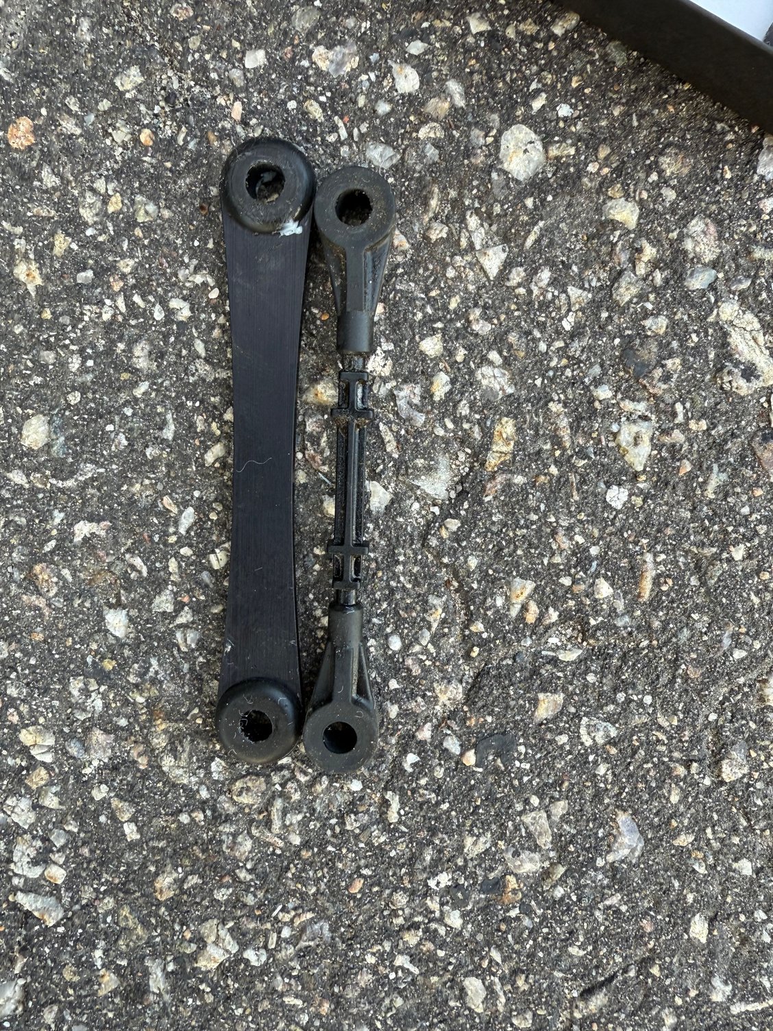

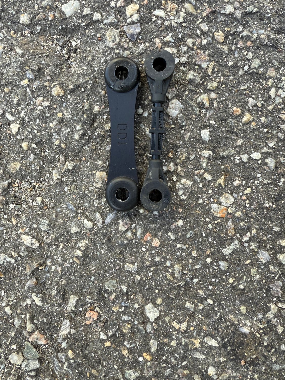

One last thing I found weird, the rear Proud Rhino rods were a bit longer than the stock ones, while the fronts were actually shorter than the stock ones.
So unless you’re the type of person that prefers looks over function or comfort, think again. But then again, as said the 32 inch tires looked small in the wheelwells.
