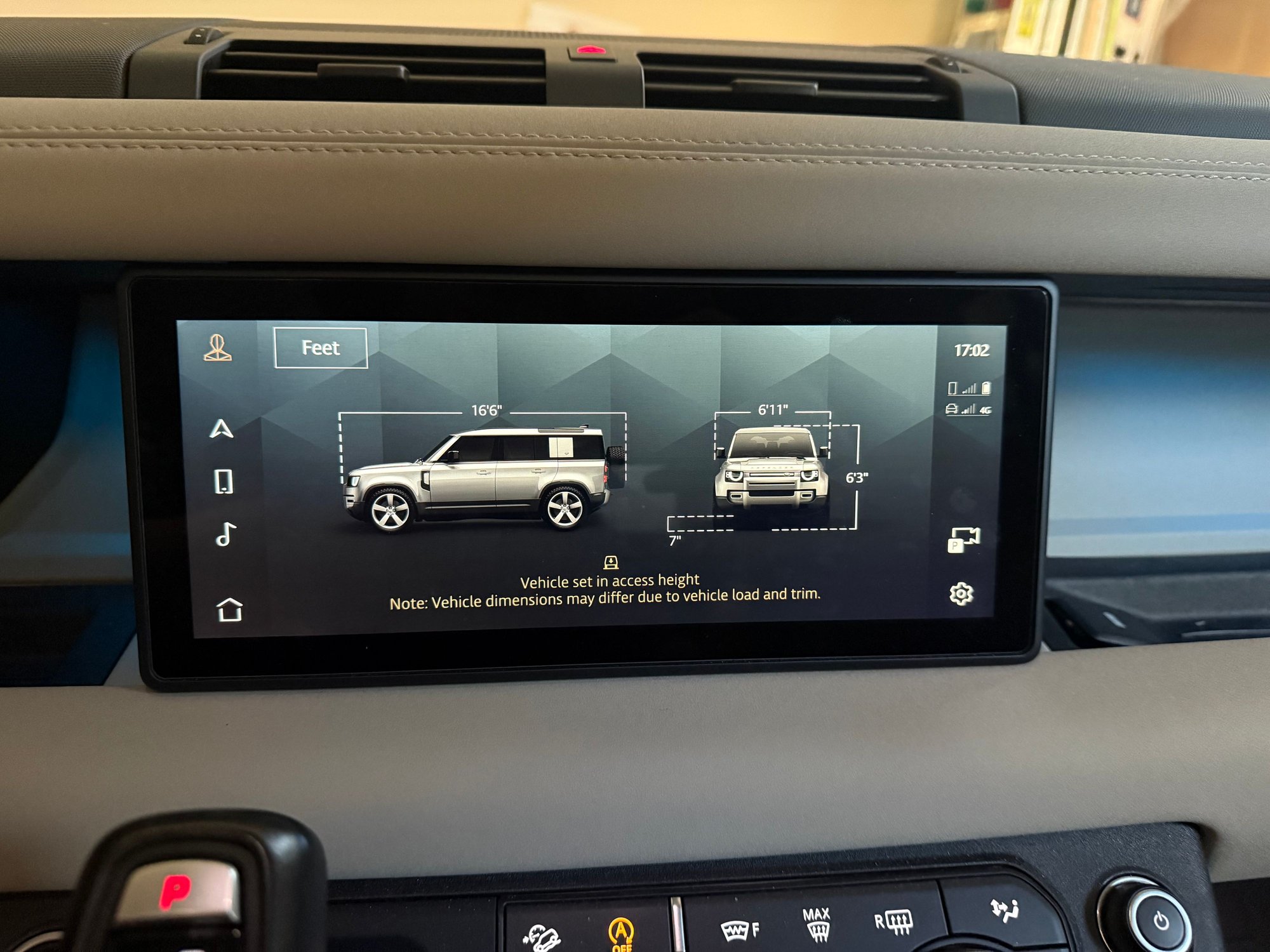

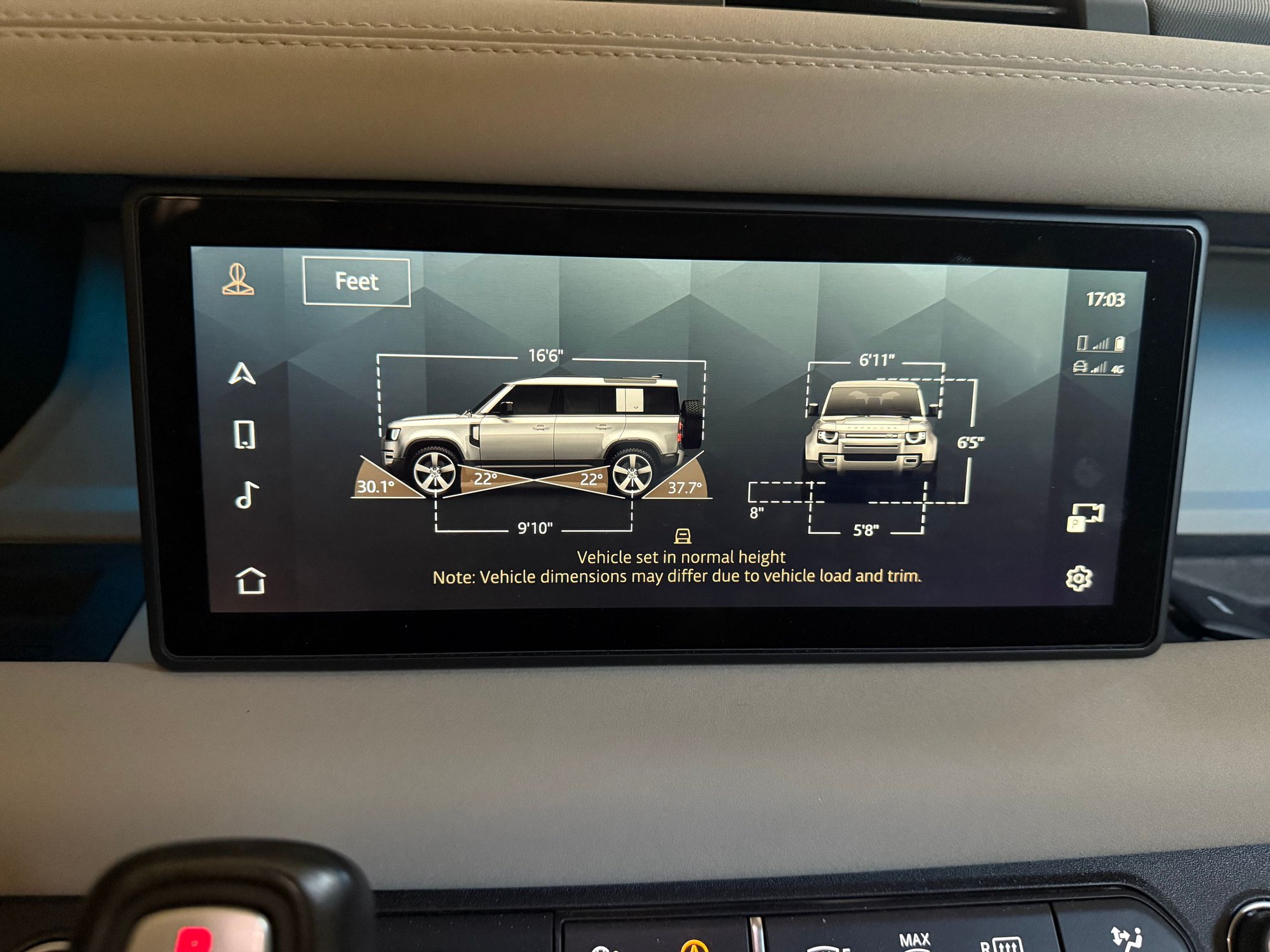

Defenders on air suspension (which is a must-have option, IMO) have access height, which lowers the car a couple inches. There is a menu in the infotainment system that gives exact dimensions. I didn't drive mine today, but I can update this post with a picture of the dimensions screen when I get home tonight.

If you measured it and it is in fact more than 6’5” then you will be fine. On air the standard height is exactly 6’5” without accessories, such as a roof rack. In access it is 6’3.” Also be mindful that if you have slightly larger tires like I do, then the dimensions will change, so the dimensions screen will be slightly off.
