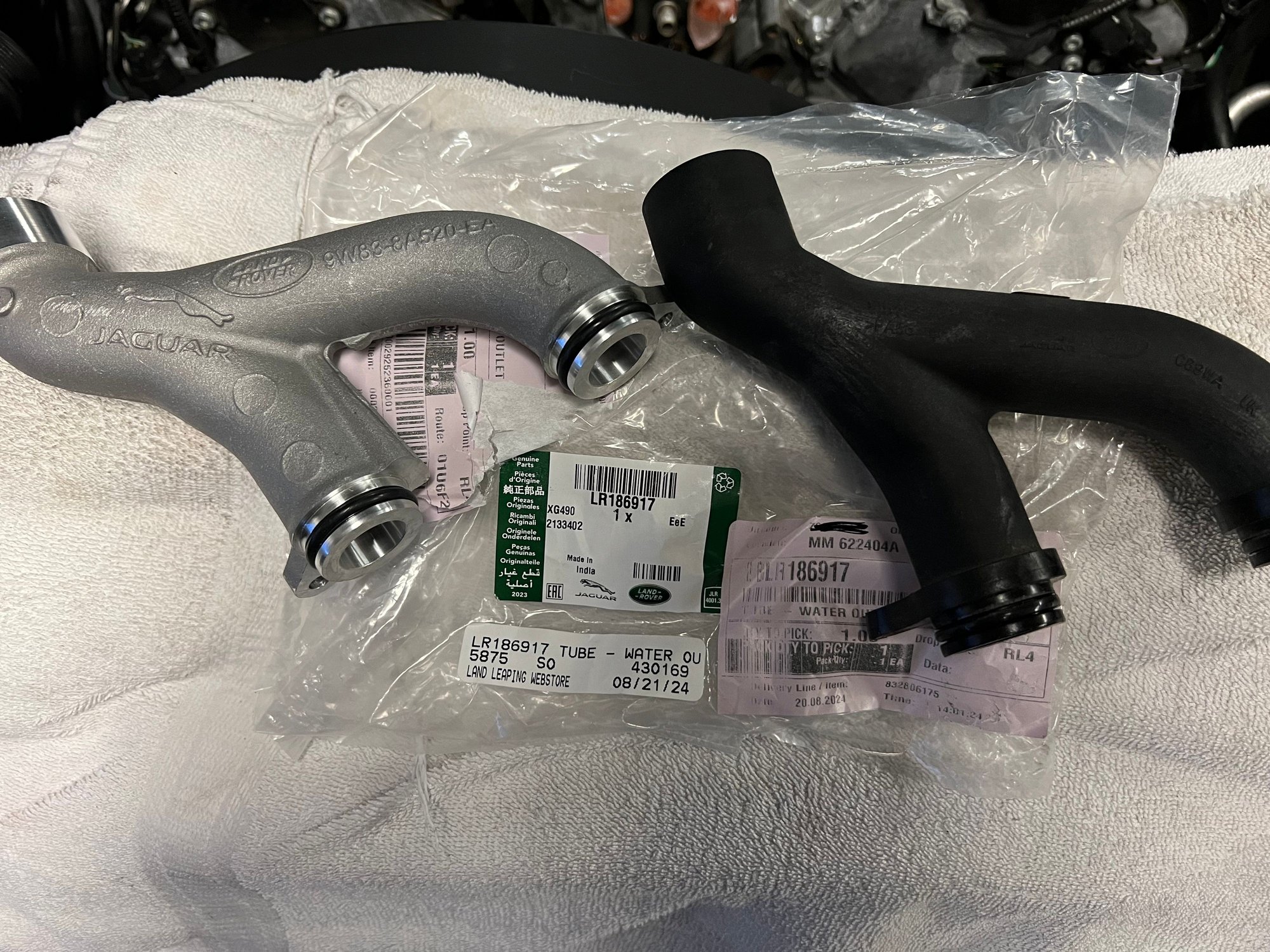

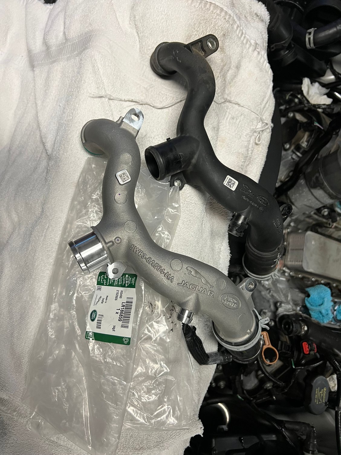

I would check yours when you get it. Some have the 2 front cross over pipe, the upper and lower part, in aluminum from the factory. I replaced them on our L405 with the oem aluminum pipes and replaced the rear crossover with another new oem.
I would wait for now, time and/or mileage can cause the leaks. I did them on our L405 at 4 years, only 22k miles and they were starting to weap.

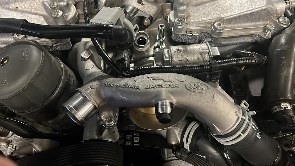

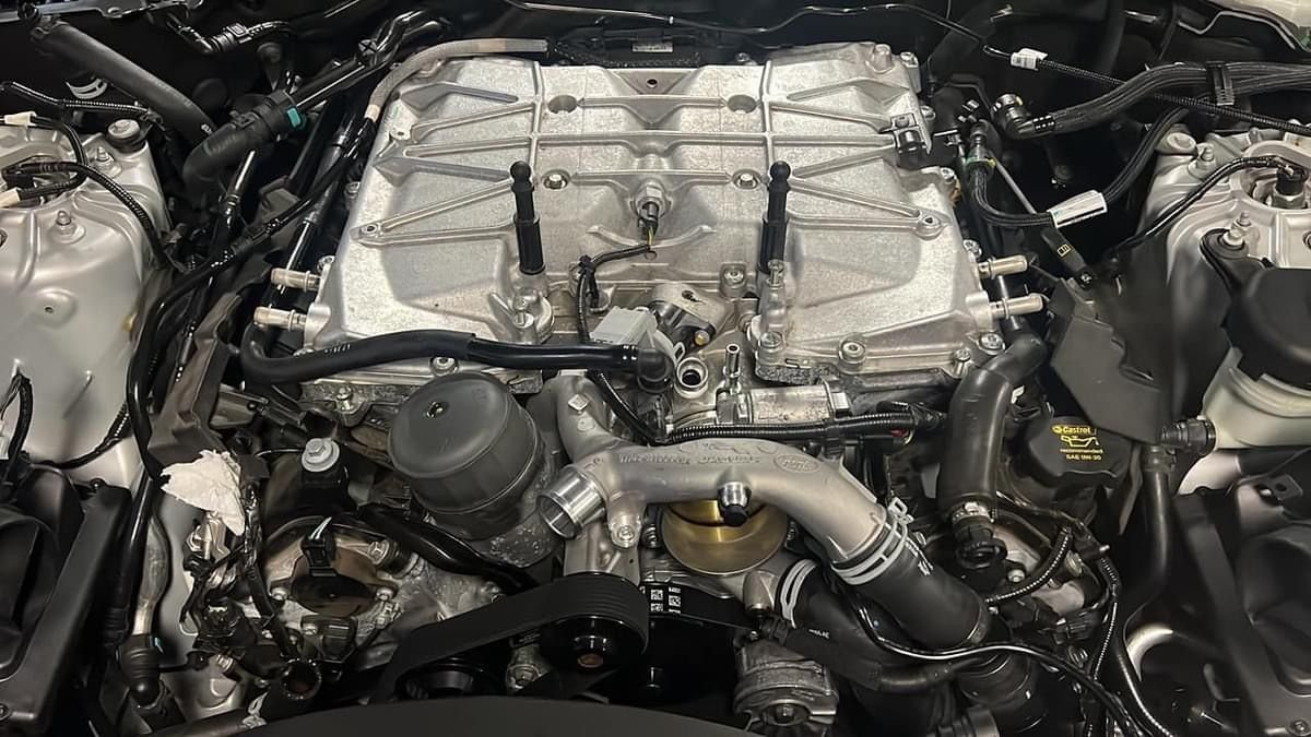

somewhere around 2018ish I believe they upgraded to a newer design plastic y pipe. Around 24 they upgraded to aluminum from the factory.
Some pics from doing the job on our RR. Our 24 has them from factory. Very easy to check if you lift the engine cover.

Thank you for the reply with pictures. I checked mine and the exposed pipe is indeed aluminum just like shown in your pictures. I can't tell on the smaller Y-Pipe that resides underneath the supercharger as it's hidden. The thermostat housing in my '26 is still plastic though.
Edit: As shown above by Skyfall, JLR now offers genuine aluminum parts to replace the plastic ones, so it's possible the newer '24-'26 already came equipped with both
