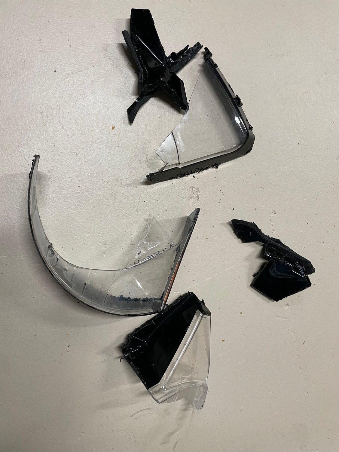

I don’t know exactly what a ‘headlight shop’ is, but just some insight on my repair before taking it to someplace that may not be up to the task. My bezel was broken and I wanted to replace the bezel instead of the costly entire headlight assembly. Bought the bezel from PowerfulUK, removed the headlight assembly and at first glance thought I could just dislodge the bezel with ease. Not so easy. It is seated into a groove around the perimeter of the assembly with an incredibly strong adhesive/watertight glue-like sealant. It took about an hour or so of persuasion and the use of an oscillating multi-tool saw, a Dremel tool, and various picks and screwdrivers to cut and pry and gouge out all the remaining bits of bezel, and then the same amount of effort to scrape out the sealant, which is amazingly strong. A good testament to the waterproofing job JLR takes to ensure the headlight assembly is watertight. Once I had cleared the groove of all the remaining sealant, I placed the bezel on the assembly, dry fit first to ensure proper seating, then I used a two part epoxy sealant to reseat and reseal the new bezel. End result: looks like original, works fine, and saved thousands. Good luck to anyone who takes that route.
The remains of the broken bezel after surgery.
Added these headlight protectors to avoid this problem again.
how do you break these lights? fender bender? that doesn't work with 110X because of the headlight sprayer too.
I have no idea how this light cover broke. Don’t even know how long it was before I noticed it, was washing it one day and to my horror saw this gaping hole on the bezel. Was it a rock, some road debris? Some jealous person who hates LR owners and needed to express themselves? Besides, when I was trying to remove the broken bits it was extremely difficult because the plastic is very durable. Literally had to cut it out in smaller pieces with a multi-tool saw owing to its strength, so I can’t imagine what had enough force to shatter it.
