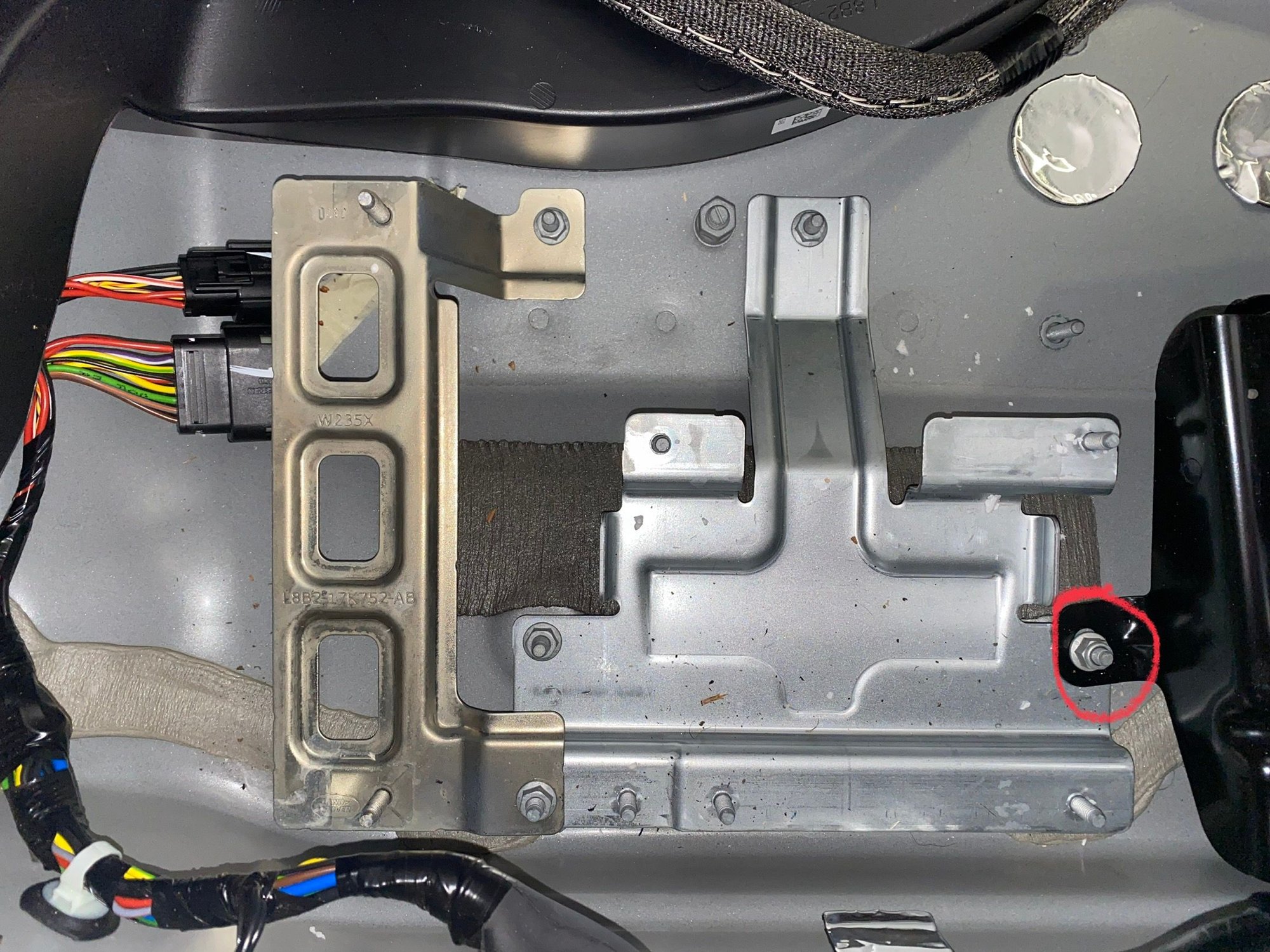

Update on my attempted install today on the P400 5 seater: unfortunately, the Renogy 100 Ah Bluetooth battery is significantly taller than the standard (8.7” vs 7.9”) I did not catch this, and I found out it does not fit in the bottom left corner where others have made it work. I tried looking at installing horizontally, but it doesn’t really make sense.
@Guapo When you said you moved the silver mounting bracket, was there a trick to it? Mine is bolted along with the compressor, and it seems like quite a bit of unbolting of the compressor would be required.

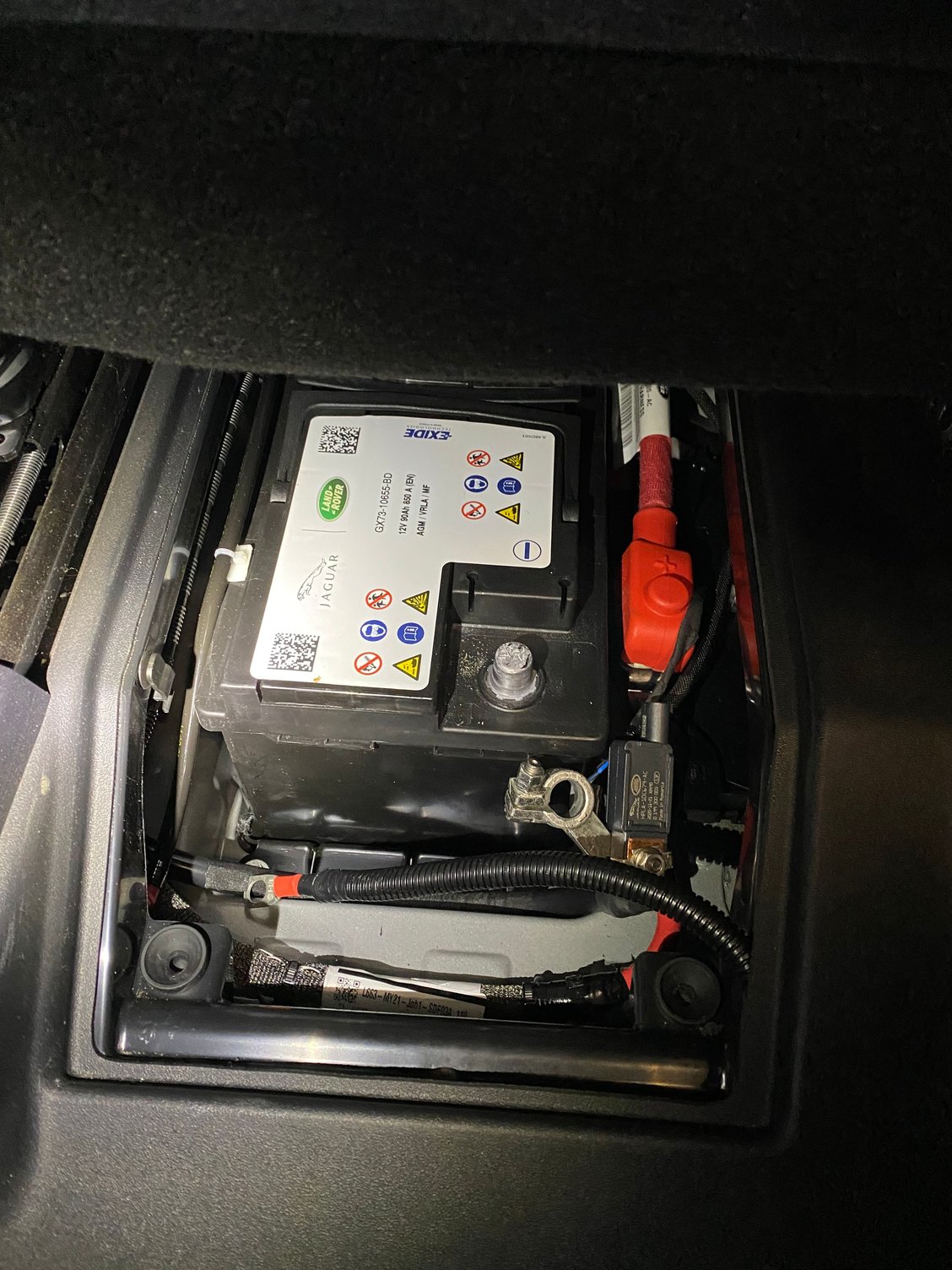

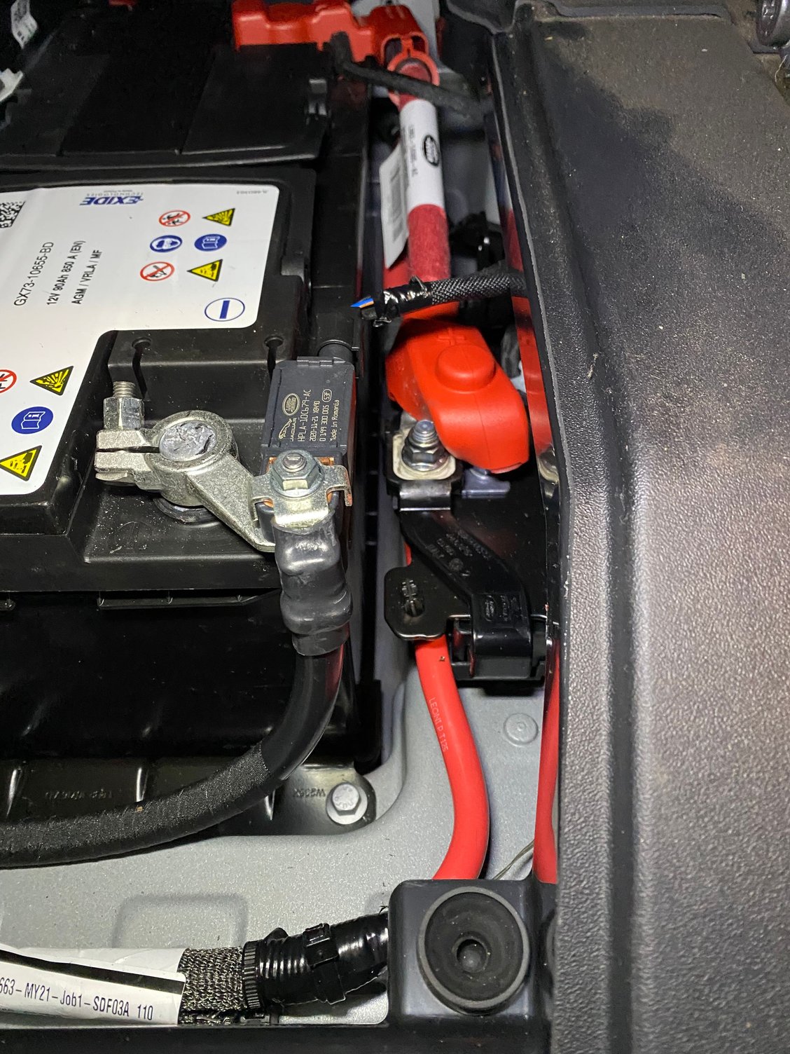

Thank you! One more question while I'm at it: in the battery compartment, it looks like there is a more accessible positive lead next to the negative. Did you connect there, or directly at the battery?

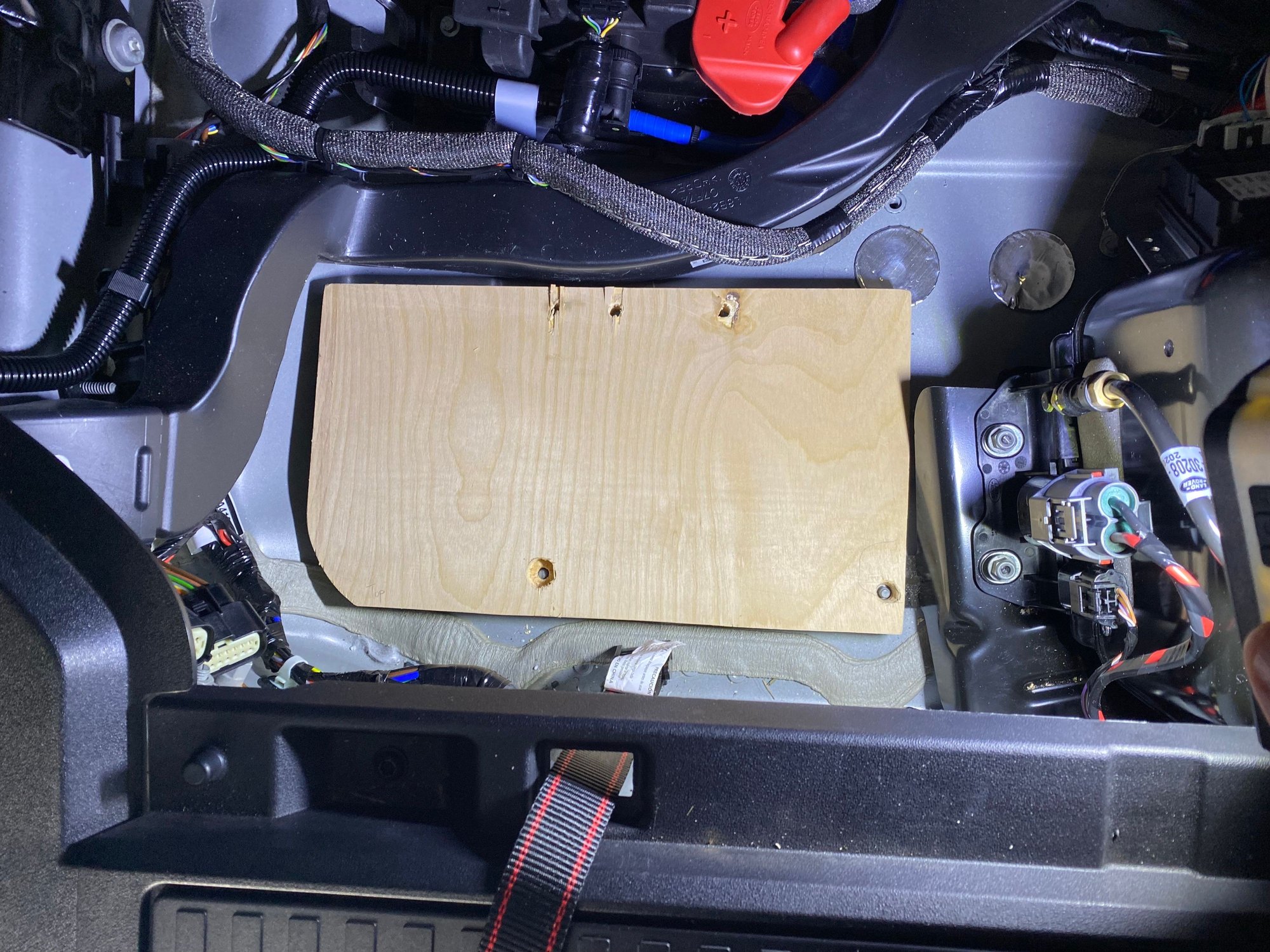

Here is my progress report:I was able to loosen a bunch of bolts around the compressor to lift up that bracket and fit in my Renogy 100 Ah Bluetooth battery on a small plywood platform. I have secured it with straps to the standoffs in the floor.
Challenges encountered:
- Unable to bolt wood directly to floor - not enough clearance to fit a bolt into the standoffs and have any material leftover. Am using lashing straps directly into the standoffs, bolted, and around. I will put grommets into the straps so they don't wear apart.

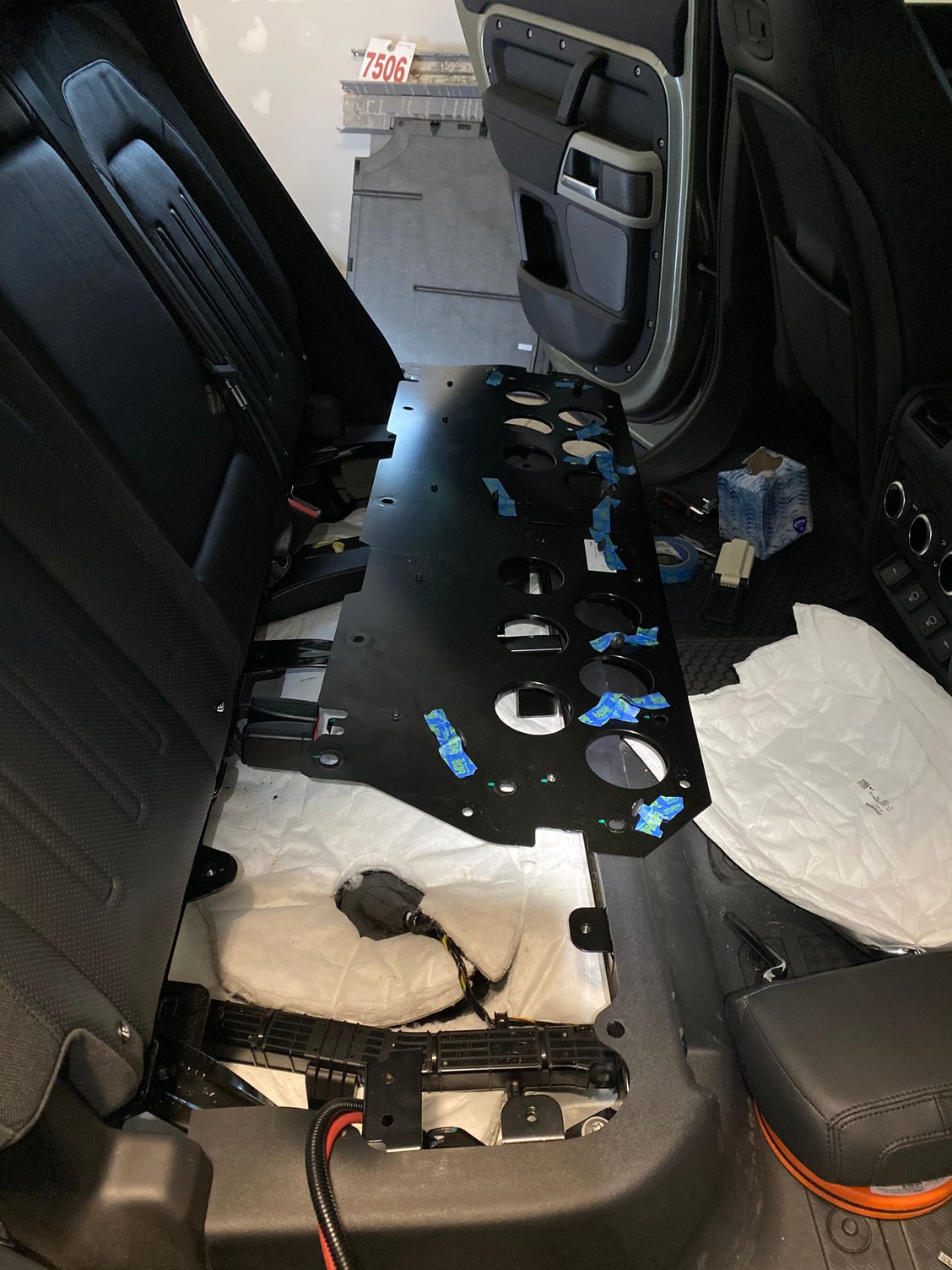

I ran the wire from the battery compartment to the load space using the tips posted here. It was a pain to get it to route but I was able to do it eventually.
- Removing the foam piece from the rear seats - one of the bolts was misaligned and cross threaded from the factory
- Got my fishing line stuck. Ended up removing the entire top of the rear seats to free it which is a ton of bolts and clips.
Rear seat with full top removed. You should only have to remove the foam piece, not the entire top!
Battery mount in bottom left of cargo area. Note: I did not end up lashing through the plastic in the end.

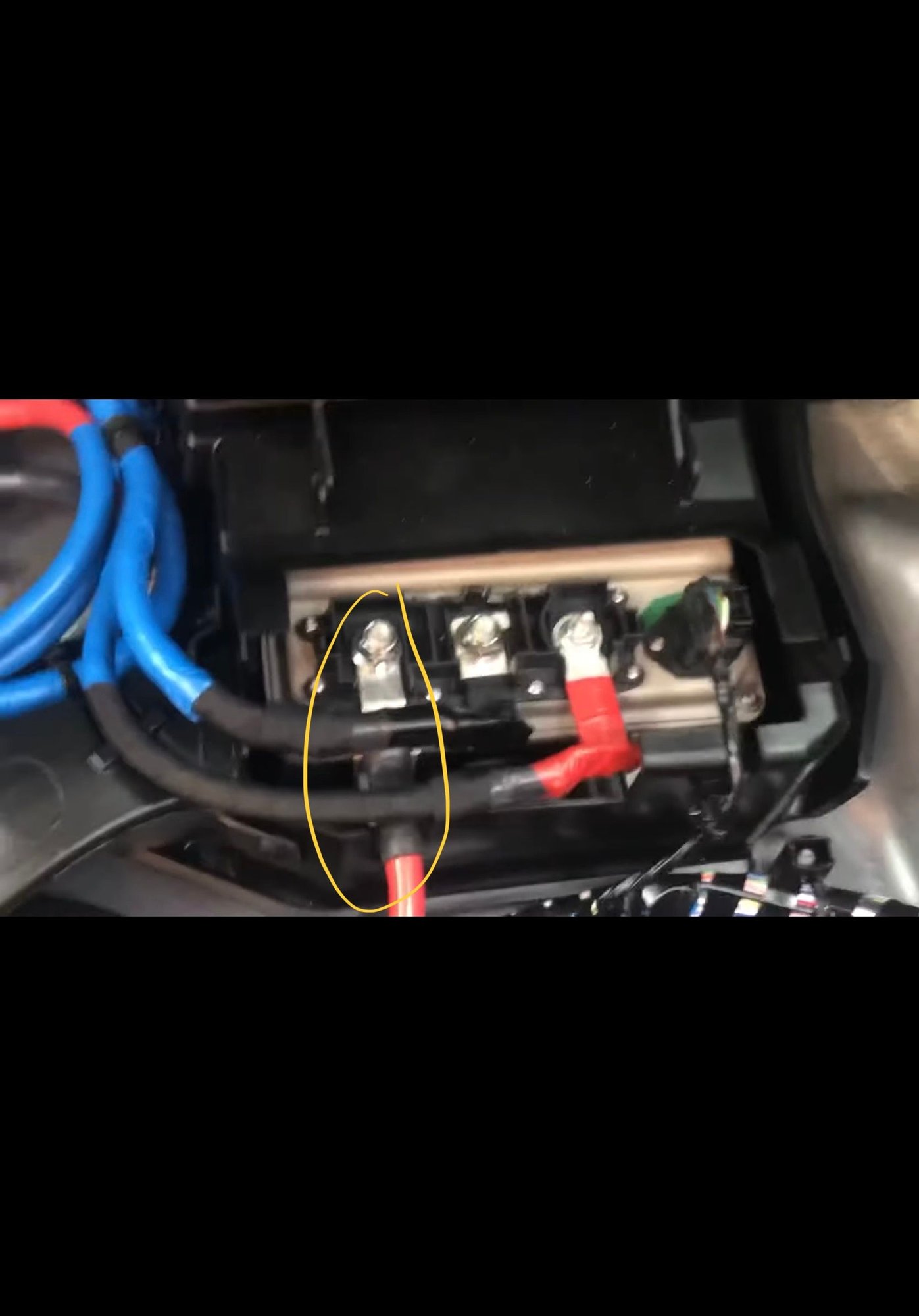

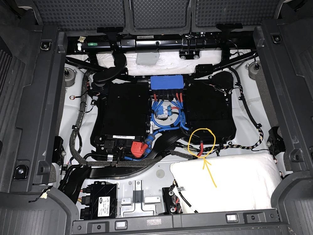

Saw a guy on YouTube, down-under, installing a dual battery system in a 2022 D110 MHEV (he says a P300 but I don't think they make those in MHEV. Everything looks just like my 2022 P400 MHEV and he taped into a positive terminal found in the rear under-cargo space that he claims is coming directly from the starter battery ( pictured below). Can anyone confirm?
He says is his follow up comments that it has been running his system perfectly for the last few months, and power to that point shuts off with the car. That would obviously mean that the cable isn't a direct connection to the starter battery and must go through some relay. Wondering if a 40A DC DC charger would pull too much through that "mysterious" but promising circuit. It Would be a lot easier than running under the floor to the battery…
