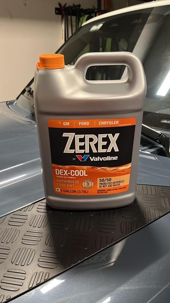

and Gavin thx i’ll look around for this. I was in the colorado mountains at a very limited Napa. Didn’t have it. Google says this Zerex is $16?? FYI the dealership offered to sell me jug of unobtainium for $99. “But you dilute it 50/50 so you get 2 jugs”. Ugh
