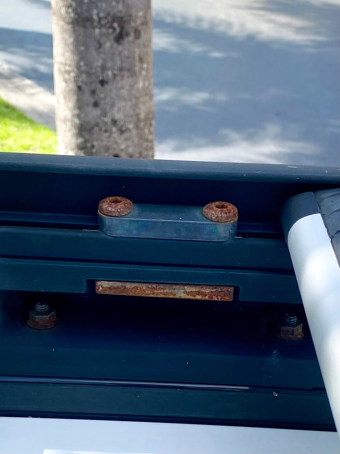

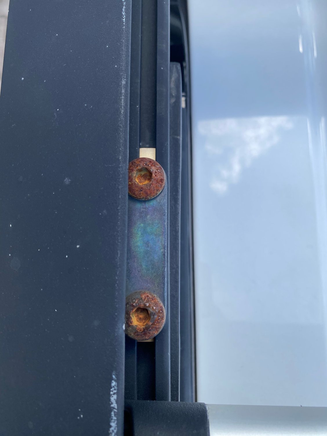

The OCD side of me has had it with the rust on the expedition roof rack hardware so planning to take them off to properly clean and paint them. For those that have the rack, does it look the same, better or worse?

Interesting. It's true that 5 years of salty South FL air can do some damage, but it does seem excessive. Was looking at the installation instructions and seems the impacted parts are the bolts and nuts and the separator (E on the diagram below). So, I am planning to replace the hardware with new corrosion-resistant ones and treat and weatherproof the separators. Fun little weekend project. @GavinC if it's not much to ask can you take a pic of yours, just want to see how good looks like.

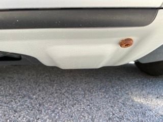

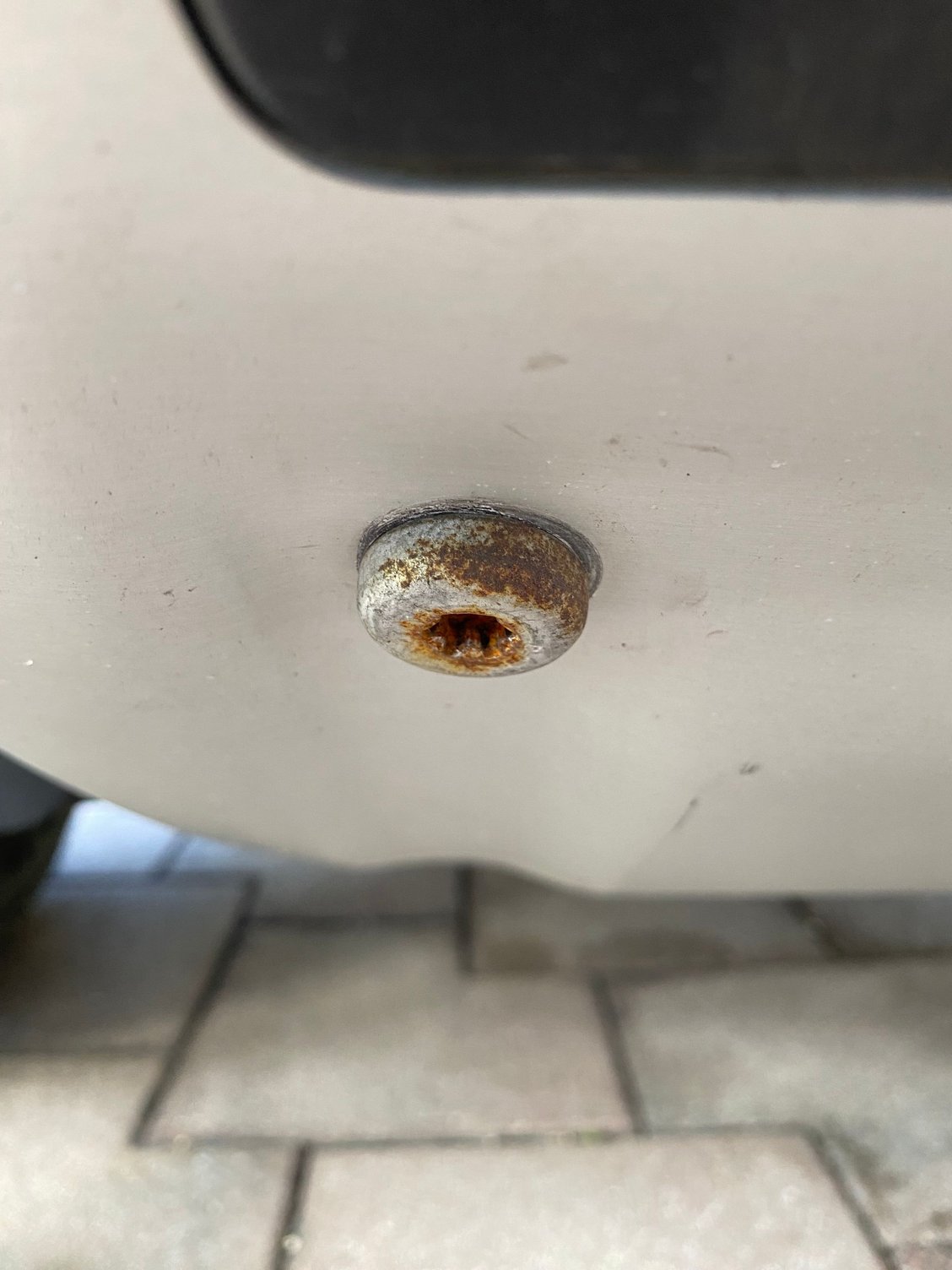

I also live on the coast (in the NE). 2022 with the Expedition Rack from new (late 2021). My bolts are not quite as rusty as yours, but pretty bad. I'm wondering if replacing them with marine grade stainless is the way to go? The fastenings on the underbody protection at the front are even worse (see below) and those don't look like standard fasteners - but maybe its a good excuse to head to the marine places and see what they have.
Edit: You'd think that after 75 years of experience in the UK, the one thing that JLR would have solved was rusting and galvanic corrosion.
The underbody ones are also a bit rusted but much less than yours and I have removed those a few times so might be related to that. Want to treat those too!
