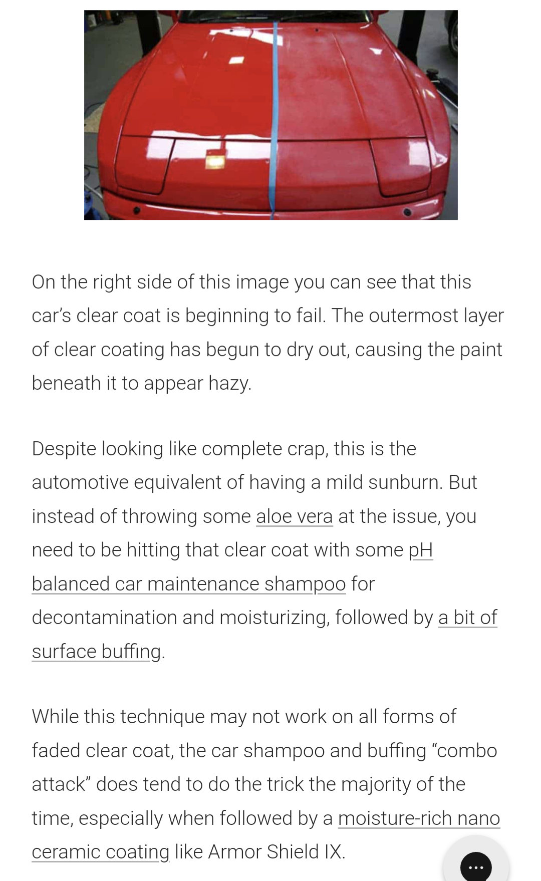

Narvik gloss has a clear coat. When clear coat oxides, it turns milky, hazy, and will look purple on black paint.
I don't have this issue but, has anyone just tried to buff off the oxidized layer? It's really easy if you have a buffer and some basic skills or a good detail person if you don't. It can't hurt if that's not the problem.

It does look like the start of clear coat failure. I hear you that it has been garaged but, if that one particular trim piece was manufactured out of standard it may be overly sensitive to that UV or acid damage. Since it's not just you, it seems like there's a batch like that out there.
Narvik gloss plastic, from what my dealer's body shop told me, does have a clear coat. They could be wrong and/or this could be the pigment molecules being bleached or breaking up.
Either way, it's not going to stop on its own.
Going back to the reason I asked, mine was delivered with scratches on the rear trim (same plastic). I told them I would rather deal with it myself. Here's how it went.
That plastic buffs very very nicely to a perfect mirror finish so, you can try it. It might temporarily fix the issue and you could use some ceramics to stop more damage. I agree the dealer should take care of it but, sometimes, being your own warranty is just easier.
