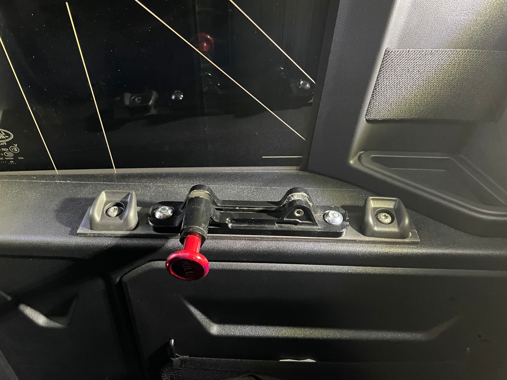

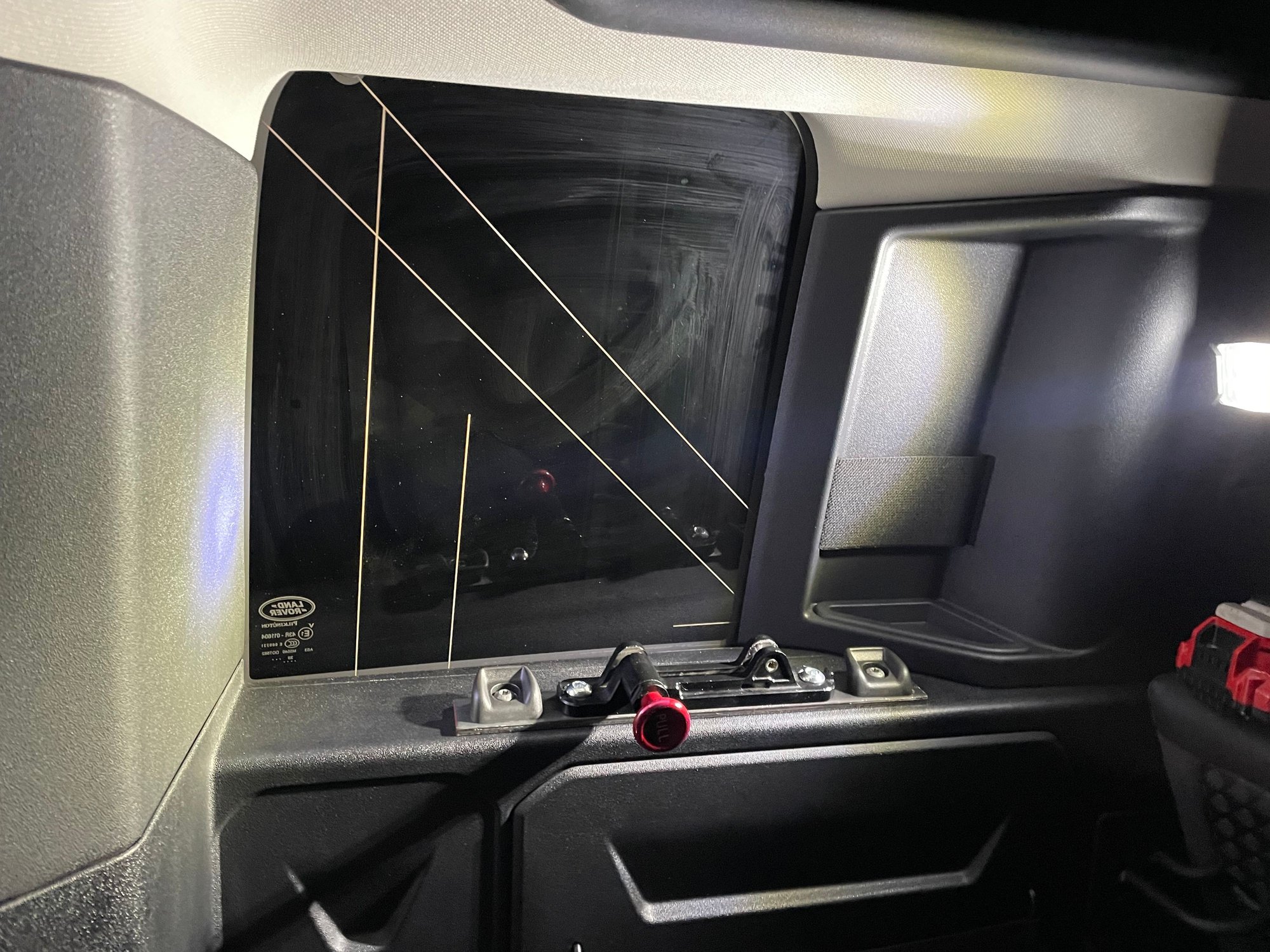

Mine came from the dealer with a fire extinguisher mounted under the passenger seat but it is annoying and gets in the way. I assume there is a LR part for it. It is required by law here for all cars to have a fire extinguisher.

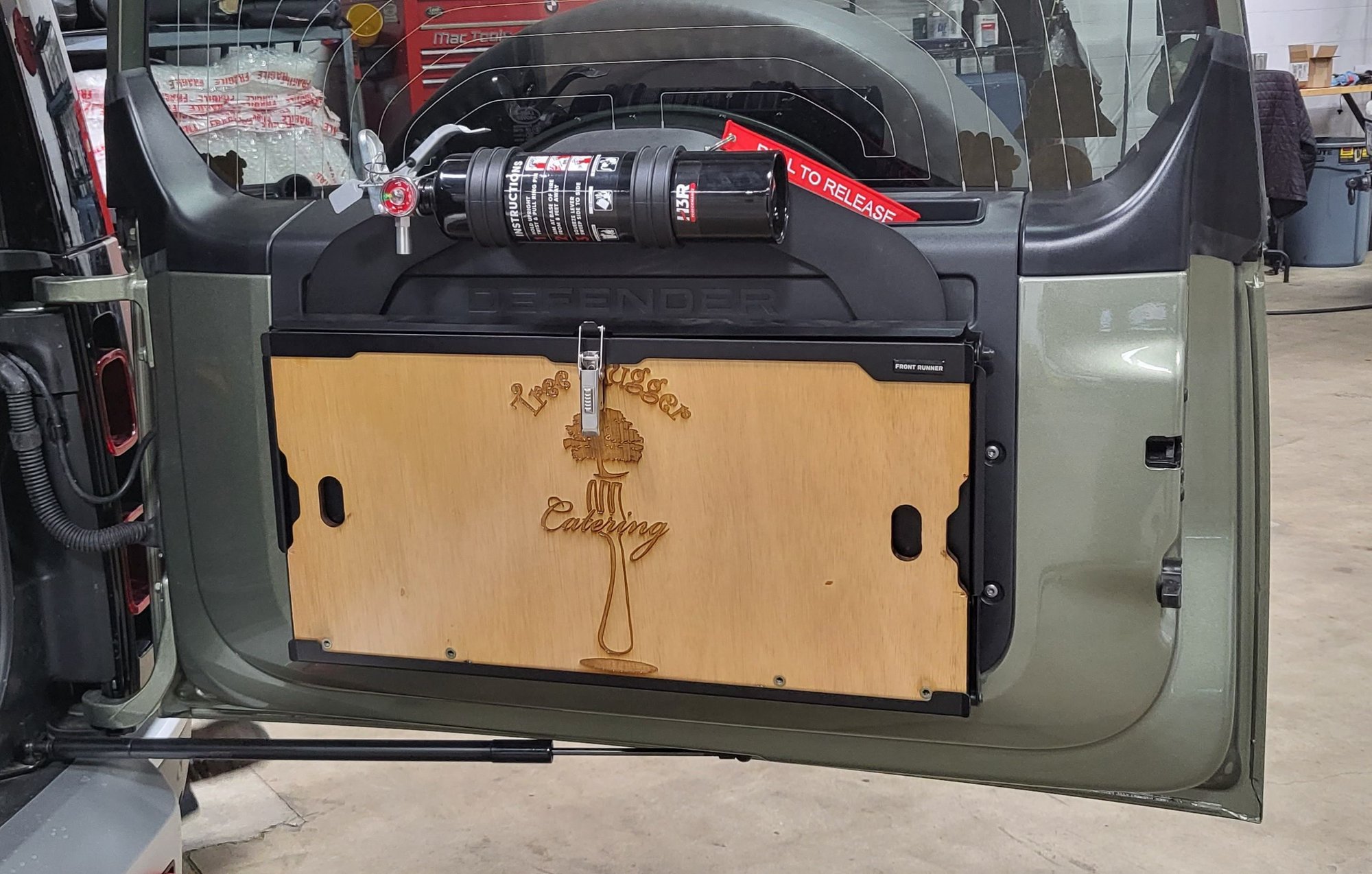

we made a mount that works pretty well

Thanks, thats close to what I expected. I'll look for that.

@sarek - Any way to order one of those mounts? Not living in Richmond anymore makes it hard to swing by<g>.

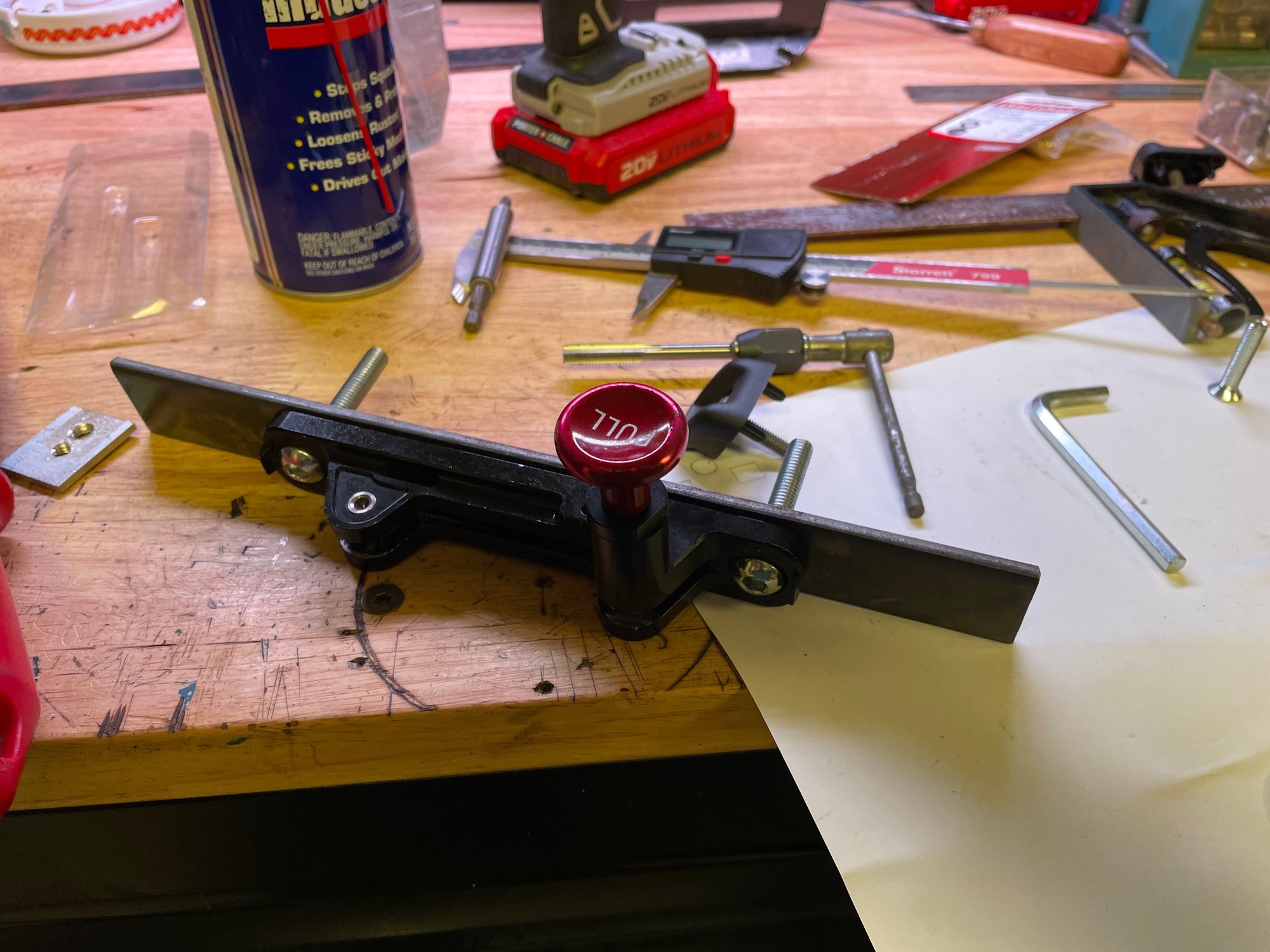

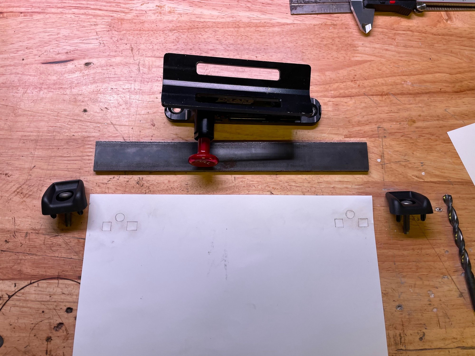

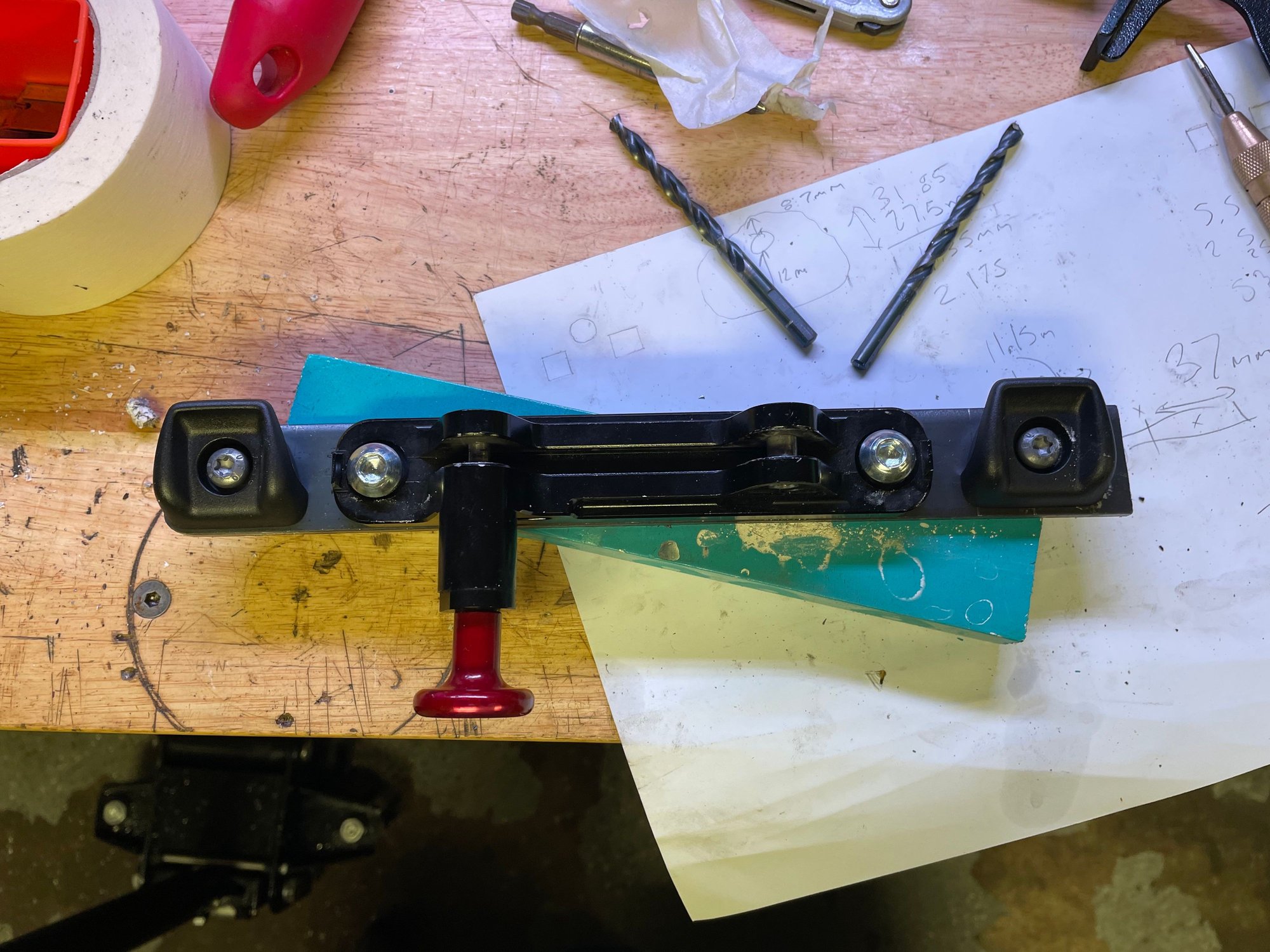

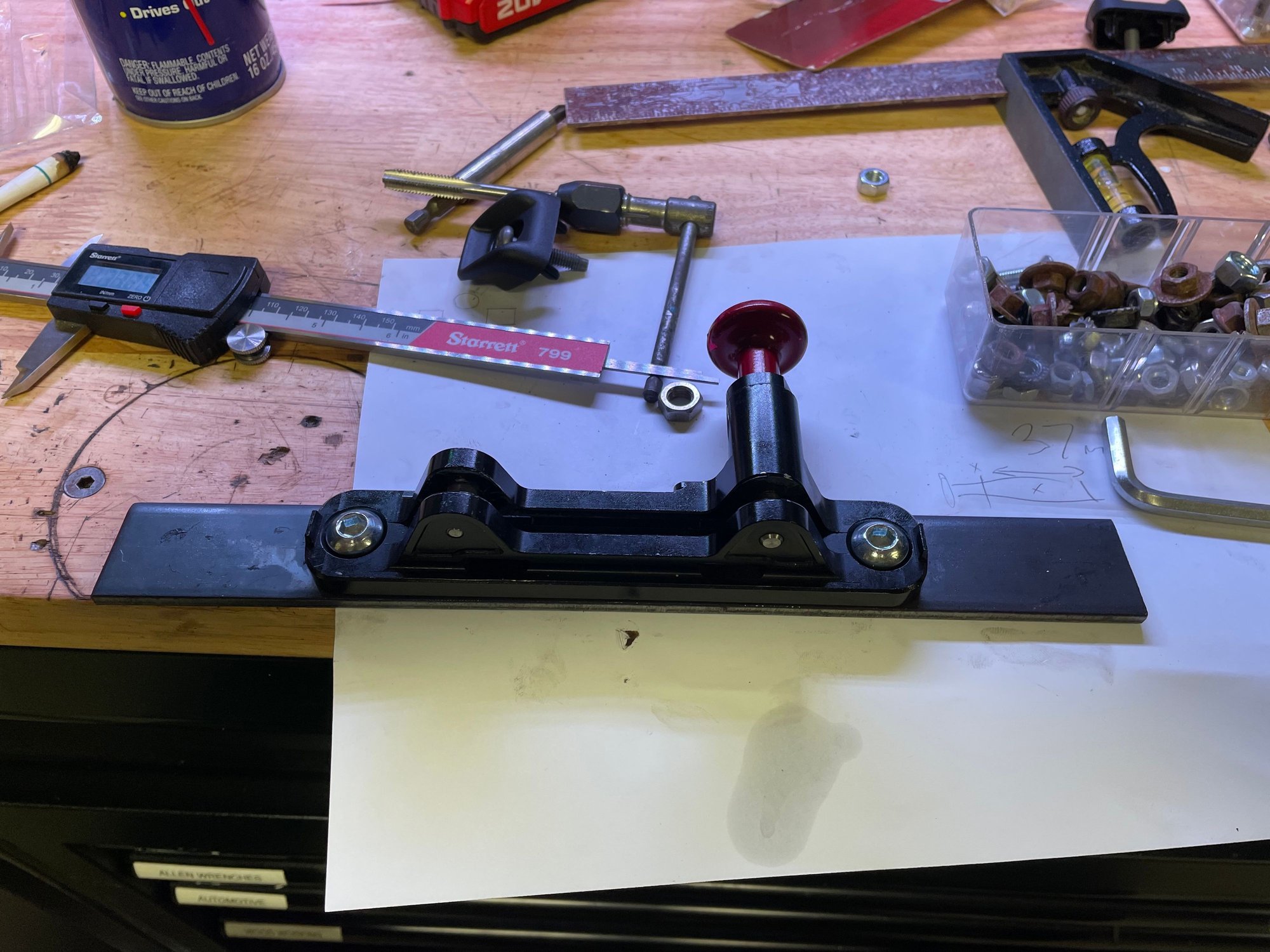

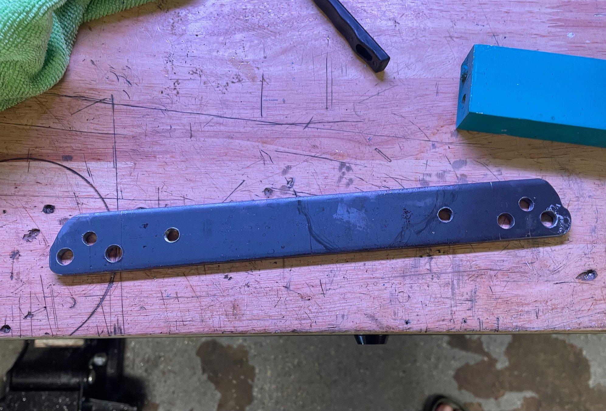

Made this mount for an old Drake fire extinguisher mount and some scrape metal for a 110, so it might not fit as well in a 90, but just an idea.

Just brilliant! Thanks for the idea. You now just outlined my next project. Where'd you get the bar stock or just had it on hand? What dimensions? Aluminum or steel? Thanks for the insights.
Old Aug 22, 2022 | 12:28 PM
Uno123's Avatar
Joined: Aug 2022
Likes: 9

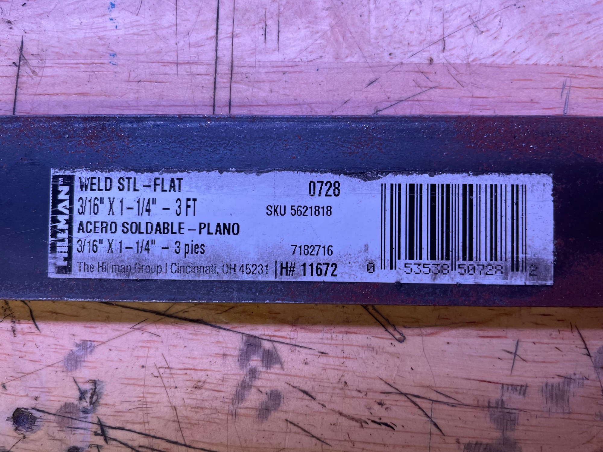

Thanks! I wish I had taken the time to make a template . I just had the (steel) bar stock laying around from another project. I think I got it from Home Depot (Specs attached).
The finished length was 10.5".
