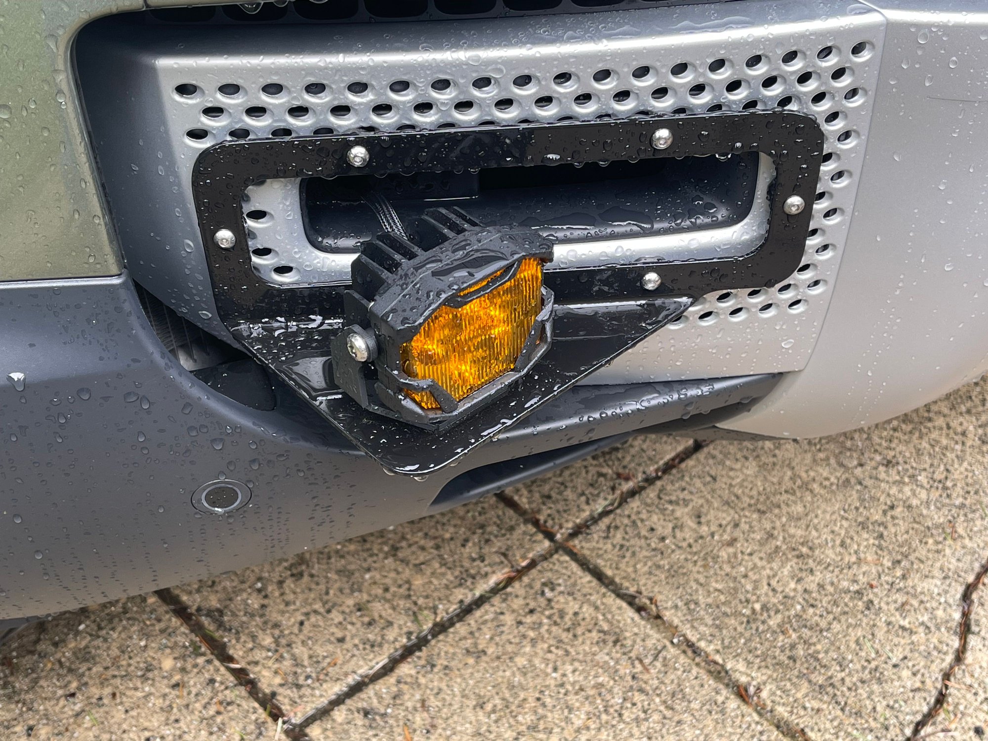

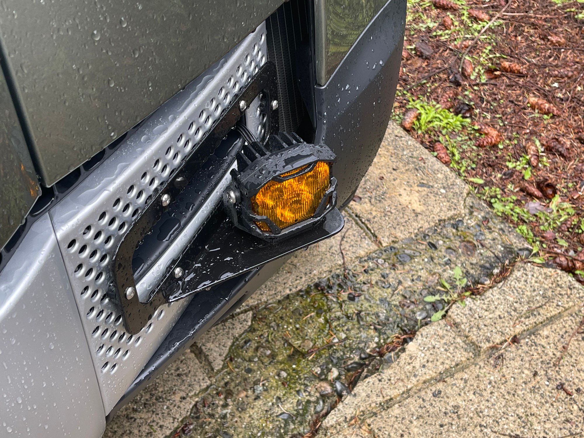

Back in the day all dedicated fog lamps were amber. In the early seventies I crossed Donner Pass in a Datsun 510 running on parking lights only because it was all I had that didn’t reflect light back into my eyes. This is what I’m currently running. Might be overkill for you but I’ve needed them on a couple of runs up the Frazer and Skagit rivers.

Another vote for amber fog lamps for winter driving. I've got a set on my winter truck and they are superior to the headlights when driving in any kind of snow.
The "cooler" your light "temperature" is - the more it will reflect off the snow and thus cause issues with visibility. I'm honestly surprised that I've not seen an amber fog light replacement kit from someone like Diode Dynamics for the Defender.
