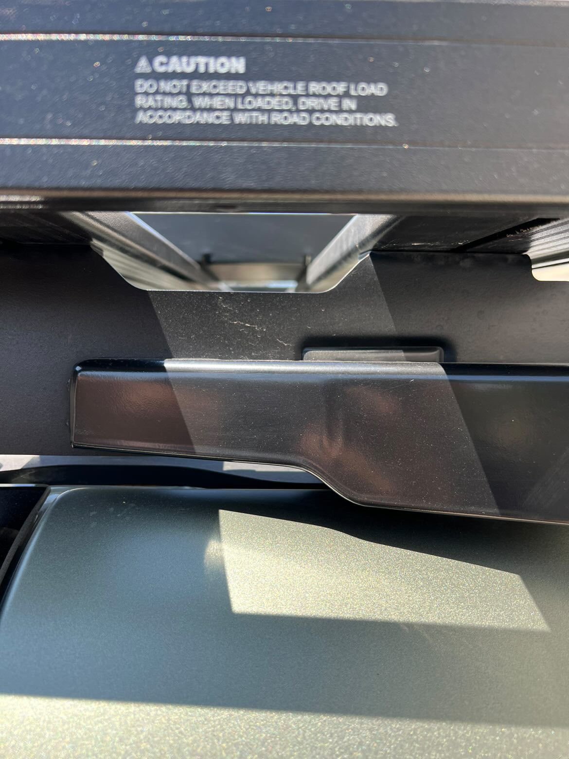

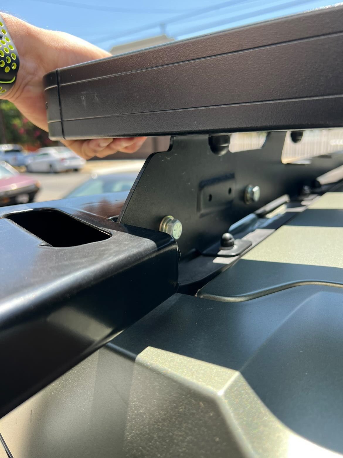

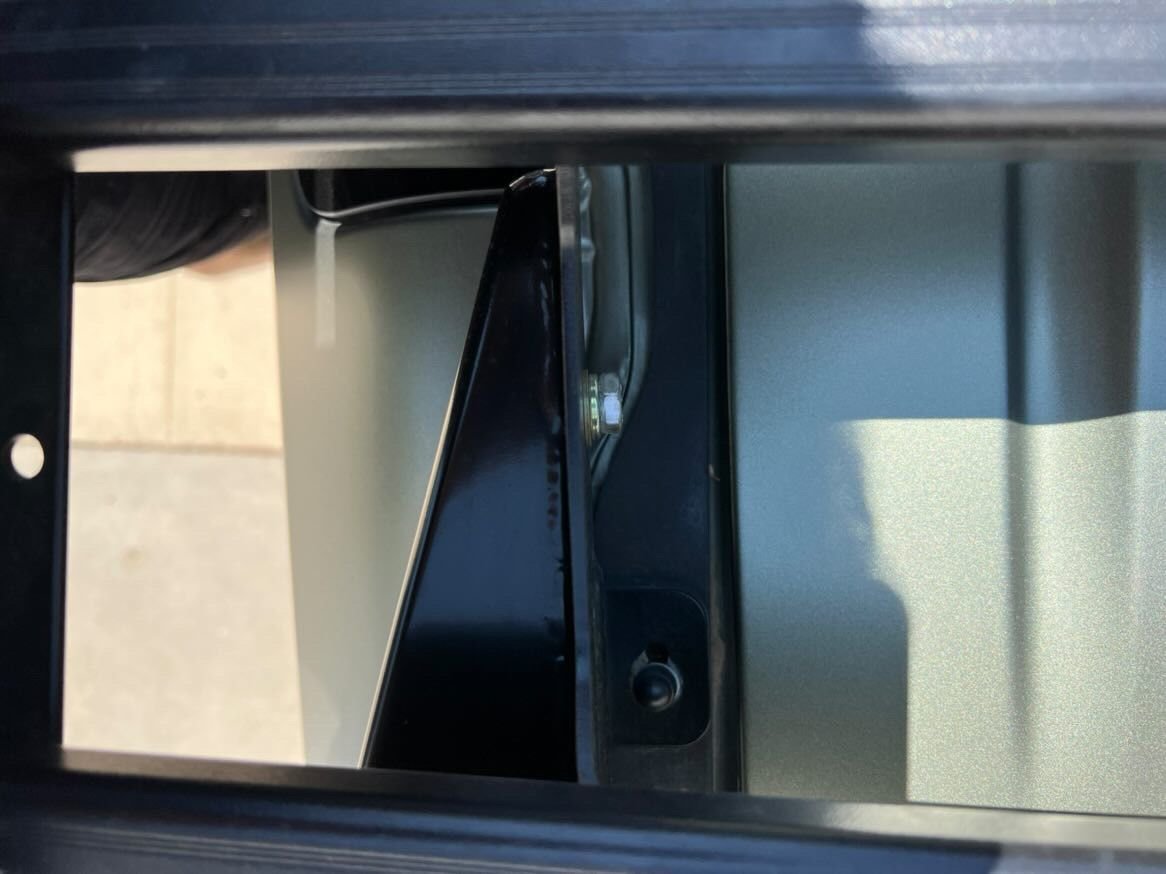

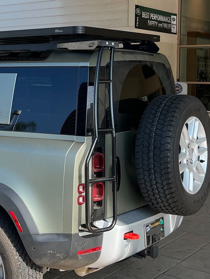

Here is what @ponder shared with me on how he installed the L8 ladder to the SLII. The work was performed at Galpin. I'll try to find the pics from that install.
"So what you get from L8 is more of a wedge / V at the top. And it slots into the OEM rails. No issues with OEM rack. What Galpin did was cut into it. Making it more L shape vs V. They then powder coated it to be weather resistant and put a few mounting points into the Front Runners rails as there were no holes."

Old Dec 8, 2022 | 04:32 PM

This is super helpful! THANK YOU!
This radk is installed without the roof rails by the look of the pictures. I am considering the SLII that utilizes the roof rails. I wonder if that would be an issue with the L8 ladder if I utilized the roof rails... Will need to look into the details of how the ladder mounts

My guess is that it would be a little easier given the height profile of the rack without the Front Runner rails is closer to OEM. Either way, find a metal worker local to you, and with some cutting and maybe welding, you'll be all set.
