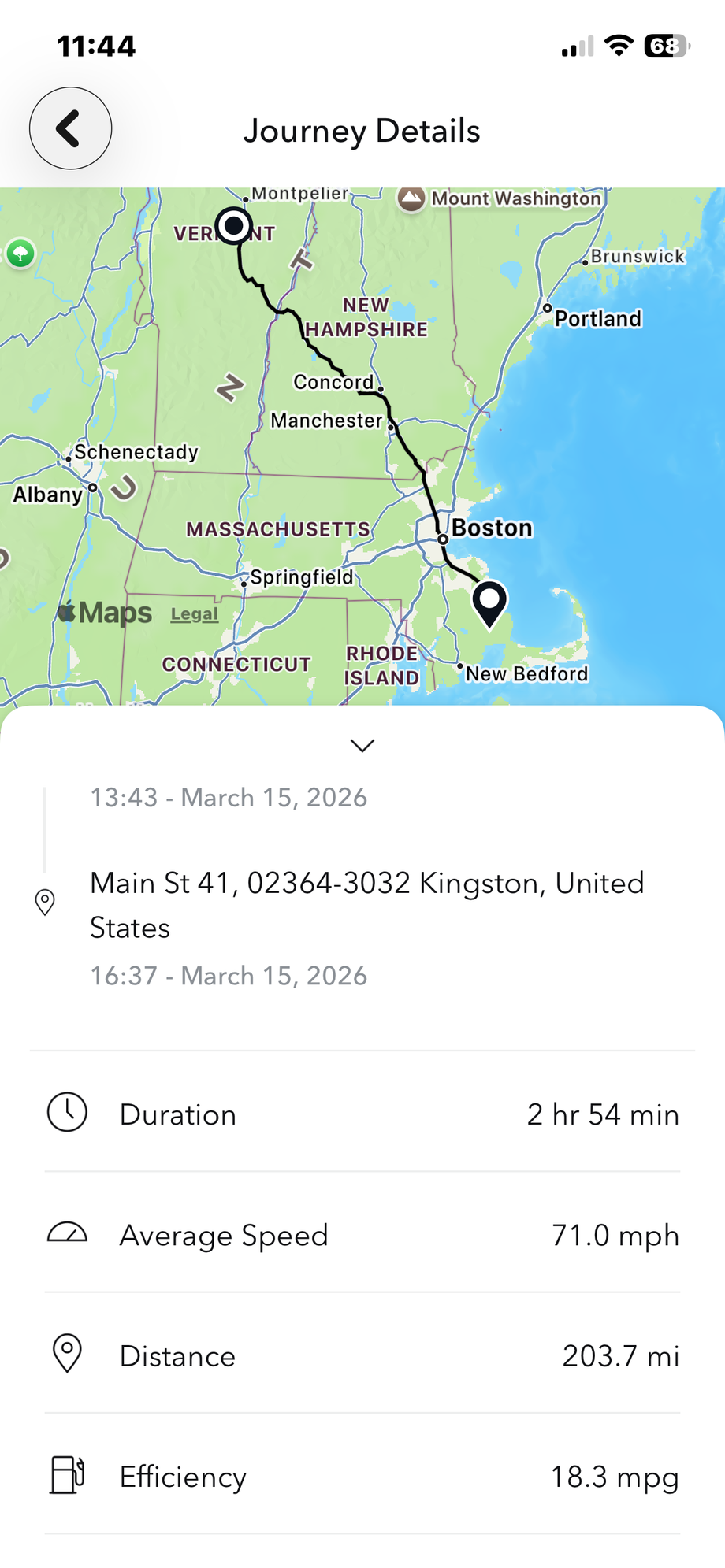

Just drove back from VT to Mass, Hakka snow tires on, speed ranged from 80+ mph to 50 mph in minor traffic in some spots and got 18.3 mpg - I have ski racks on, too. Going up to VT I got 18.4 mpg so pretty consistent. This includes some back roads and a trip over the Roxbury Gap... I also used the tire setting for heavy loads for higher tire pressures.
