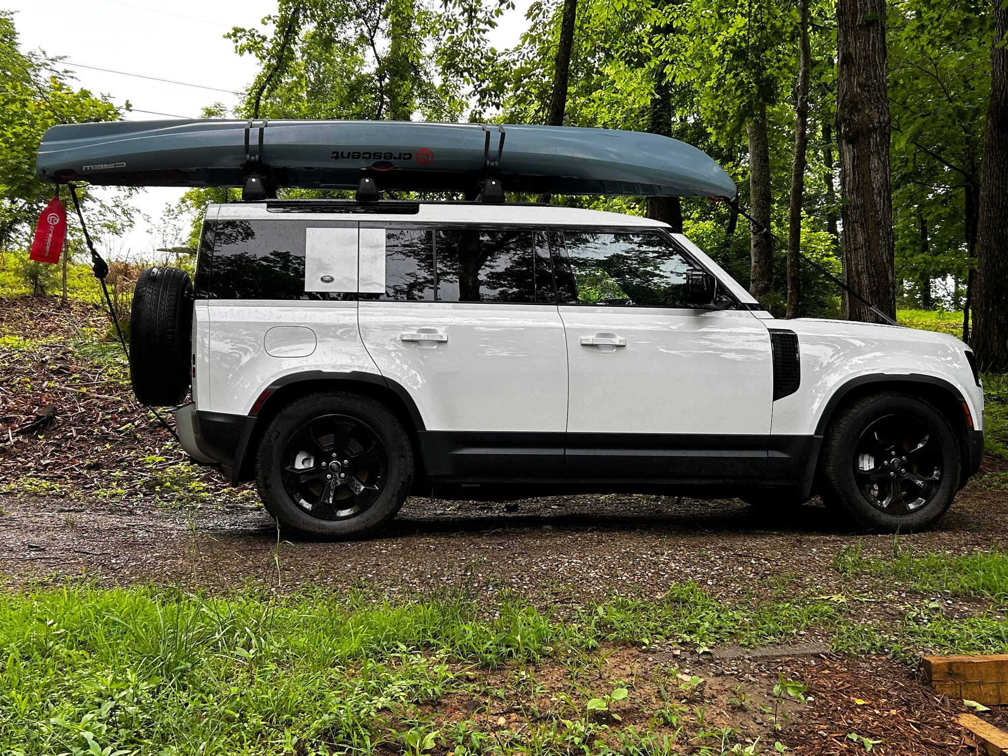

I don't have a picture from the front when loaded, the only one I have is in side profil (below). I put the part that goes under the hood slightly to the right or left of the latch and the bow line I use is webbing with the ability to cinch it down. It stays pretty tight and I have gotten zero movement. I will get a pic from the front next time I load it up. the micro fiber cloth is key to keeping the paint from getting damaged. For reference my boat is a 13ft fishing kayak and I added a third crossbar for support.

Thanks and nice set-up. For the front strap, do you use one in the middle (ish) or two in a "V" formation? I tried the "V" and they side enough that the stress point weakens. Thanks again. This is helpful.

Thanks! I use a single strap in the front and rear. I imagine if you used two in order to create a "V" formation they would tend to want to slide towards the center and loosen up. One in line in front and one line in the rear keeps the tension lined up and keeps the straps from sliding around. The set up pictured above has been rock solid for me at speeds of 80mph.

Many thanks and I'm going to try that next week when I drive a Laser sailboat ~150 miles each way. I tried the "V" this week and it did exactly what you described: started nice and taut in the beginning and then started to slide (and loosen) as the trip evolved.

Keep us posted! I bet you will have much better luck with the single line.
