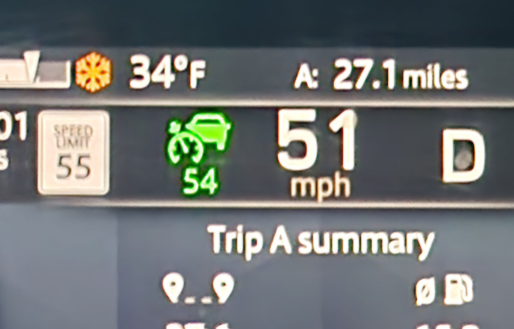

Currently no solution for speedometer calibration, however, the cruise control display can be calibrated. This is mine. My current gps speed is 54mph. I run 35 inch tires. So at least ehen you set the cruise it is accurate. This involved ccf editing and a bit of additional calibration compared to the normal edits. It is a nice option compared to the alternative.
