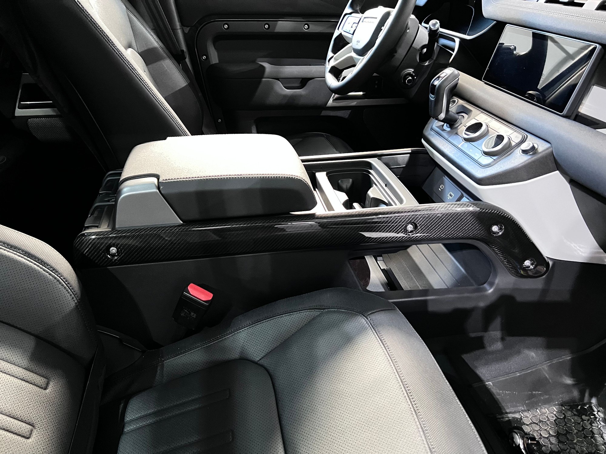

While not everyone’s preference, I’ve always been a fan of CF trim if tastefully done. Vulkan Auto in the UK sells an interior CF trim kit. I had it dumbed down though as the way they currently have the kit packaged is just over the top (in my opinion) for a Defender. Adding the gear shift surround and steering wheel trim is just too much CF trim. So I asked if they’d be wiling to package just the door pulls and ‘hockey sticks’ which they kindly agreed to.
The end result is quite good in my opinion. Not over the top, and blends in so much better. Fit is OEM - these aren’t stickers, they’re full pieces that replace what’s existing. Quality was a 8-9/10 - some faint scratches in the clear coat out of the box, but I can live with it as they’ll get banged up from day-to-day use anyway.
Install is 5 seconds for the door pulls, and a bit more involved for the hockey sticks. Expect some scratches on the backs of your hands if you leave the seats installed.

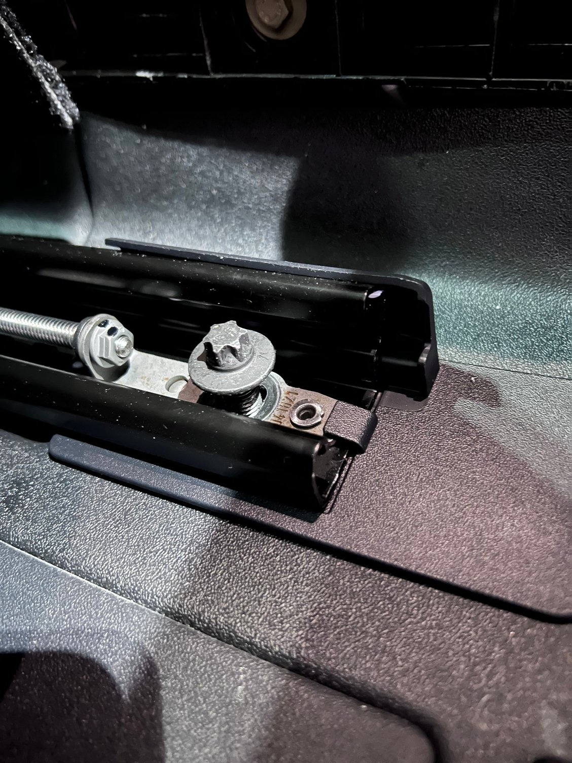

To get the centre console panels out without breaking clips, use an E14 torx socket to loosen both inner seat bolts (from/rear) so the entire seat assembly can be tilted away from the centre console. The bolts don’t need to be fully removed, just backed off to give some play in the seat. That’ll give enough room to get the panels out, and then the trim pieces can be replaced outside the car.

I like it. I personally don’t like wood in the Defender and fortunately I could order without. As you say, those two trim pieces are all you need. Any more would be too much.
In the last photo you posted, did you forget to put the finisher washers back on???

Good eye! That was just a mock up checking fitment - all finishers in place.
