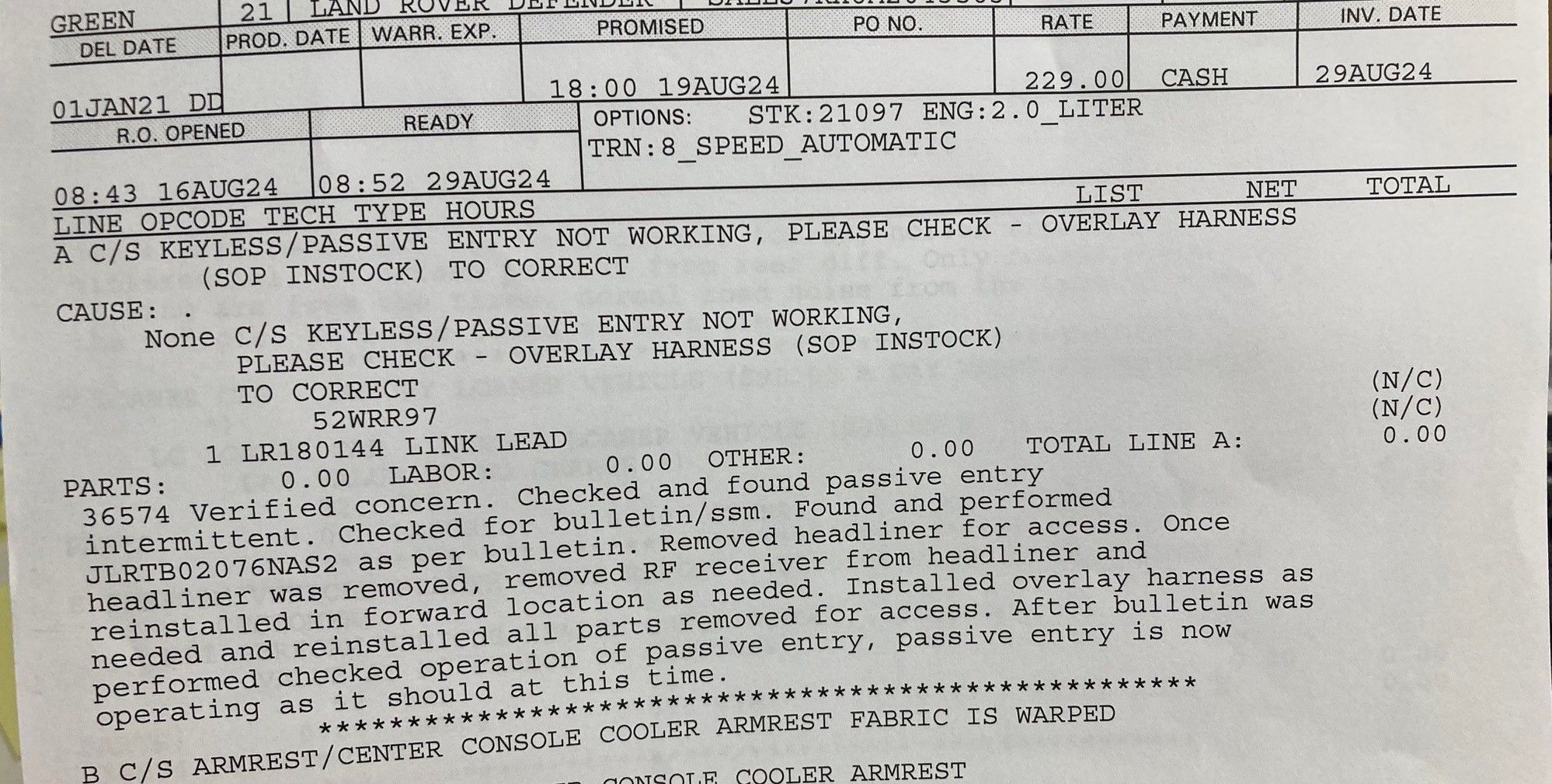

After two weeks of waiting on parts, I finally got my car back from having the keyless entry fixed. Per TSB # JLRTB02076NAS2, the headliner was dropped, the RF receiver was moved from the back to the front driver's side of the headliner and the overlay harness was installed. Keyless entry now works as it should. Hope this helps anyone who also has this problem!

Just had this TSB done on mine as well.
Dealer had the overlay harness part quickly from JLR parts, and took 2 days. Dealer was familiar with it and said they'd done another one recently as well.
I've only been on a few drives since, but... all seems to be working 100% now. Very glad I did it prior to warranty expiration. I'd recommend anyone with an early build Defender under warranty still to have a look into this.
