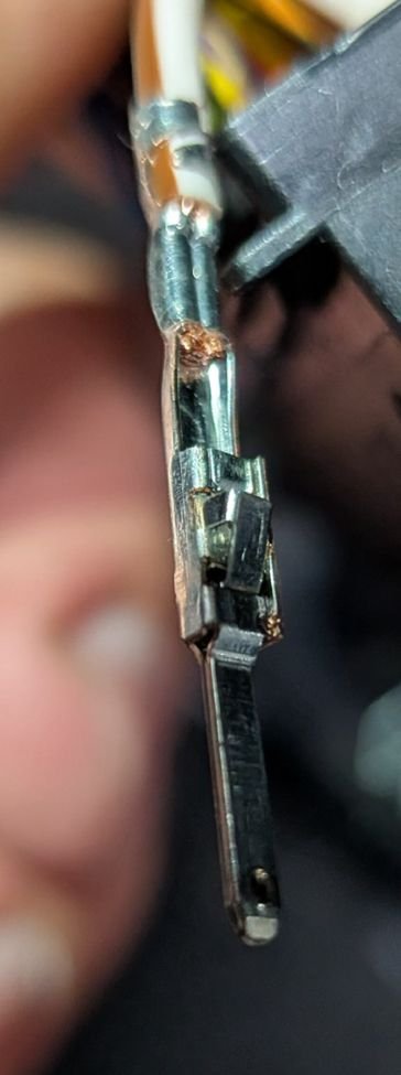

i am upgrading my base audio system on a L663.
my car does not have any mid bass or a base subwoofer under the passenger seat.
first thing I noticed was the front doors do have the wiring for mid bass, however the wiring loom from car to the door is missing the male connectors. So I have added some wiring and plan to add this to the male connectors for where the pins are missing for the mid bass.
you can see form the picture of connector on the far right (3 down) , where there is a empty mid bass cavity.
however I am having trouble sourcing the pin shown in picture 1. Please could someone help me to identify the part number or a somewhere I can buy this pin in the UK, or even the Europe ?

Hi Garry,
unfortunately that type of pin is not sold as a spare part, I have not been able to find anything similar.
I upgraded from a basic system to a meridian surround system, so I also had to insert the two mids into the front ports.
I solved the problem by buying a used range rover connector, then with patience I extracted the pins I needed.
https://ovoko.it/parte/baz22060-2141...o-di-cablaggio
Cheers
Marco
