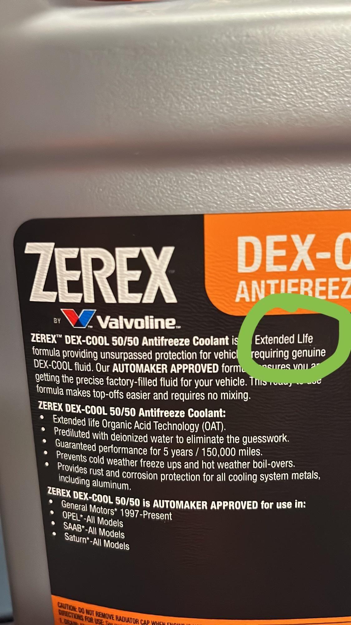

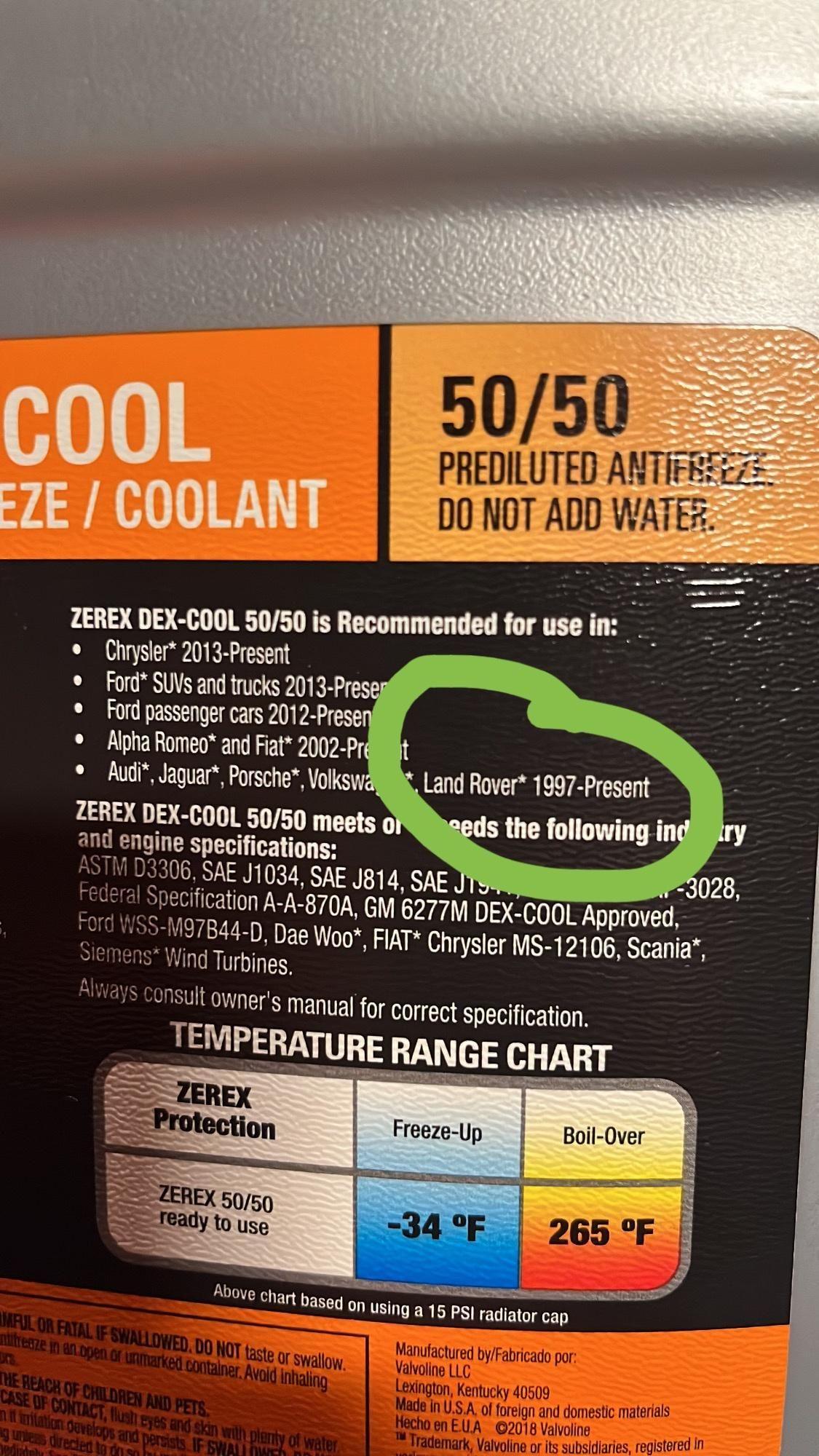

I had gathered that Xerex is an extended life, is orange, and is OAT, but couldn't find that STJLR spec anywhere on their bottle or website. I also get what someone said above about market agreements for Havoline XLC; just like it's printed on the engine bay that Castrol Edge Professional is recommended (and in the iGuide). So maybe I'm OCD.
