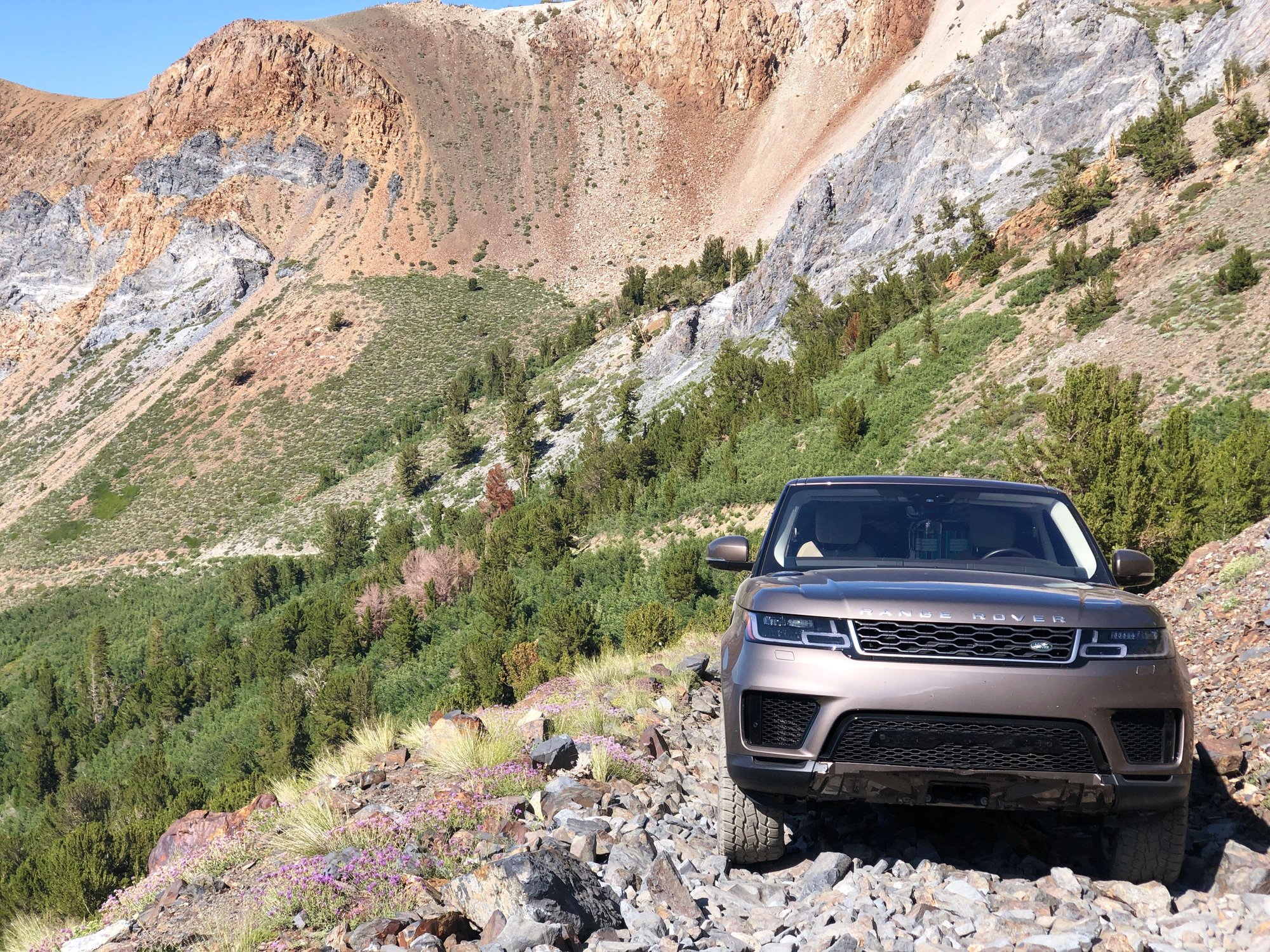

I have even done it in a Range Rover Sport with no lockers and terrain response only!

My sport made it, your defender will too

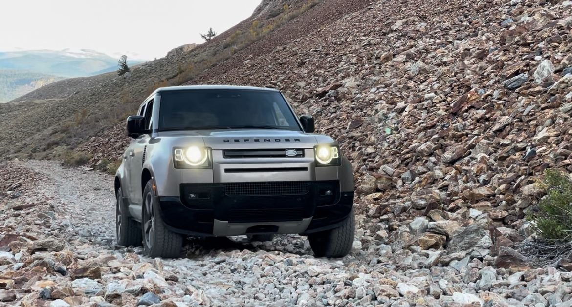

Defender when it was still on Goodyear Wrangler doing the trail.

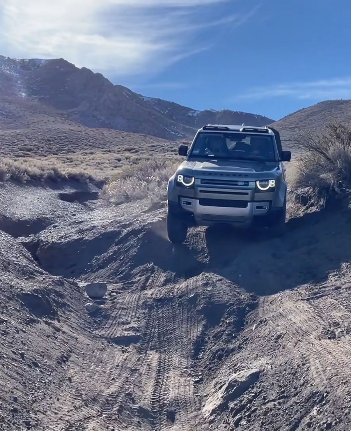

Deep ruts that year but the D110 made it just the same.

the initial hill climb will be the most challenging section, with rocks and some years deep ruts, and there is also a nasty final switchback that requires a 3 point turn on sharp rocks. on the return trip, there is a steep initial hill with a lot of sharp rocks as well. Gravity will then be on your side on the journey home.
