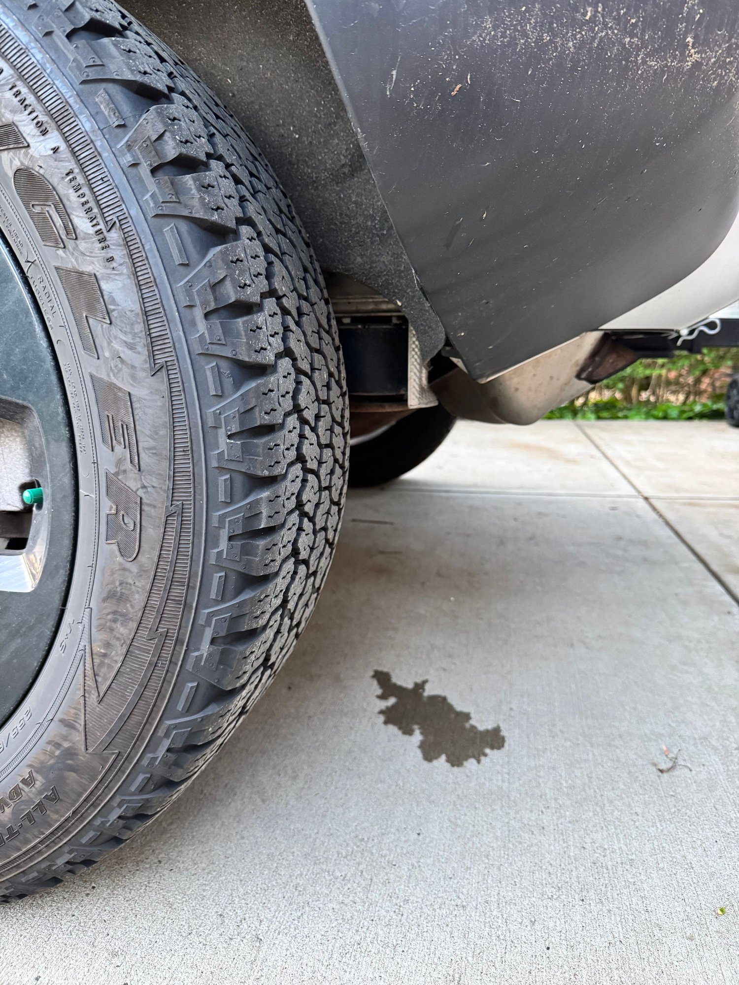

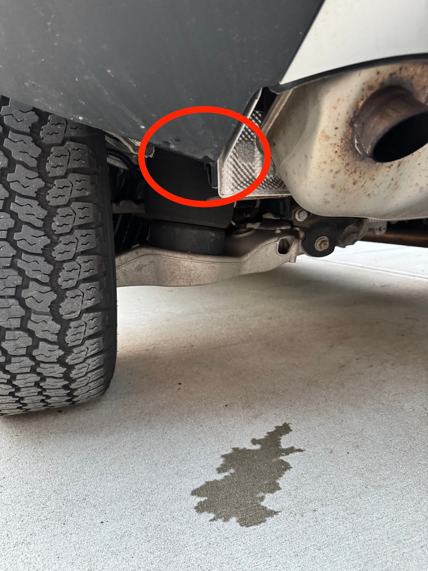

Hey all. I only have a few months left on my warranty. Wondering if this is anything that I’ll need to get taken care of before it does end. it is now the end of the day and it hasn’t rain all day. But I’m seeing some liquid - I can’t tell what it is. No color or smell. The car was driven earlier in the day but only noticed this now. I indicated in the picture where it’s coming from but can’t tell any further… is the line for the rear window washer fluid in that area… if not, any ideas? Thanks.

Water from past rains can sit in little crevices and seep out over time. If there is no smell or color, it would most likely be water. Rub your fingers in it. Is it slippery? Most auto fluids will have an odor, and all will have some color. There are no clear, odorless fluids in a vehicle. There clearest would be brake fluid to an extent, if it is new, but it would be slippery. Washer fluid would be bluish and have a slight odor. If you’re still worried, take it to the dealer claiming there is a leak and let them put it on the lift to give it a once over for peace of mind.

Do you have the rear cooling assist? Likely the condensate from the rear cooling assist a/c evaporator.

Mine does the same, brand new. No rear AC unit. My best guess is rain/moisture getting into door jam and working its way down.
