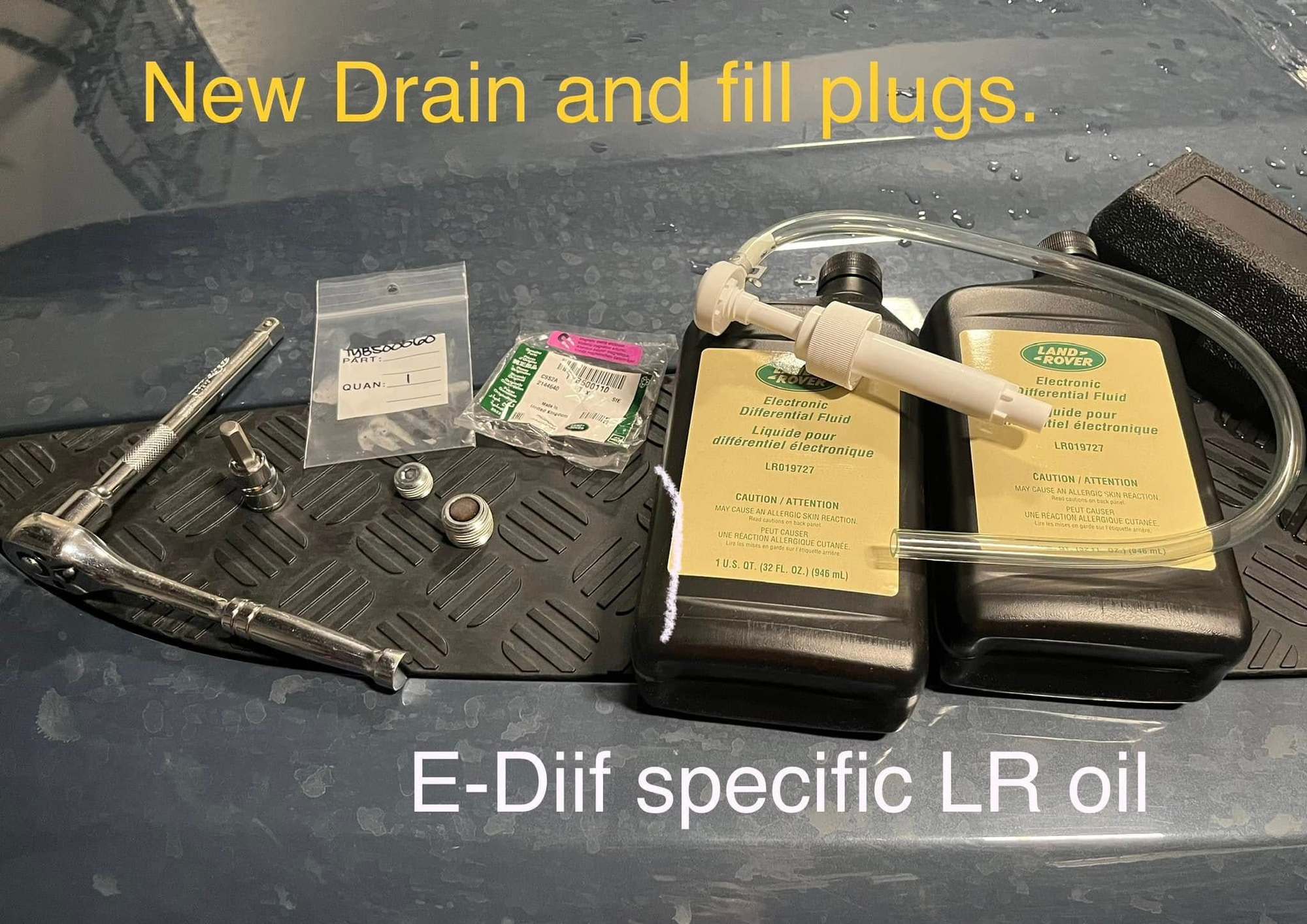

One more theory.
I'd look at the rear e-diff. Downshifting might cause a sudden partial engagement of the rear e-locker with the associated clunk from the clutch packs. Repeat the process with the locker visible on your screen. I'm going to bet there is a correlation.
Clunky rear e-diff is a common issue and one that's rectified easily enough if you get to it in time.
