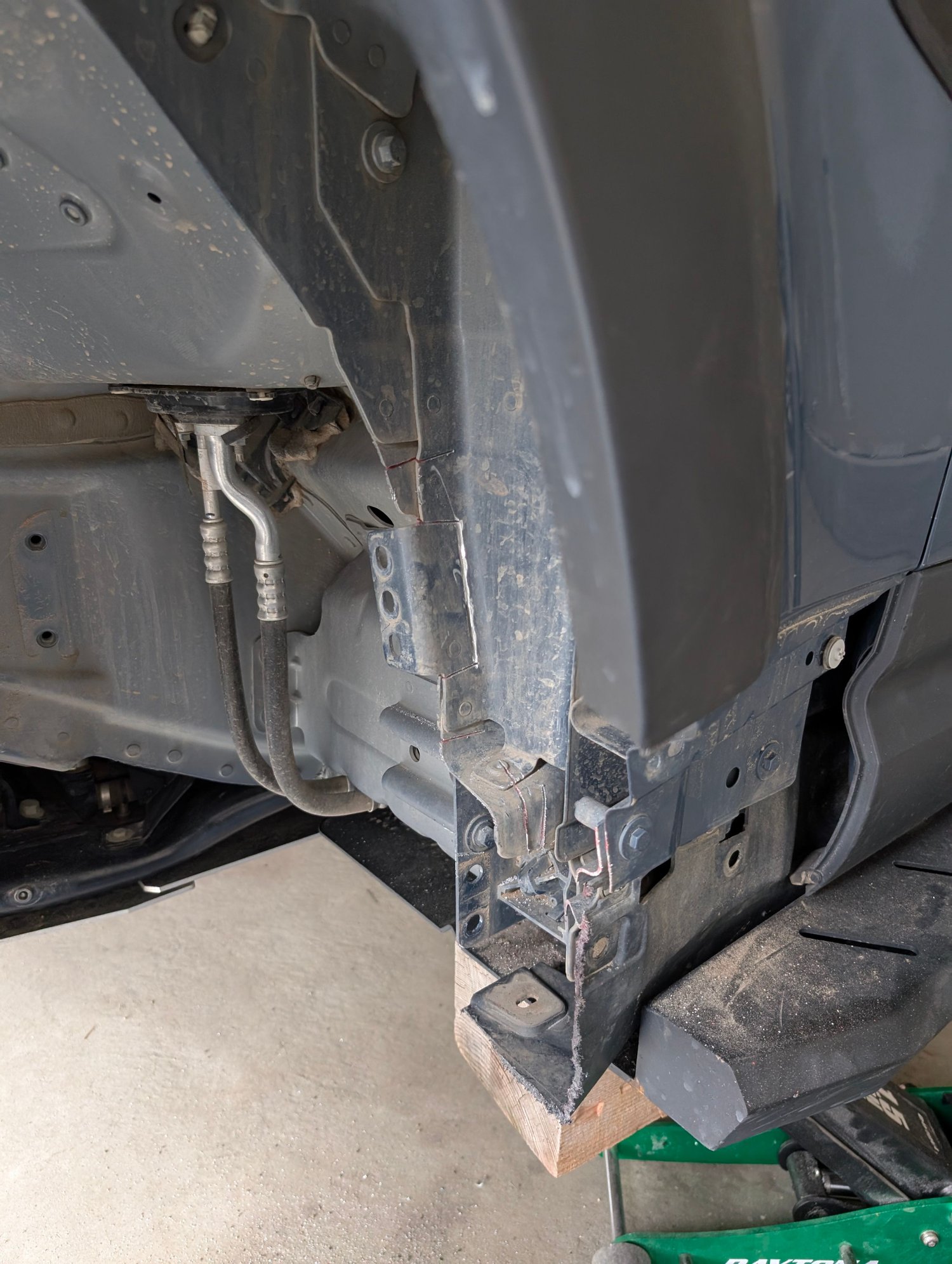

I have not had a chance to test it out in high yet. In normal height I have not noticed any big difference, though I am not I am very in tune with that. I have noticed that when cornering the car pitches more to the outside. I am planning to get 35s in the next week and then go for a test ride. I spent last weekend removing the pinch weld in the back of the front wheel well.
Pinch weld before removal.  Lucky8 and Saltek both have videos on how and what to trim. It is a little difficult to get a sawzall in there. I used a combo of sawzall and dremel with cutoff wheel.
A picture of the liner back in after removal of the pinch weld. Need to figure out a way cover the gap so debris doesn't build up
