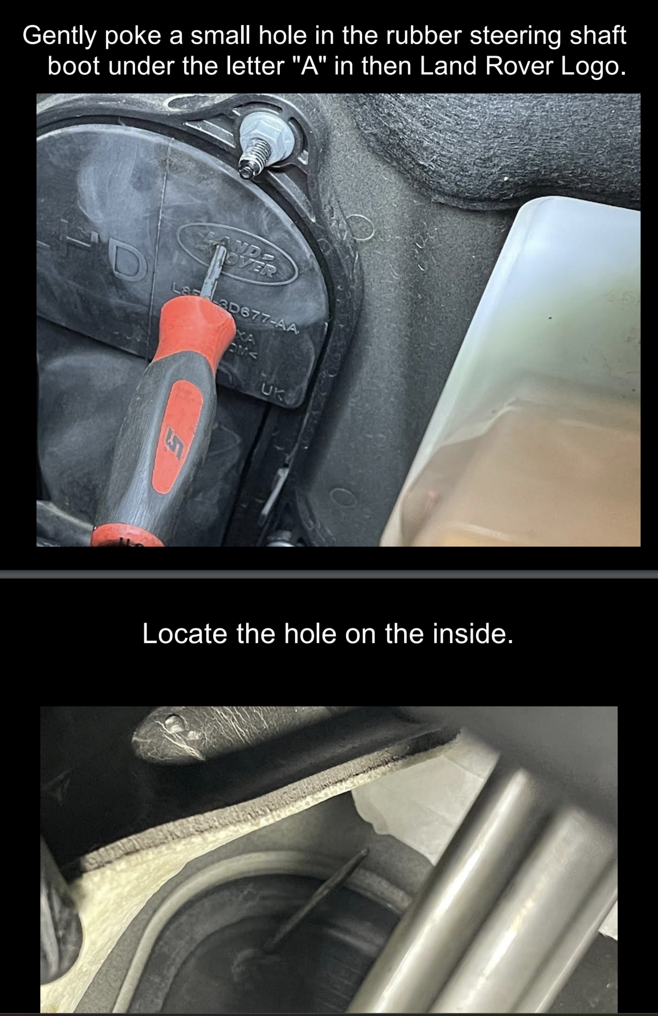

I recently email Joshua Lewis at Lazer Lamps asking about a passive canbus reader for their "canny" as it's in a waterproof case, so can be installed in the engine bay. Vs in the cabin and passing the highbeam trigger through the firewall. I really don't want to put a hole in that boot. He mentioned there was a dedicated canbus to the lights that you can tap into.

Counterpoint:
Just put a hole in that boot. Right where it says Land Rover. It is a thick rubber boot but it’s easy to pierce , and it will not rip if you do it properly. You can use a very small dental pick type of tool -- or straight point probe -heat it up - go right through.
I put my GMRS antenna wire through there, no issues. You wil have no water ingress. I put a bit of black sealant around my antenna wire once I had it in there and it was in place.. You are in no way compromising your cabin integrity, introducing noise or water to the cabin.
I can assure you I am the biggest purist out there and have seen all kinds of hack jobs putting wiring in the cabins on Land Rovers and this is not a hack job. It’s actually very clean and good. Almost as if LR intended this -- You should see what people have done on D2’s, P38’s, LR3’s, Etc that I have bought in the past to run wires... total hack jobs that over time leak, etc. This is a very good solution.

Agree with @nashvegas . Lucky8 sells great products and does a lot for the Land Rover community. Here's the instructions to their light bar installation: Link. Pages 19 - 24 show you where to go. Here's a screen shot of where to do it. I just used an awl that I had in my tool box. I only did it once for my GMRS line and have NEVER had issues with it. No water ingress EVER. That boot is THICK. It's tough to pierce and I put some silicon caulk on the inside & outside, but I doubt if it's ever needed.
