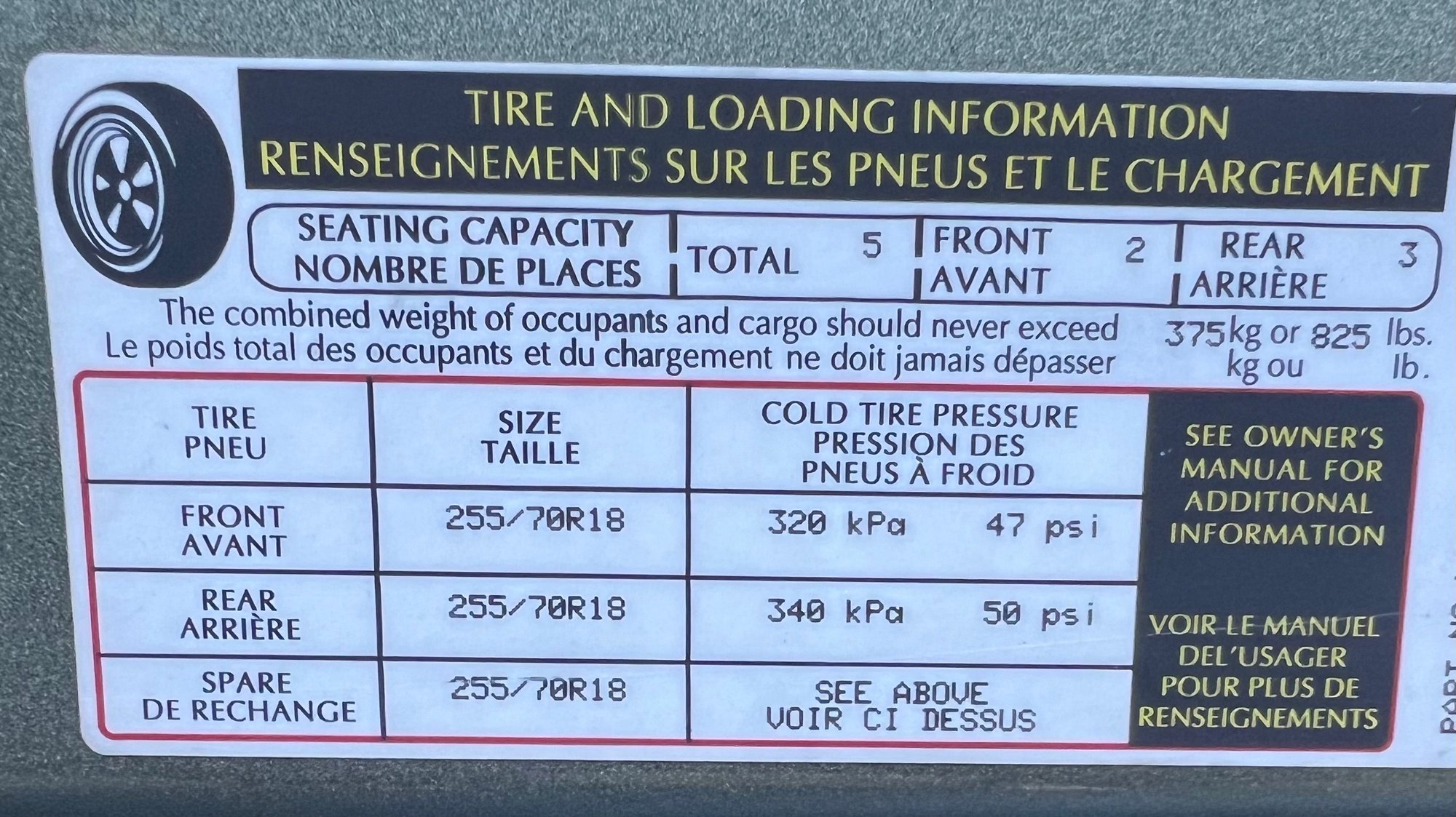

I have a 2023 P300 110S. Here's the sticker on the door frame.
"The combined weight of occupants and cargo should never exceed ... 825 pounds."
That's not a lot. Four full sized men will hit that pretty quickly, not including any luggage or anything heavy bolted onto the truck such as sliders, a winch, etc.

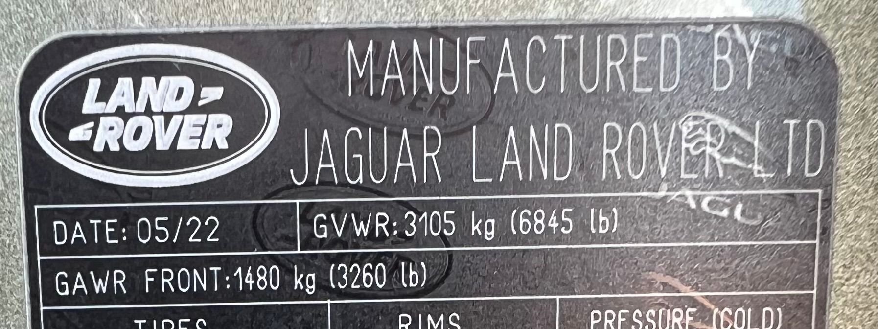

P300 110S gross vehicle weight: 6,845 (from the LR website)
That's a difference of 2,030.
So... what gives? Why is the max occupants and cargo weight less than half of the difference between curb weight and GVWR? It's not just the weight of a trailer on the tow bar - that's limited to 771 pounds (also LR website), so there's still a significant difference.

My 2023 110S has a GVWR of 6845 lbs.

The weight on the sticker is based on the number of seats (75 kg per seat), as mentioned in one of my posts.

I believe you on the 75kg per seat. It just seems so arbitrary and overconservative. I wonder if a 110 with the rear jump seats shows 525kg (1,155 lbs) vs the 375kg my five-seater shows.
