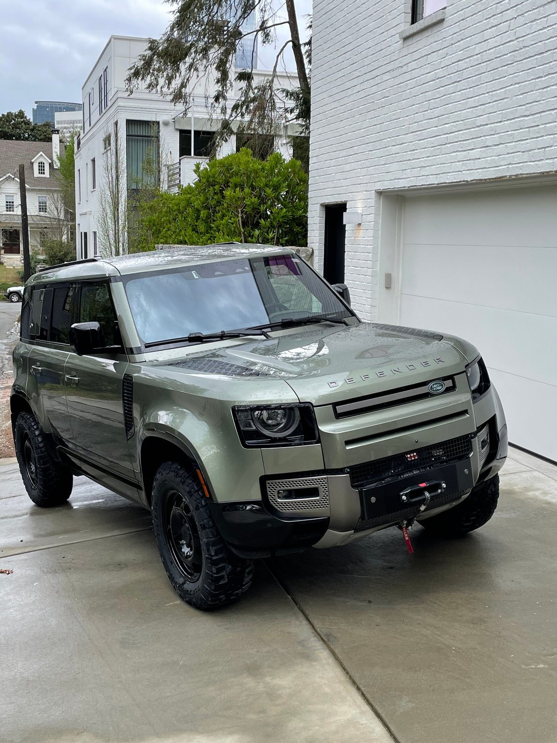

Very happy with my stock size (255) Cooper Discoverer RT (Rugged Trek) on OEM steelies. And my use case is EXACTLY like yours. (And I think you mean Castle Valley, Utah, no? Fisher Towers, Onion Creek?) I live in Atlanta and go to SW Colorado and/or SE Utah every year for 2-3 weeks. Did it in a Wranger 2-door softtop for 5 years till I just couldn’t take it anymore, hence the Defender. For the exact reason you mentioned — lotta highway between me and Poison Spider Mesa.
I’ve only been once so far on the Discoverers, to the San Juans for 2 weeks last August. The road noise is slightly greater than the stock Goodyears, but far from annoying. The performance in the “nothing but sharp 4” diameter rocks” old mining roads around Ouray and Telluride was perfect. No complaints. When I got back home I put the 20s back on, then went to 18s for most of the winter. We don’t get any weather in Atlanta but I just loved the look and wanted to feel manly for awhile. Just swapped the 20s back on before a trip to the beach, and I’ll probably leave them till my next trip out west.

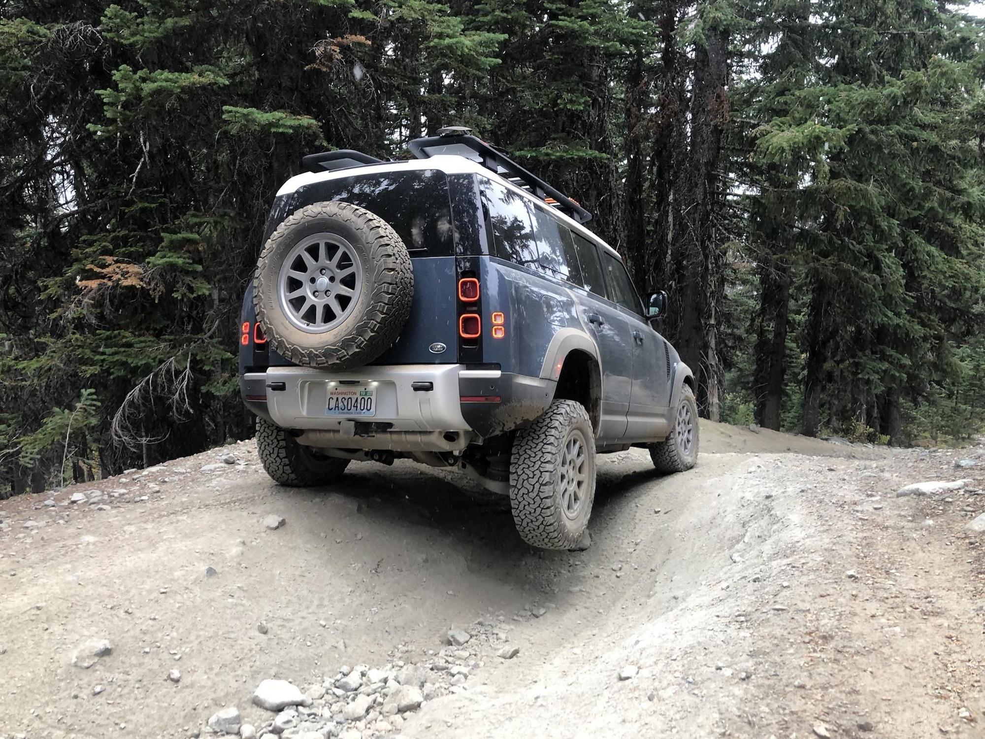

Good call on keeping the 20"s for winters. 18" rims on my P400 have been a game changer. Best mod I've done. Much more fun to be had with them.
I put 265/70 R18 KO2s on my Tuffants and they are no good on hard pack snow. Took my Blizzaks off days prior to us getting a fantastic weekend of snow this past weekend in the mountains. Always works that way. First time all winter I've felt myself sliding.
They've been great on the trail and in deep snow and look pretty decent too I reckon.
