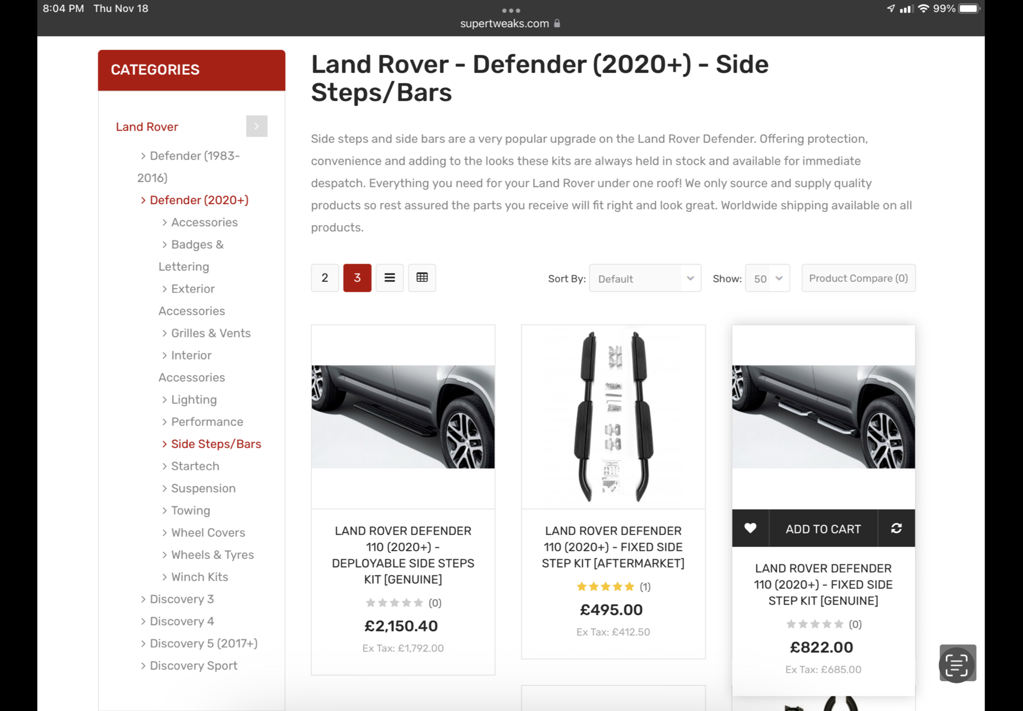

has anyone installed your own fixed side steps? any suggestion on aftermarket?? how difficult was installation etc
Thanks!!
