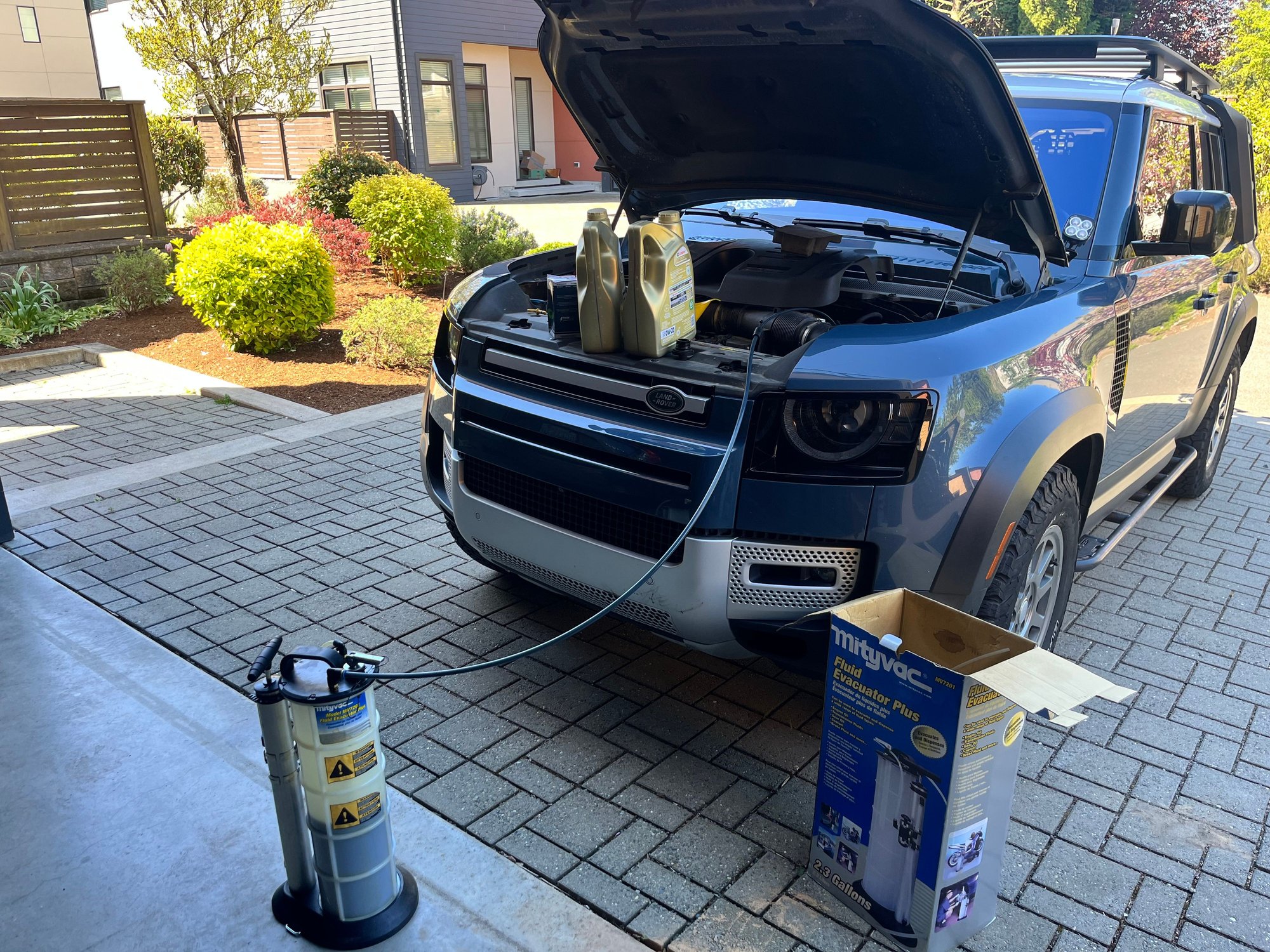

The first time I tried the MityVac some years back, I did briefly have the tube catch on something, but I was able to gently get it free. I was VERY careful about that this time around. I spent a bunch of time playing around with it today to see if I could unlock any "trick". Like I said, I marked the dipstick length (just to be sure - it ended up going in a bit further than that), tried all the way in, backed off a hair after it bottomed out, I tried various insertion angles in case a slight angle was the issue, and I played with the air suspension and a little bit of checking that it was level (it was on a very level surface). I even made sure the hose connections were air tight so I wasn't losing any vacuum. I don't think it's worth trying anything else. At least with my Defender, the vacuum method isn't going to work.
This is what I get when I try the "easy" way.
