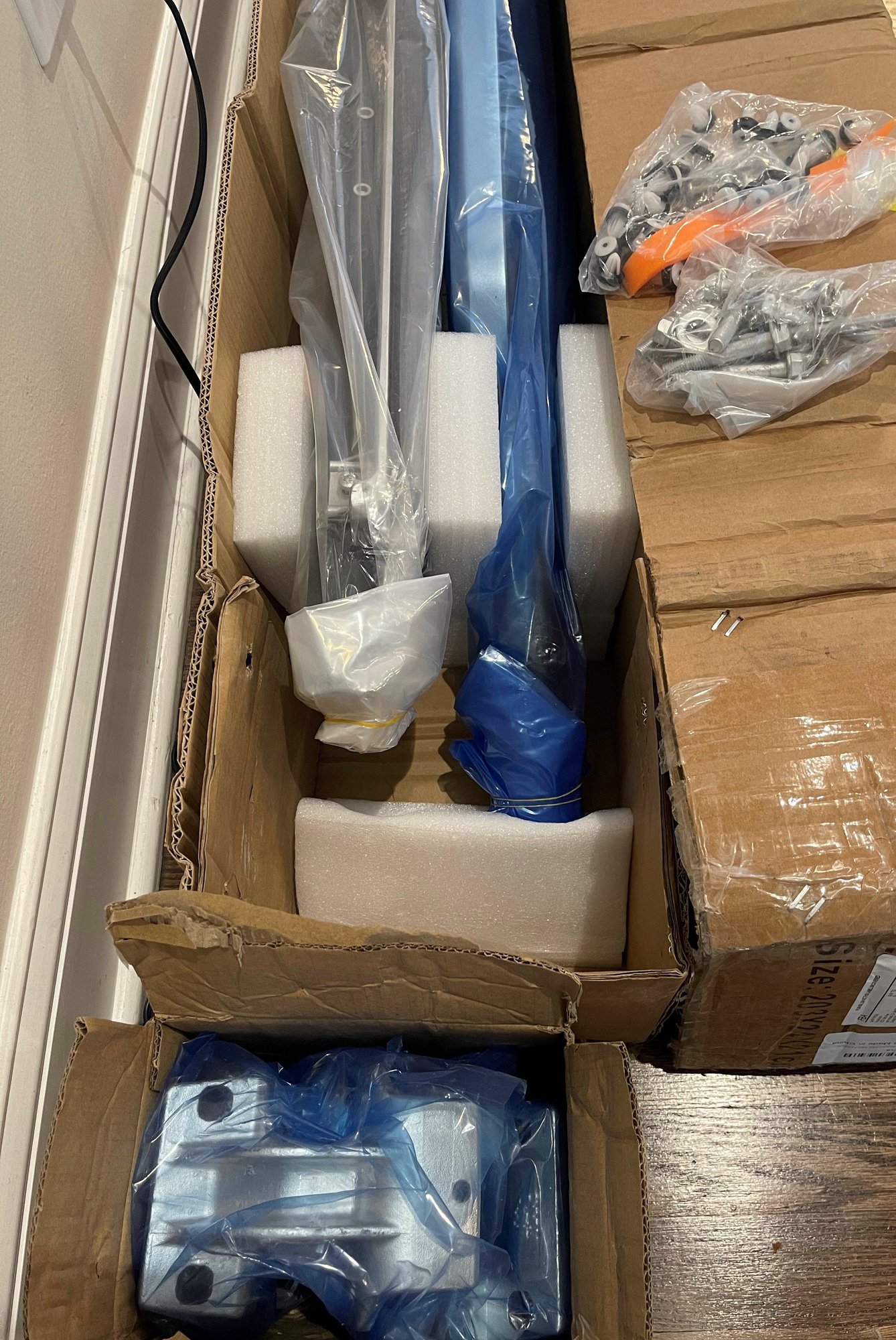

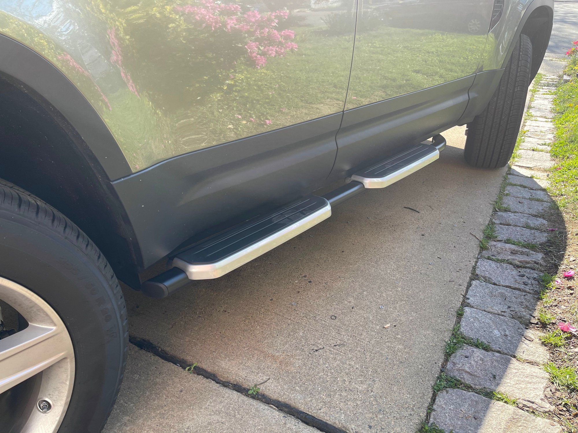

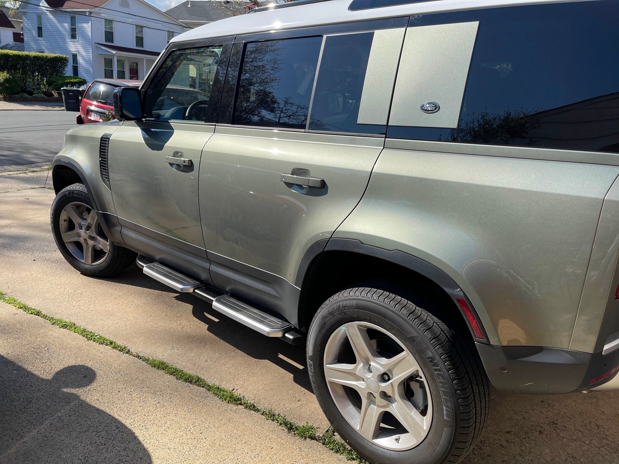

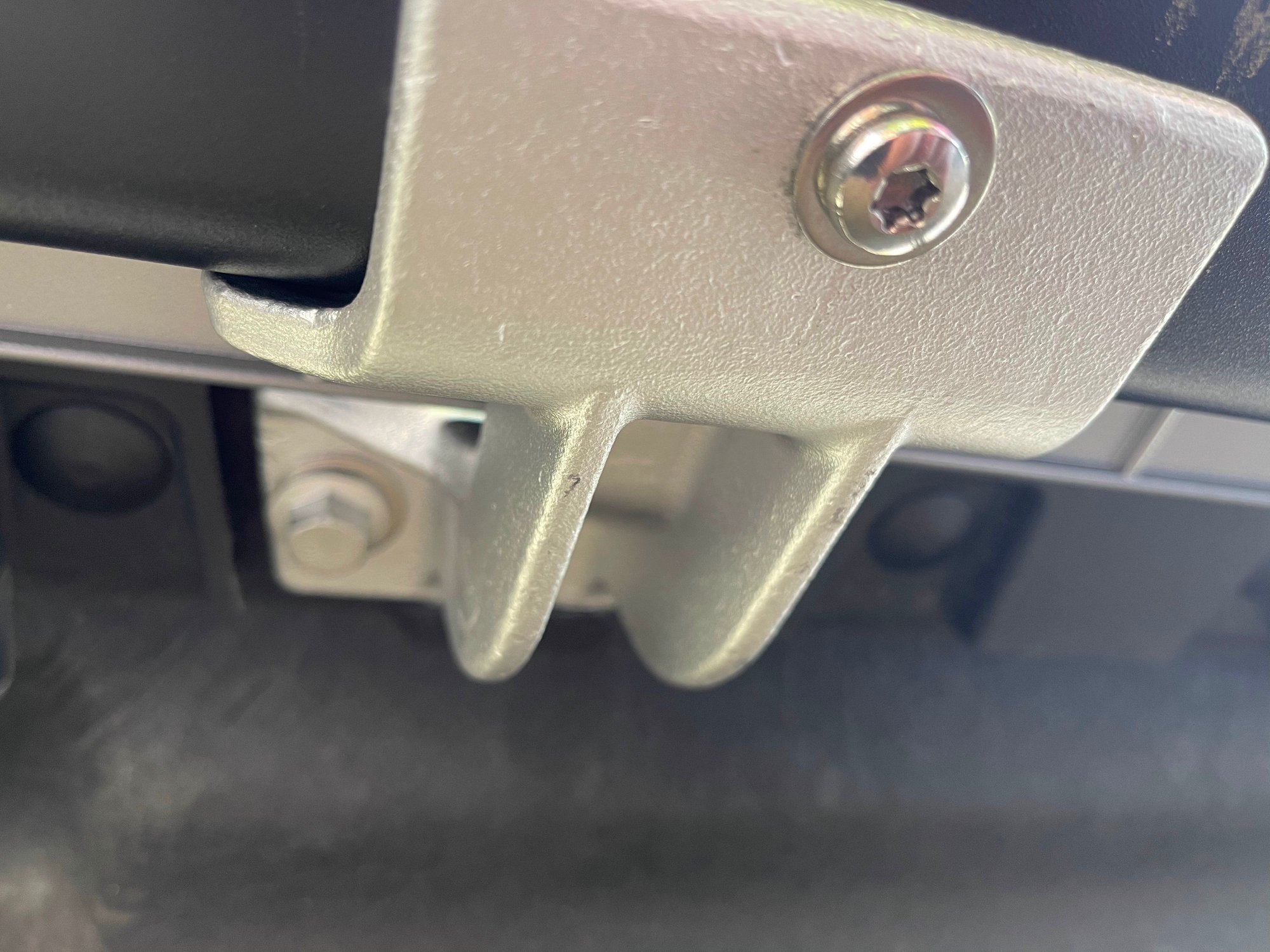

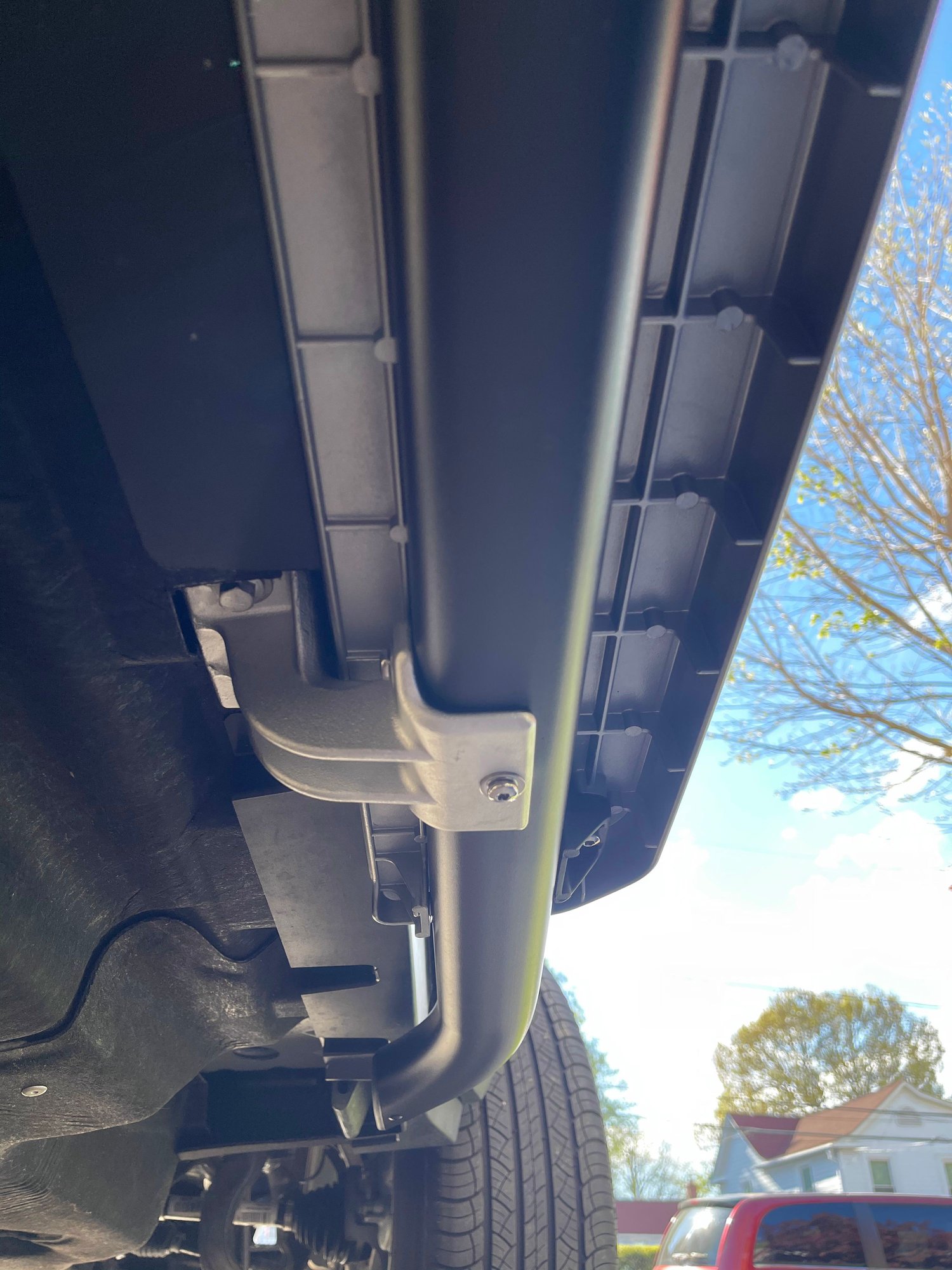

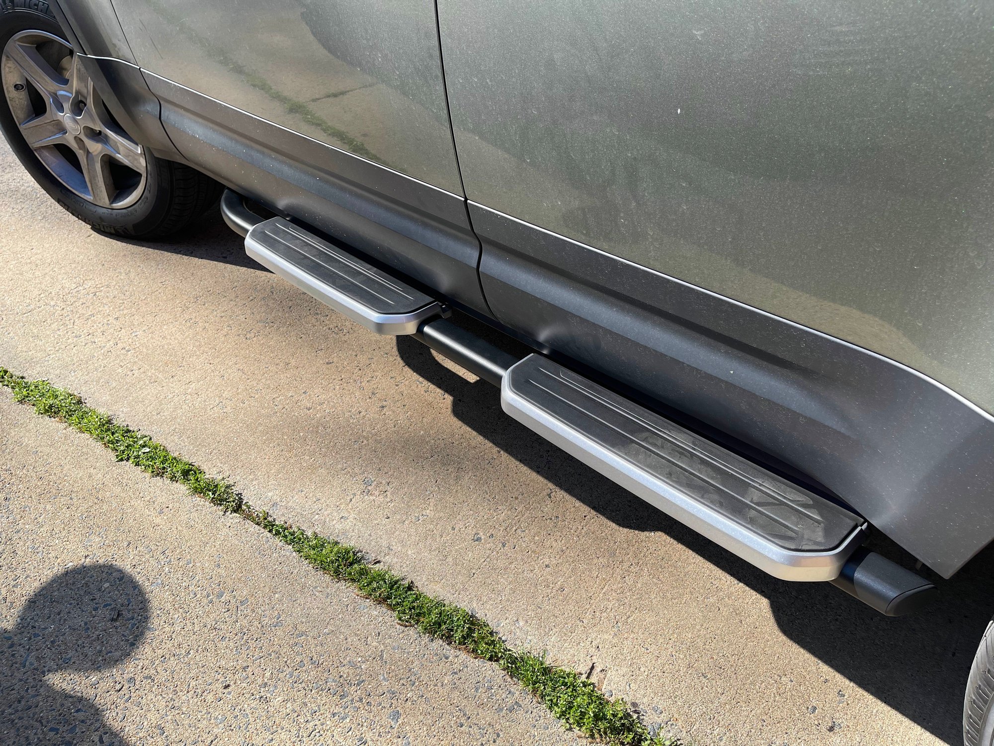

I just installed these on my 2020 Defender 110 P300 and wanted to write a quick review on the set I found on
Amazon Amazon
. This is a really nice side pair of side steps, visually and structurally. The only difference from this and the OEM version that I can tell is that the "Defender" logo is NOT stamped on the tops of steps. However, in this kit you DO receive all of the clips you need to reinstall the panels (I understand you have to purchase these clips separately if you go with the OEM option). I also got a clip remover tool and a few other tools with this. Before I installed, I watched "Land Rover Defender 2020+ Side Step/ bar/ Tube Fitting Instructions" by "powerfulukltd" on YouTube a few times. I took my time and it took about 4 hours from start to finish mainly since you have to cut away (4) 2x4'' rectangles on the undercover and (4) on the plastic rocker panel cover, per the instructions (a utility knife, wire clippers, and some patience worked for me). It's helpful to raise the vehicle height to off road mode to work under the Defender easier. Kids don't fall now when entering and exiting. Thanks!
