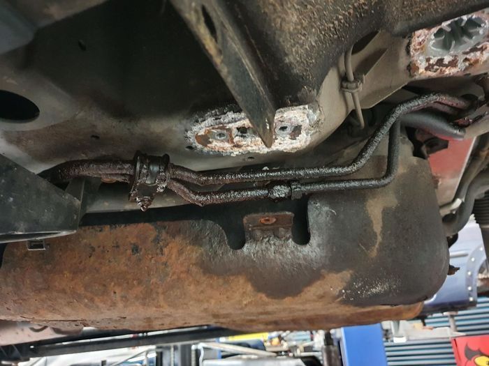

Please look at these insane photos below. This is a 2014 Range Rover (Full Size) from the UK.. L405. A mechanic posted this on a Range Rover forum and it’s becoming increasingly common. Also note the brake pipes etc. Also all the little brackets are steel, and other components are steel.
This is what I worry about. Galvanic corrosion between the steel attachment and aluminum body / subframe mounting points -- water gets trapped there, add a little salt mixture and .. the aluminum quite literally has potential to dissolve. It is an unfixable, unweldable, unrepairable condition.
Corrosion on ancillary components is going to be a huge concern with the L663 as is corrosion in these same areas... I’d say if you take it to the beach, you still should exercise caution, and clean the salt off. And use something like Woolwax here and there.
BTW -- personally, I’ve taken mine on the beach in Oregon multiple times, and will continue to do so because it’s great fun however I don’t go in the water with it. Beach yes. Water and waves no . I would never ever drive any car I cared about in salt water. Death recipe over time.
https://www.fullfatrr.com/forum/post612244.html
These photos aren’t a Range Rover Classic, P38, L322. That’s an L494. A modern vehicle. Constructed largely the exact same way as our L663 - it’s an all aluminum truck too. Clearly this thing has lived a very rough life but... wow
To pile on... here is a photo of the fuel tank cover on a 2014+ Range Rover sport (L494). Also a very similarly constructed aluminum vehicle. Our Defenders have basically the exact same steel guard over our fuel tank just forward of the rear wheels on both sides. This is in the USA. Expect the same issues on L663 10 years from now in salty climates, is my point. https://www.rangerovers.net/threads/...0#post-2499690
