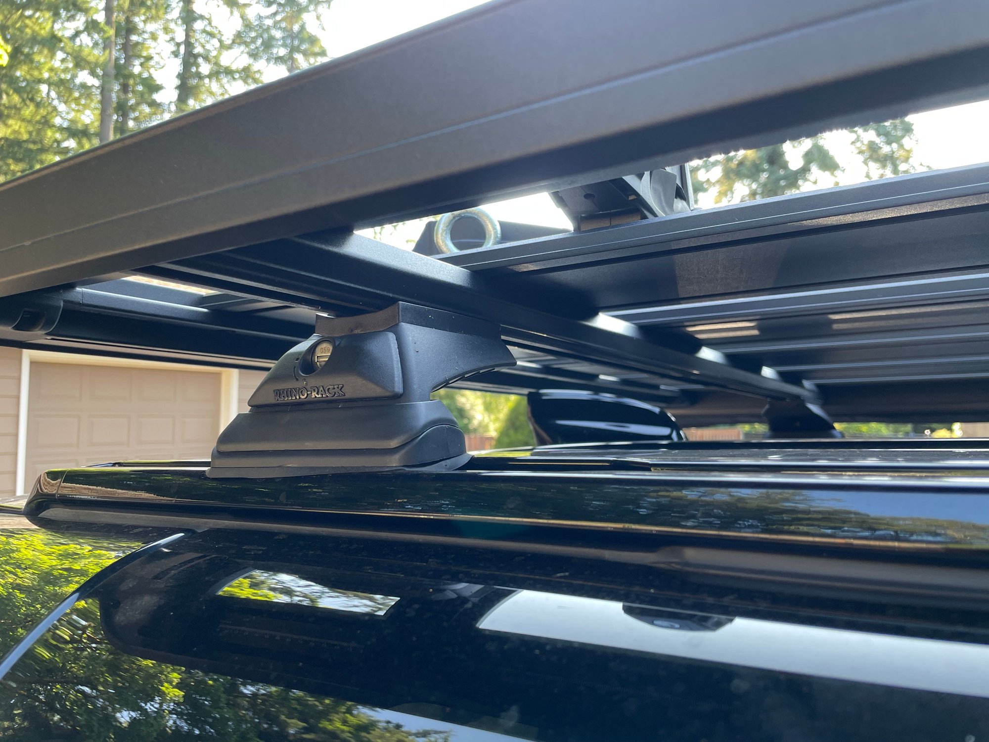

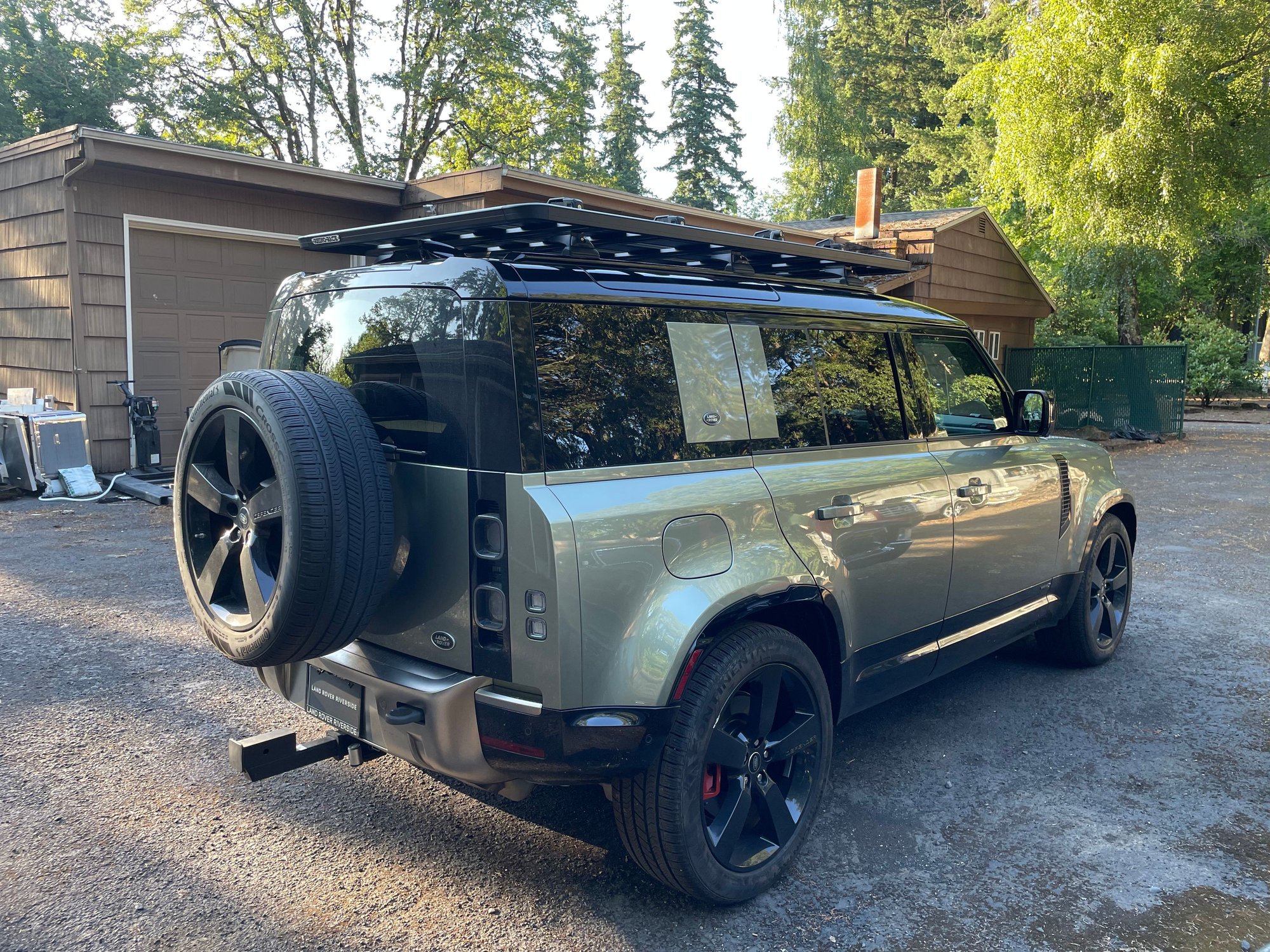

I wanted to retain the factory roof rails as well knowing I would be buying the factory side ladder at some point. I installed the Rhino rack platform 84 in x 49in to their RCL legs that attaches to the rails. I don't know the exact measurements from the inside leg to the other side but I was interested as well to put a table underneath.

That's a great looking rack. Do you have a part number for it, and the legs? I took a stab at it and the googler didn't give me anything that would fit. I'm sure I'm not looking in the right spot or need some more detail.

@chpsk8 I bought the Rhino Rack Pioneer platform 84x49 part# 52107F that was previously on my LR4. 6 Rhino RCL locking legs part#RCL6; 3 Rhino RCP Base Kit part# RCP73-BK and then Rhino Vortex spacers 10mm to clear the roof antenna. Part# QMVA10.

@Jbiggzs Thanks for the part numbers. I like that rack and the way it sits. I'm adding it to my wish list for when my P300 comes in next week.

Do you have the sunroof and does it open just fine?
