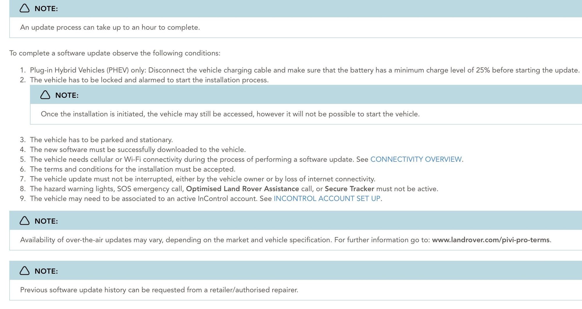

Not sure if single or double-locking has any effect on the install, as I have installed all of my previous updates, over four years worth, when my vehicle has been double-locked. Maybe just a coincidence, weak signal or connection, or battery was a touch low. FWIW, this is from the manual and it does not make mention of single or double-locking, just that vehicle must be locked and alarmed.
