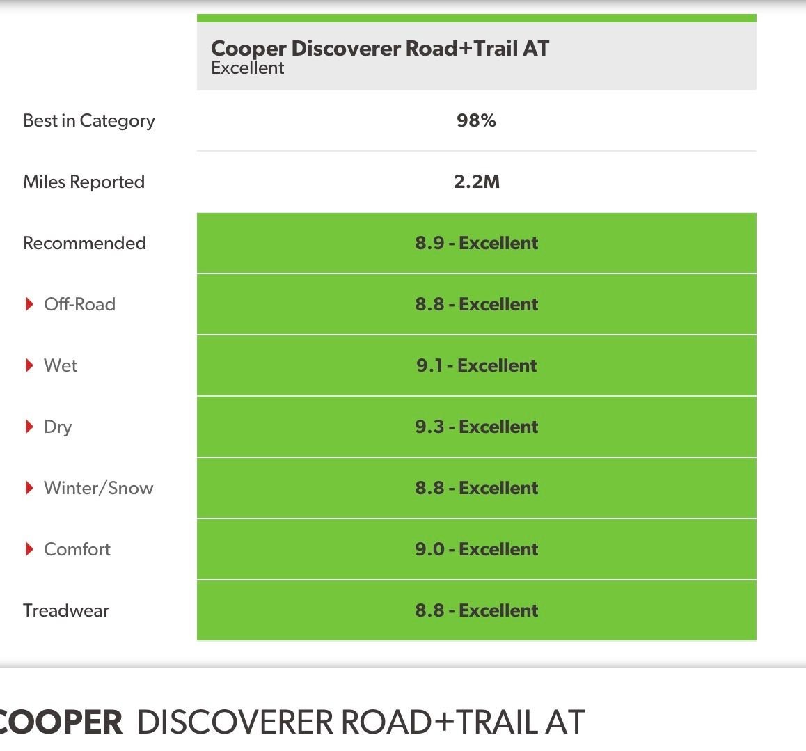

Thanks, CincyRovers. Totally agree, and I had a discussion with the shop manager telling him all that, but his hands are tied by higher ups. I’ve read of many owners here running the Nittos so I know they will be a good fit and application. All the time spent researching these tires and I came across many tire fitments that don’t make sense, such as big, heavy Tahoes and the like returning results for SL load rated tires, which doesn’t seem to jive with such a large vehicle capable of carrying big payloads of passengers and gear. The only tire that made my top three list that fits his parameters, XL load rating, 117H speed rating (130mph) and meets my preferences of WET/DRY/TREADWEAR/OFF-ROAD/COMFORT is the Cooper Discoverer ROAD+TRAIL AT. So, I guess it will come down to a coin toss of buying my Nittos elsewhere or having them order me the Coopers.

Thanks for the response, I was hoping to hear from someone running the Coopers on our Defenders. The majority of my driving is around town or highway, and being in Southern Florida with its flat terrain, I won’t see any true off-road or rock crawling and certainly no snow. Their high ratings as Excellent in every category is a confidence builder, and your comment about them being quiet is a big factor in my book, as some of the chunky tires in this On Road All-Terrain group can produce an annoying drone at highway speeds. The OEM Pirelli Scorpions had a great ride, but the Highway All-season style did not complement the rugged look of the Defender, where the Coopers have a nice enough aggressive tread which will look great on the Defender and add to its appearance.
