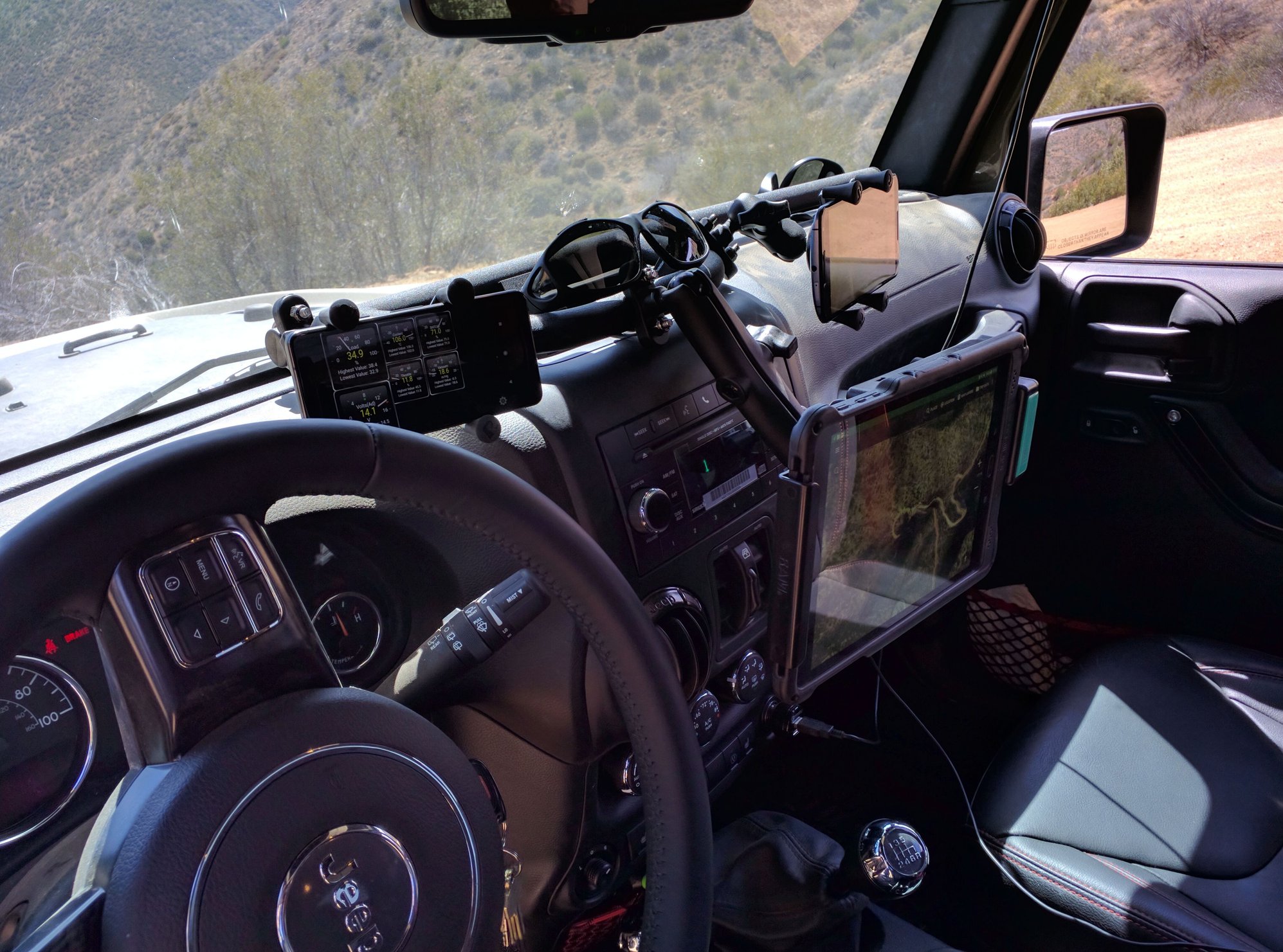

All true, but is it a *portable* tool that I can keep plugged into the OBDII socket at all times and that consumes little enough not to be a battery killer when the vehicle is parked outside for a few days? Does it have a real time information display app as simple to use as Torque (which is "fire and forget", gets to that panel with no extra clicks) so that I can have a phone mounted within view as an instrument cluster extension? Maybe even a dedicated old phone with that app being the only thing installed on it.
Originally Posted by DoctorofRocks
$20-30 versus $650 - I think there's a place for both. But I've also contemplated the former and a retired iPad to give engine data visibility that isn't shown on the dash (temperatures, charging, etc.)
This is how I had things set up in the Jeep. Running vehicle telemetry on a tablet is overkill (too little information for too big of a screen), but the phone was in the cradle with that panel on every time I sat behind the wheel. 10" tablet turned out to be a bit too big and heavy for the mount (looking back, 8" would've been fine - but the mount design and vehicle aesthetics of the Rover are different so it might just work here as well). Side question for a different thread later, which offroad navigation app to use. I've been happy with Gaia GPS until they got bought and went downhill, the renewal is in a few days, I'm going to give them one last chance.

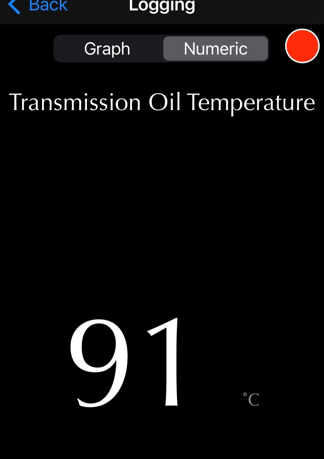

Gap tool heats pretty good, don't know if it's ok for long run use.
Battery voltage you can get from any lighter accessory.

as others have said GAP gets the job done. You can display up to 8 live values at once.
I mostly use it when airing up. I can sit in the car as my tires inflate to my desired psi.
the tool does get a bit hot if you leave it plugged in. There is no heat sink or if there is it’s puny. I have left it plugged in for long periods when I’m on the trail and making use of my on demand eLift. A LLAMS in disguise.
yes GAP is more expensive than a basic code reader but it does it as a side hustle.

OBD2 is an open protocol for emissions testing. No reverse engineering, just install and implement. It only pertains to emissions relevant systems, tho: the motor and an auto trans (if fitted). That's why there are Chinese dongles for $20 using it. And why they work on all cars made for the OBD2 standard.
The GAP Diagnostic IIDTool is a comprehensive Land Rover Diagnostic Tool that communicates with any system on a modern Land Rover. It's development encompassed tens of thousands of man hours (no exaggeration). Hence the price difference. The IIDTool G4 gets warm due to the DoIP chip required for 2017> LR vehicles. The internals of the IIDTool have been uprated to function with the heat. There should be no issues with leaving it plugged in for longer periods. We still do not recommend leaving it plugged in permanently, tho.
