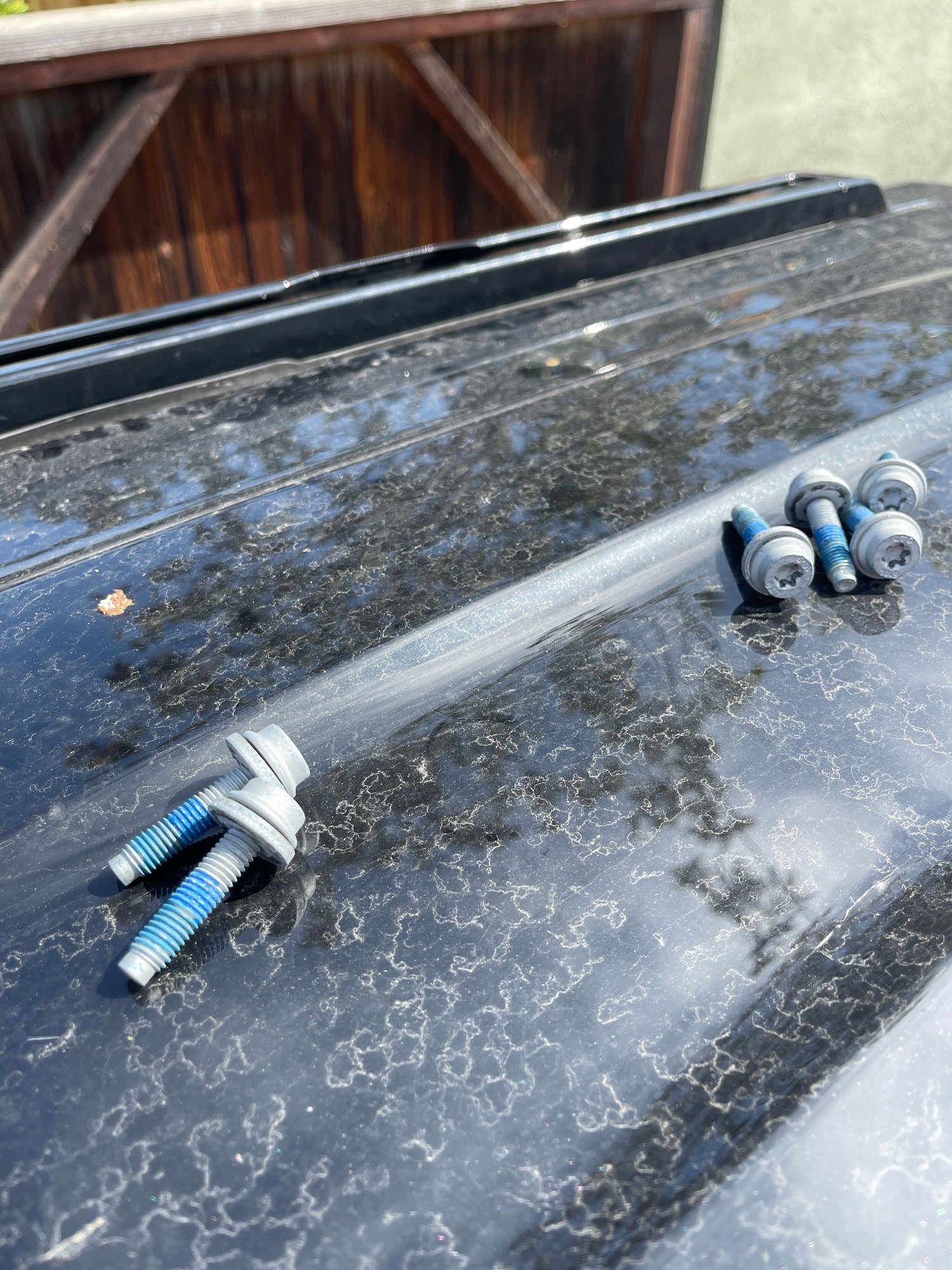

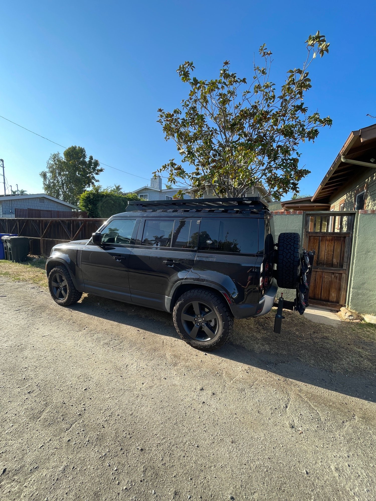

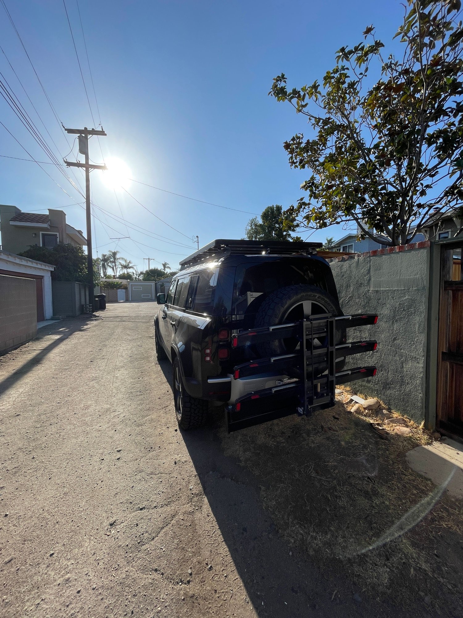

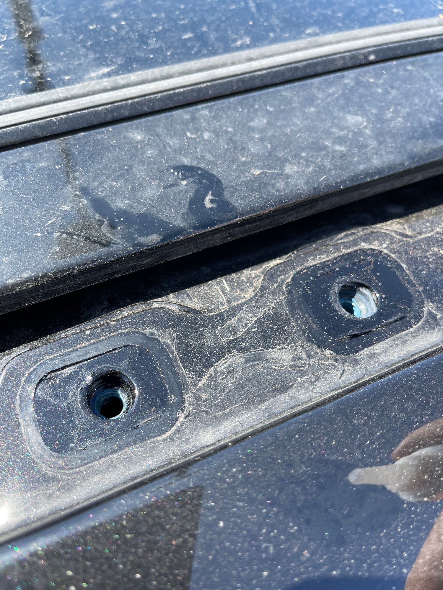

Alright some learnings for anyone else who is about to attempt this (in order of install).
Defender

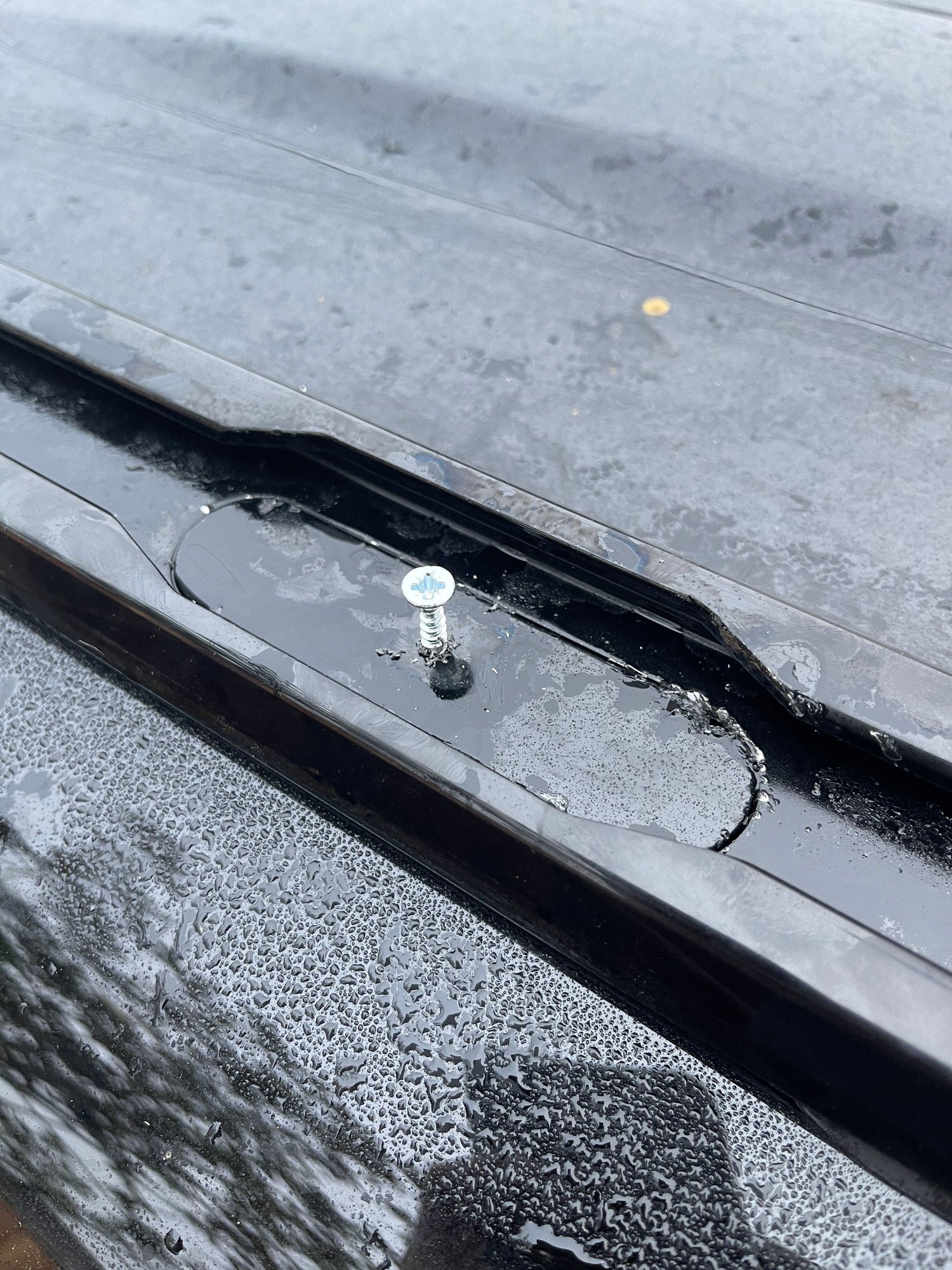

1) You should know that the black plastic caps that come with the OEM Roof Rails (those long oblong caps covering the bolts) are effectively disposable. Save yourself the trouble a drill a screw in the top and pry off with a hammer, they'll pop right off (but will break the tabs).

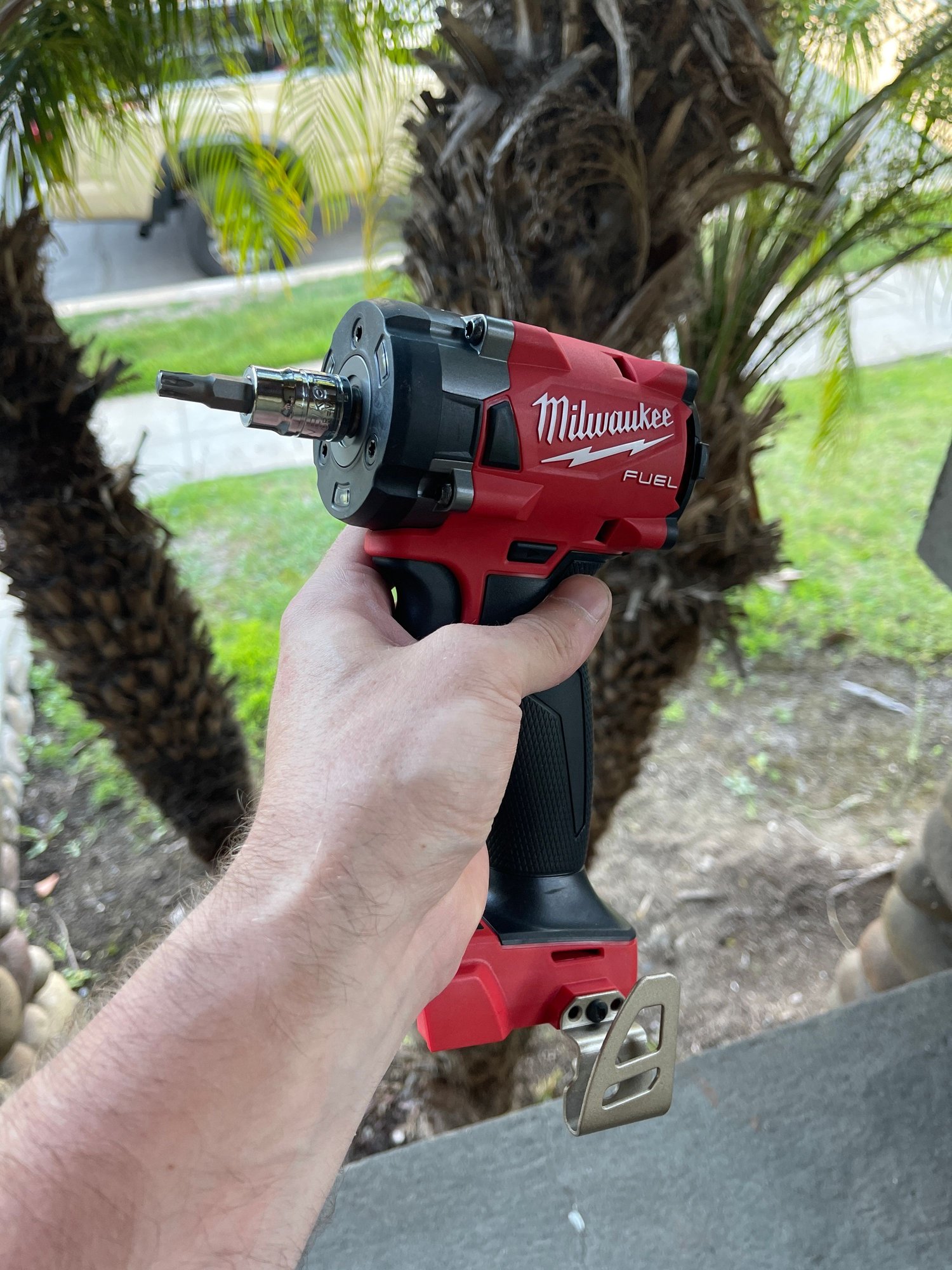

2) I went with and impact on the bolts. Throw the salt, pour out the liquor, do the pee dance, whatever it takes. I only had one scare, and I just applied more downward pressure and it came up no problem.
3) The bolts on the drivers left side of the car all had silicone on them, the drivers right side had NONE. I RTV'd both sides to just to be certain when mounting the FR.
Front Runner
1. Don't put the wind deflector on until you have the rack fully mounted on the vehicle. You will need access to the bolt holes for the mounting hardware and the deflector covers the track
2. Don't worry about those black plastic spacers, you do not need them to complete the install of the legs. They are shown in some of the diagrams on the instructions, but I did not find it clear in the slightest as to whether or not they were necessary.
3. The strange skinny bolt is for the last bolt hole (the one covered by black tape/goo), install it last.
4. Do not fully torque any bolts when mounting the rack, instead hand tighten all locknuts before torquing anything down. I recommend starting on one side, and getting all the hardware in place, and then continuing to the other. It you hand tighten you will have enough room to slide the bolts into the feet.
5. Measure and mount the rear of the rack first. You will have a much bigger area to measure for center if you begin at the back and then work your way forward.

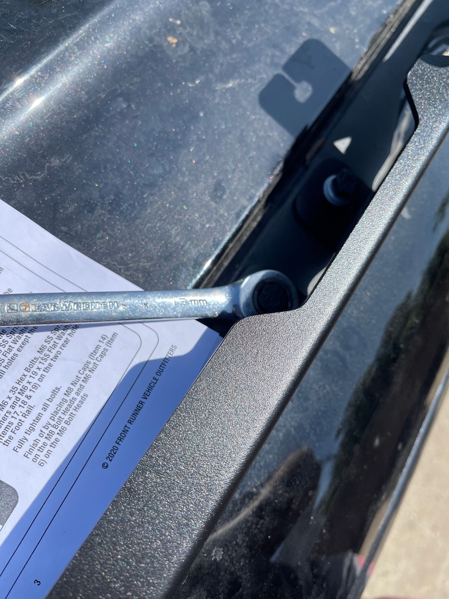

Highly recommend a 13mm gear wrench as it will save you a lot of time when mounting the feet and rack, also the rack bolts are off camber, so no socket/extender will fit.
Shoutout to @newdefenderseattle (IG) and @afterthelandroverexperience (IG) for their help and guidance in the process.

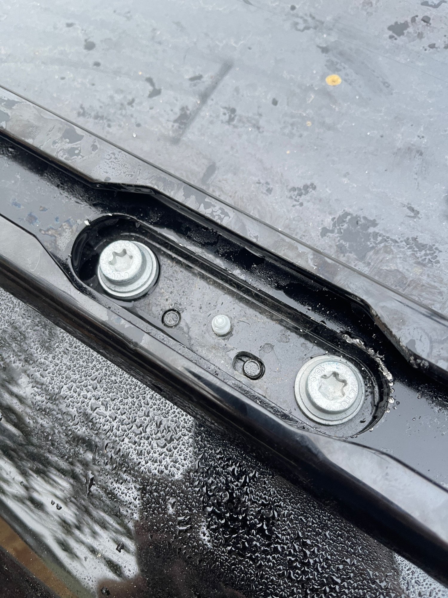

Initial Damage and Final Solution
The Bolts Everyone is Talking About
God Bless This Impact
Drivers Left - Plenty of Silicone
Drivers Right - No Silicone
Removed
Gear Wrench - Time Saver
