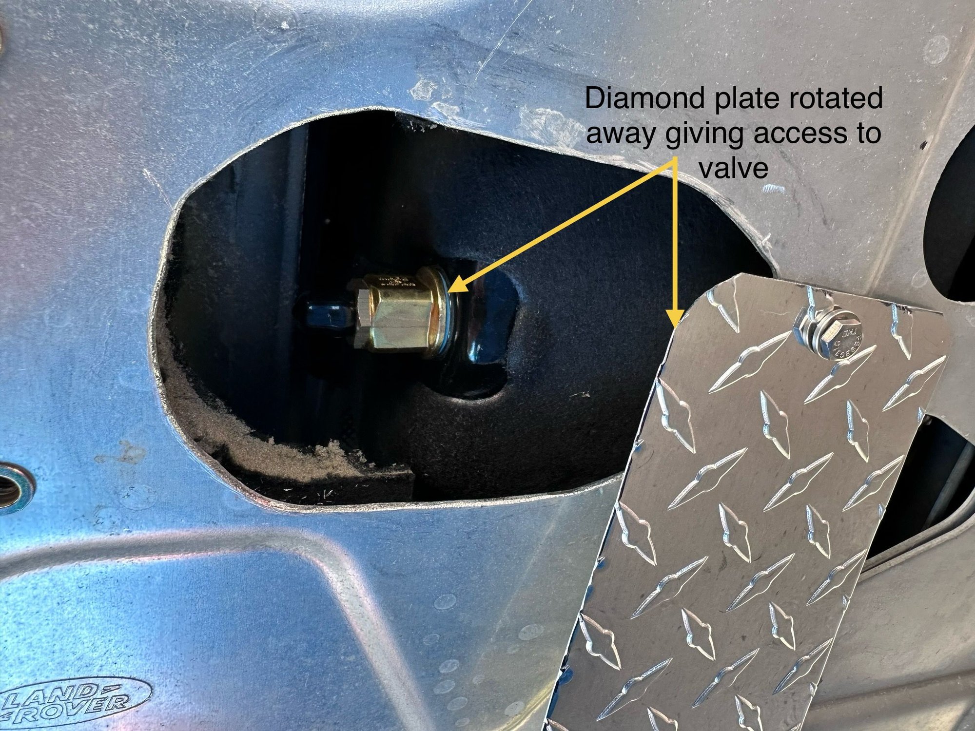

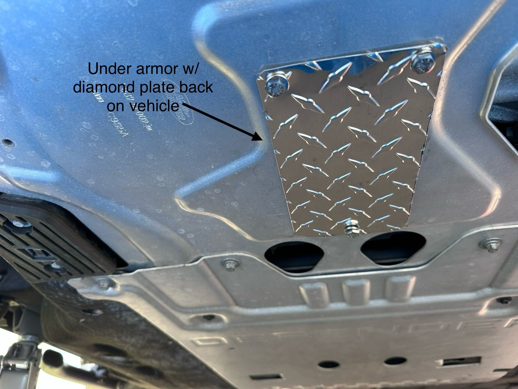

Wow, makes me feel better about modifying the under-shield so I can do 'regular' style oil changes in future. Note, i cut a larger opening and covered it with a new piece of shield to keep the protection, but add access for drain. I'll try to take a picture next time i am under.

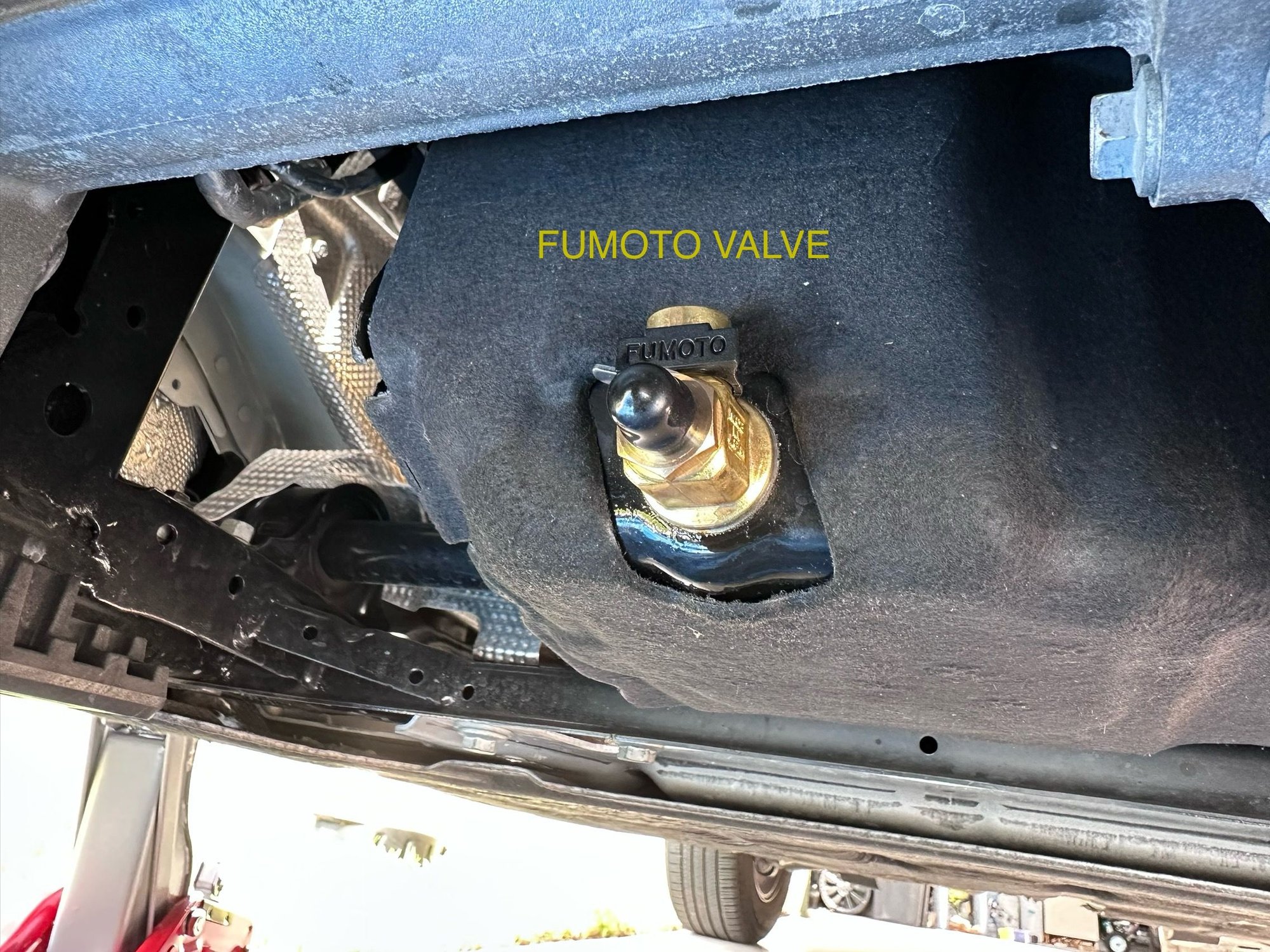

Ouch! I had been on the fence about the extraction method, but had that lingering fear of exactly that situation happening. I didn’t feel confident about sticking the extraction tube down into that netherworld, wondering if it is truly at dead bottom, or curled upwards missing a liter or two of old oil, which could lead to overfill. Glad I went with the Fumoto valve.

I have so many things I want to change/improve with my Defender!! Arg, now to add the @WTFChuck Fumoto valve.... I think I'll add it to my "When installing the Long Ranger Fuel tank, go ahead and...."
