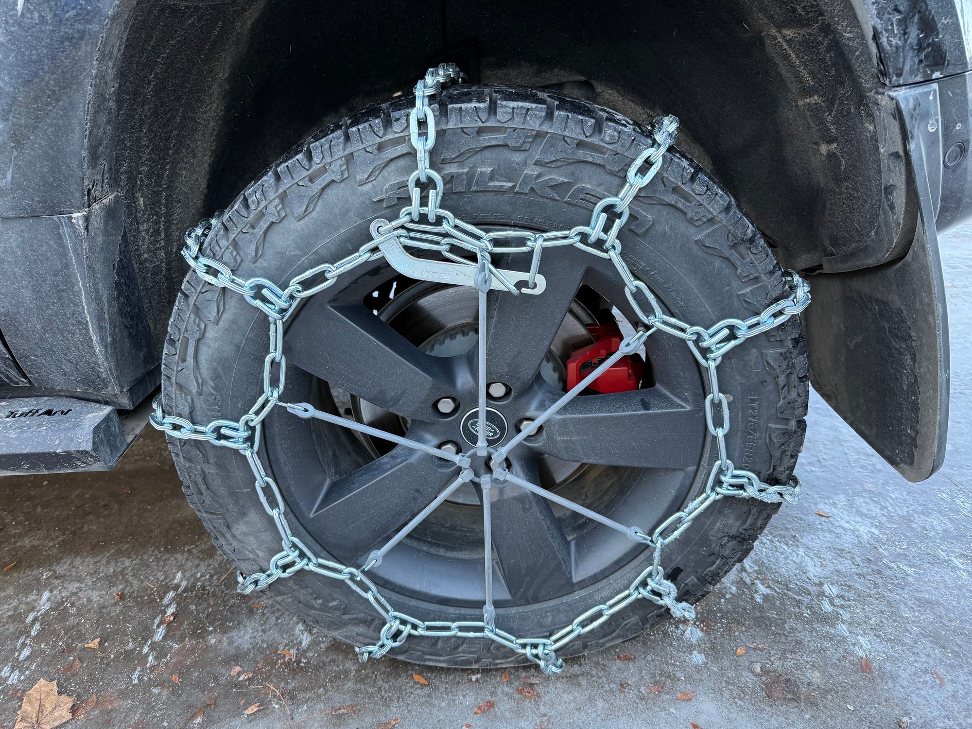

No interest in cable chains here—these are more for off-road then on. Last thing I would want is a broken chain beating the snot out of my fenders. Of course cables would be more comfortable at speed (relative) on road. If I found myself needing these on-road it’s because I needed to get home.
These are square link Pewag PWE3229S on 275/55r20s. This was a picture taken during some test fitting exercises. As you can see another link needs to come out of the inside chain to tighten these up a touch. I am probably going to settle on the 4th link inside and out along with boosting the air pressure up from comfort seen here to regular for less carcass flexing and a more stable fit. Last tip, I always put some extra zip ties and baling wire in the chain bag to deal with loose ends and I like to trim the extra links down to one or two to there is less to fling around.
Overall I feel like these fit fine with good clearance all around and I will be comfortable using them when really needed.
Test fitting some Pewag PWE3229S.
