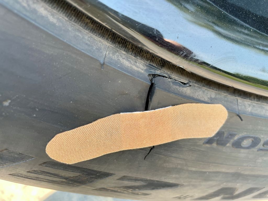

There's a more important factory than tread wear between XL and LT - construction. Check with the manufacture, but I'm willing to bet that the LT has an additional ply on the sidewall. If you're planning on any serious trail work where there's concern about tearing a sidewall, consider the LT. Otherwise the XL will likely provide better ride comfort, noise and highway handling characteristics. Sadly, I know from experience.
