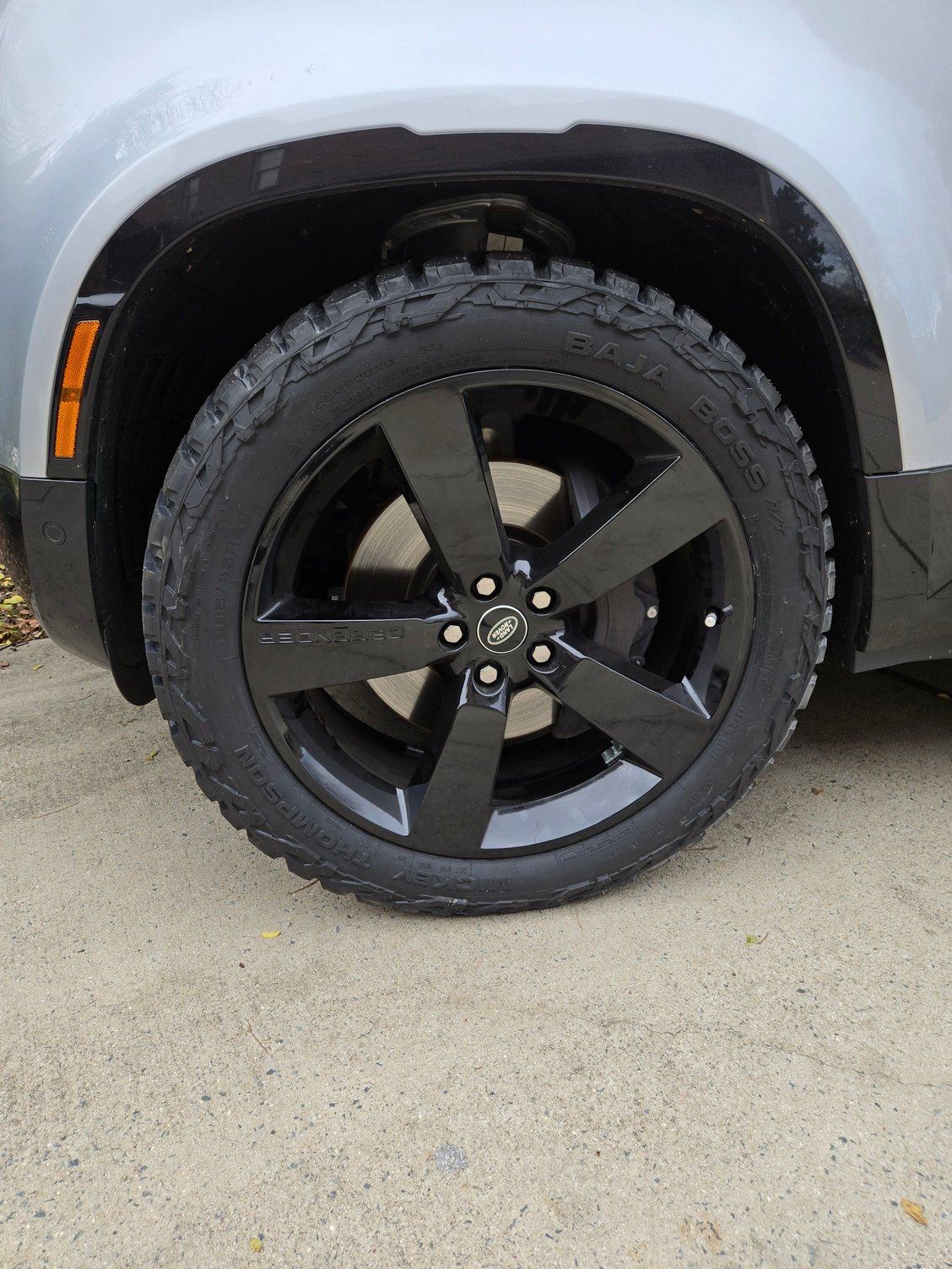

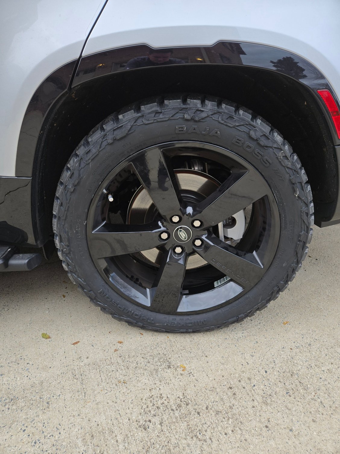

Default 285/45/r22
Hi. Noob to the forum but it has been extremely helpful as I've done some research on my new 2024 Land Rover Defender 130. In case anyone is interested, I just replaced the stock Continental Tires which are 275/45/r22 with Mickey Thompson Baja boss A/T tires 285/45/r22. These were installed without any lift or spacers and they seem to be entirely fine with no rubbing. In fact there seems to be plenty of clearance room. Ordered them and had them installed through Discount Tire.
don't know if this will help anyone else but as I was researching other tires the user feedback on the 285s with the 22-in rims was helpful to me.
