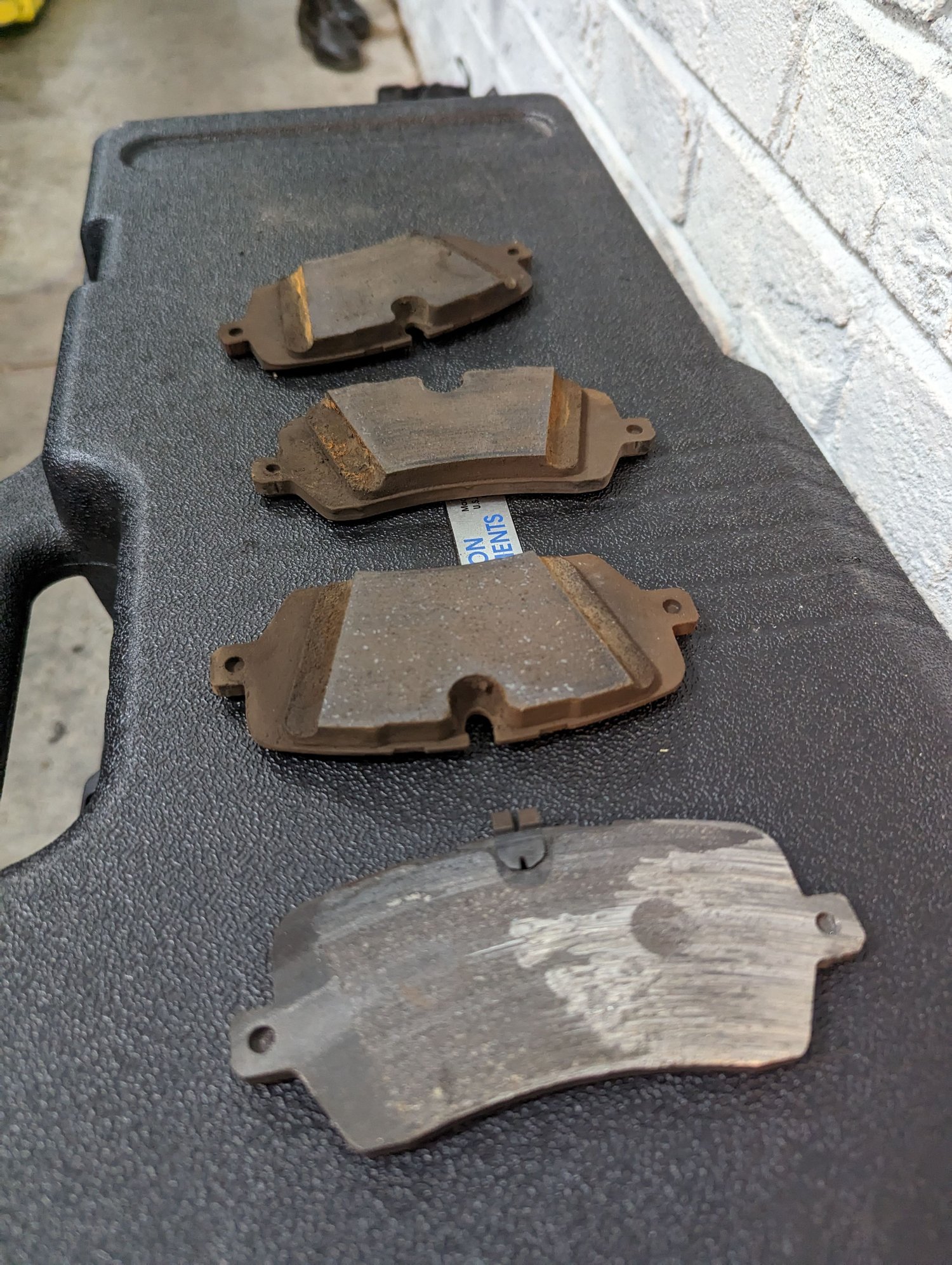

My wife started hearing a weird noise while braking. I took it for a quick drive and could hear a noise from the rear left brakes. I took a quick look and couldn't see anything obvious. I put the car on the lift, took the wheel off and looked at the brakes. The inside pad was just starting to be metal on metal. The other 3 pads have plenty of meat on them. Seems like a weird scenario considering they are single piston brakes. Same pressure is applied to both pads with floating caliper design. Maybe defective pad material on the one pad? Luckily AutoZone had a set that fit the car in stock and it took an hour from start to finish (including running to the store. They are easy to work on. The car has 53000 miles on it. Not bad either way.

How did the guide pins look? That can happen when the guide pins get bound up.

Hmm. Have not tackled this on my L663, but that's a caliper issue I'd say. (or pins, etc) Kind of weird.

The guide pins seem fine. Nothing felt like it was binding. A seized guide pin is the only way I think this could happen (other than pad material defect).

Must have been a bad pad then. I bet the entire slug of material separated from the backing plate.
I guess that's the best possible outcome. Worst would be a front pad catastrophically failing in an emergency braking situation.

Humm. Might be sticking piston that doesn’t release thus causing premature pad wear. In any case a brake specialist can diagnose cause.

The issue is with a single piston floating caliper, this would wear out both pads and it applies even pressure to both pads at the same time as they are each used to apply pressure against each other. This would only be possible if the guide pin was stuck, which isn't the case here.
I genuinely think at this point the pad material separated from the backing plate. It makes the most sense.
