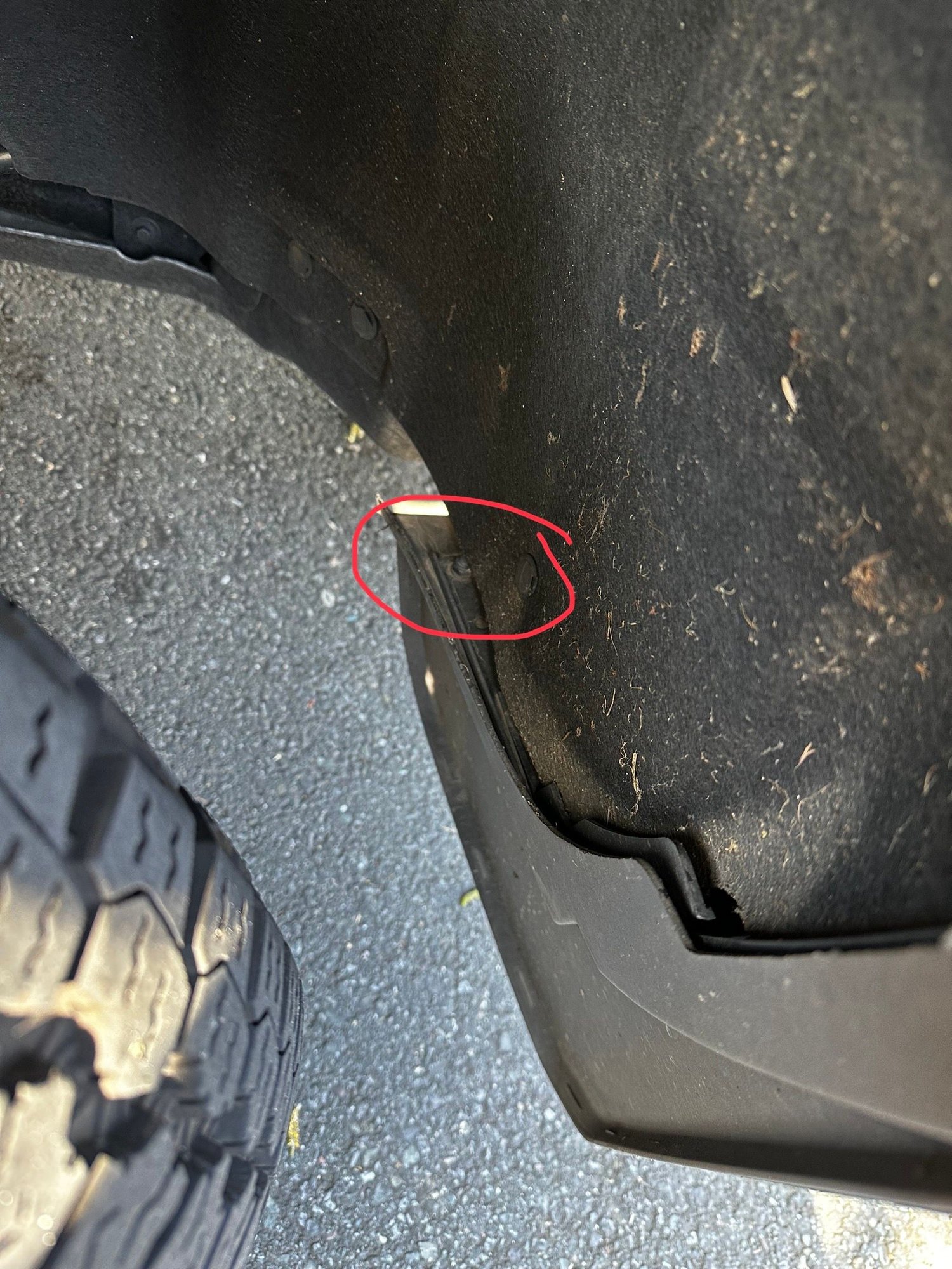

I also have the mudflaps were installed wrong and the right front speaker has a buzz. The mud flaps I looked at youtube video on install and I can tell that the port installed them without removing the wheel well felt. So now a hard turn and they rub like a card in a bicycle tire.

Are you able to show pics of the mud flaps installed wrong?

Sorry I was on vacation and did not get to this. Long drive up to Oregon in the Defender. It is hard to see but the problem is if you watch the videos or the install and look at the manual you can see that the wheel well felt has to be taken off and the metal bar is installed tight to other metal to make a solid arm to hold the flap in place. Mine they seem to have placed on top of the felt probably to save time so that it moves quite a bit. They have my car now so can’t get better photos but I do have a few. The flap should be thighter to the body.

Yeah there should be four bolts and as you say it looks like they didn't install the lower two.
To do that you need to fold back the wheel arch liner, and then remove the wheel arch plastic trim to get it back properly. The action of doing this will break all the clips which then need replacing.
But it's not THAT difficult. I had to take all this off to remove my rear bumper and the lower two bolts are a swine to get at. Much easier if you remove the wheel.
Guess the dealer didn't fancy doing it !!

I put it up on my friends lift and realized I had to do all the things you mentioned so since the dealer offered I took them up on it. Then when the rear door would not lock it made it even easier.
