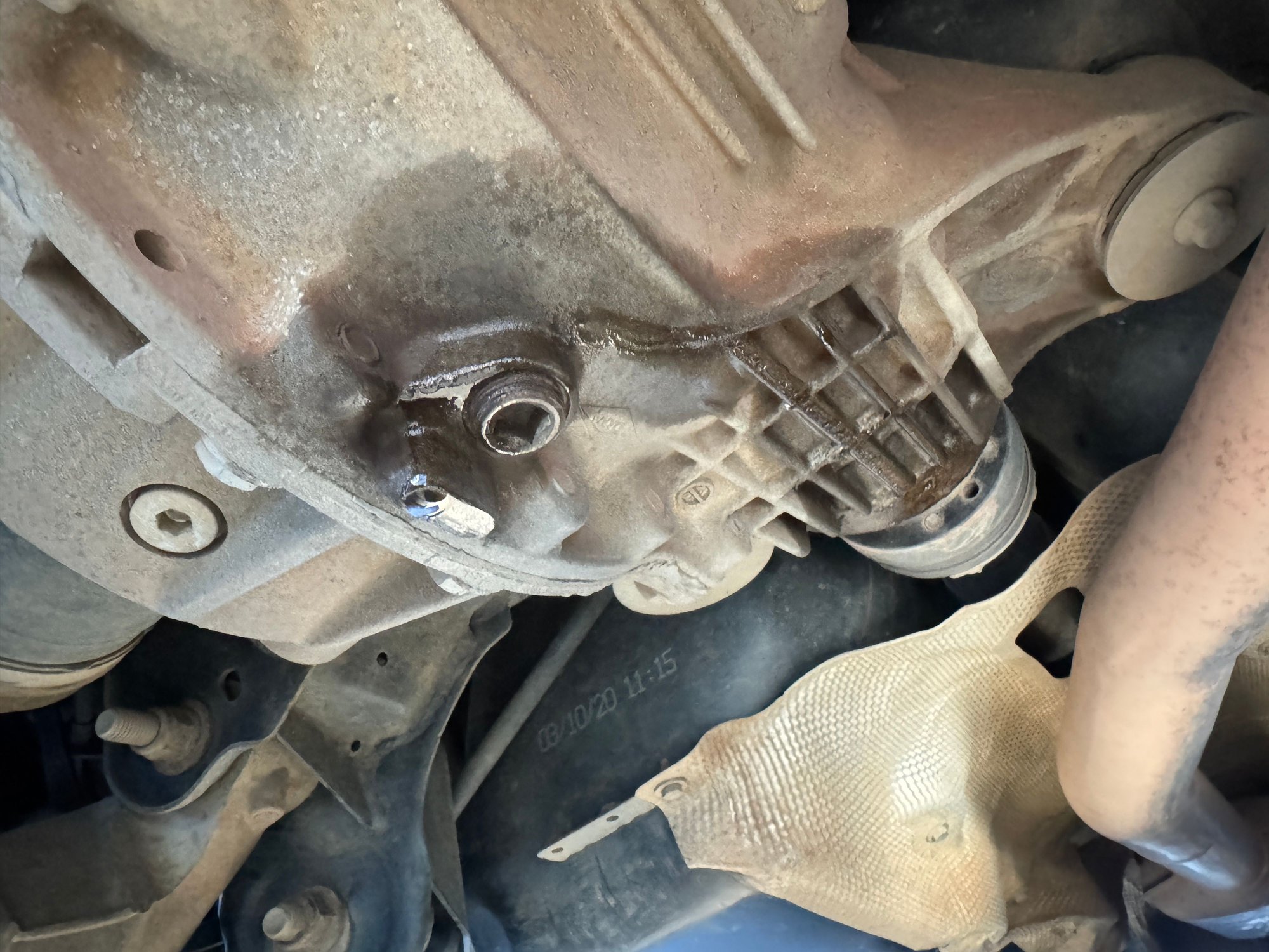

Here is what it looks like now after the cleaning. So it will be very obvious if it leaks even a drop.

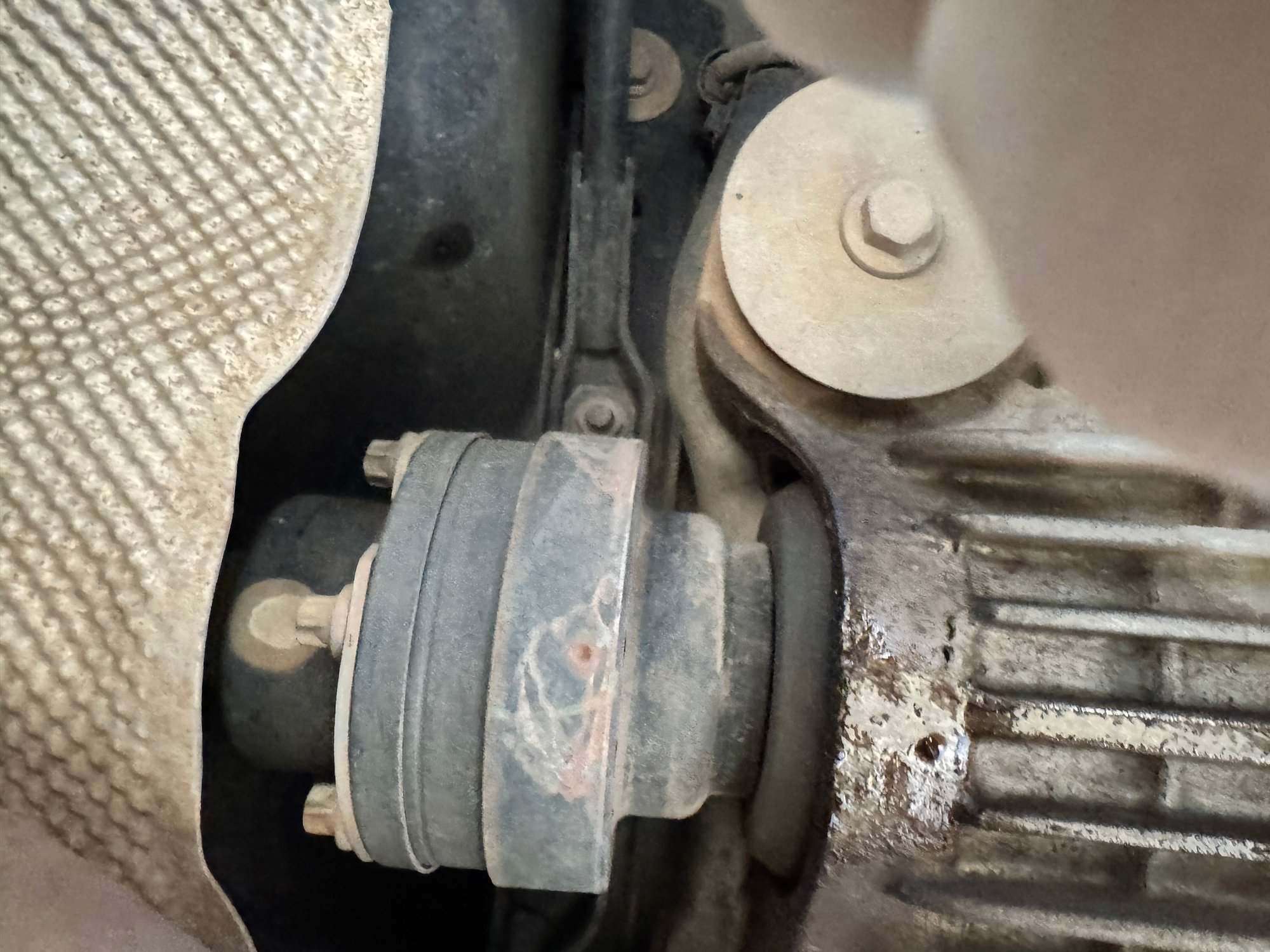

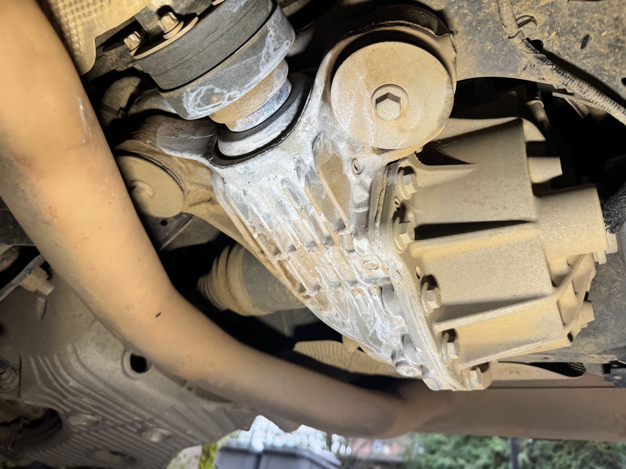

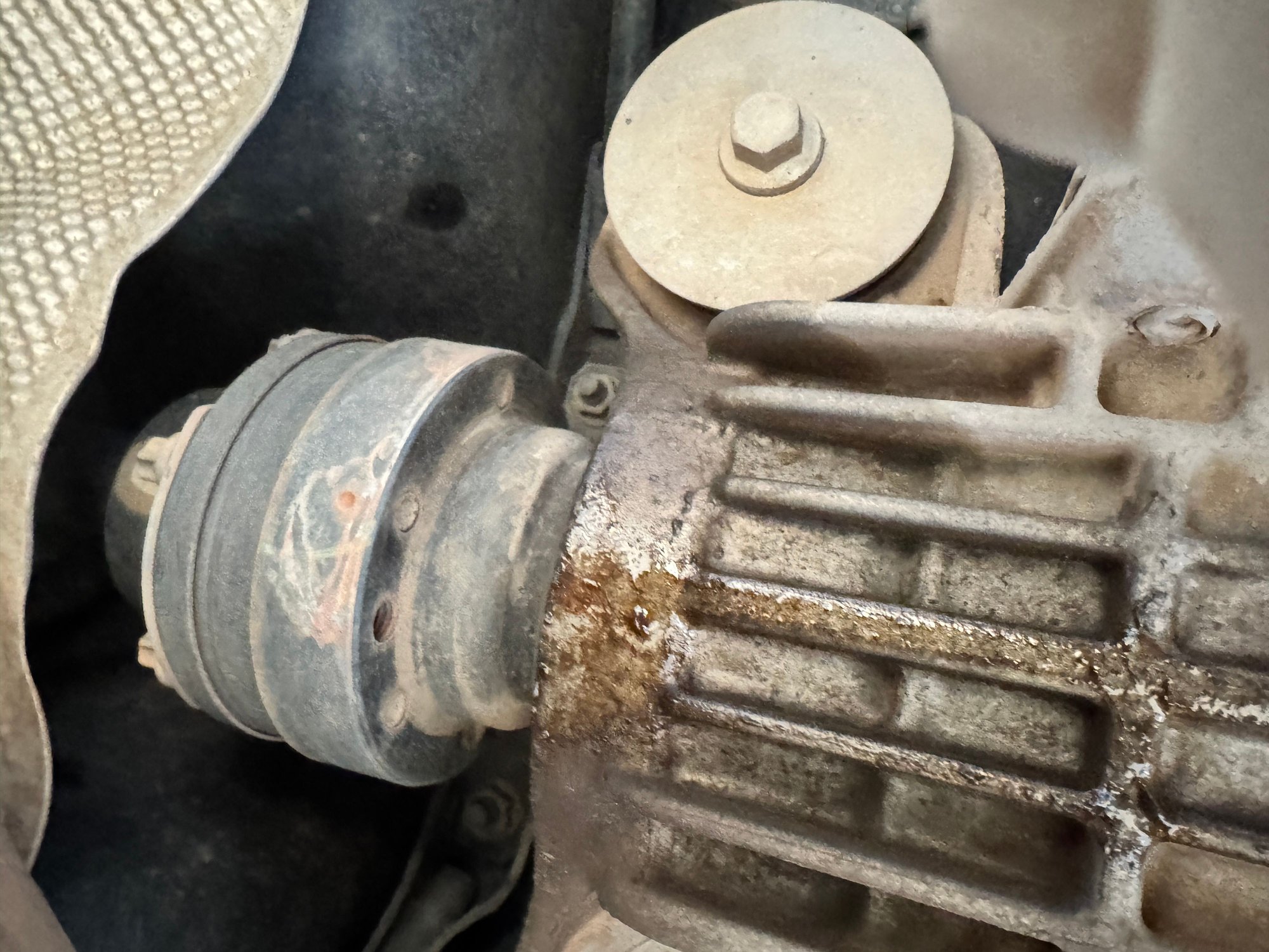

Most annoyingly when I went underneath to start the job, I realized the differential is leaking at this bloody pinion seal they told me wasn’t leaking pre-warranty expiration. Oh well. So basically if you find yours seeping like mine was, it’s probably going to get worse.
That’s the driveshaft going towards front of car on the left there.  leaking out the seal around the driveshaft, down, and then moving back with wind I guess...
This is before I touched anything.
