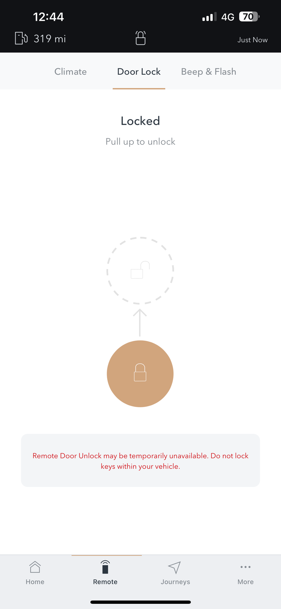

As above, the remote app unlock function hasn’t been working for some 6 months now. I’m up to date on iOS app and defender software.
Booking into the garage is a few month wait so wanted to try and diagnose the issue here if possible.
I’ve tried deleting the land rover remote app, and logging out etc etc but it doesn’t change anything.
when it first happened I had the key inside the car, so that is now deactivated since I couldn’t remote unlock and reactivate the key. We are down to 1 key now!
any help appreciated

Yup. That's it, I'm being aggressive direct because I'm trying to make you learn how to fold your ears just right so you can pull your head out of... well, you get it, and to look at a problem a different way, instead of being stuck on your conviction that your copy of the JLR app is faulty, because according to your research no one else is having that issue.
Never mind the obvious clues like red warning text on the freaking app itself, telling the user to NOT do the very freakin' thing you did. Never mind using some critical thinking skills and logic to maybe wonder if the very fact the app stopped working as intended correlates with you locking a key in the car?
I'm not saying the two are linked. I'm saying fix one problem, then see if that has a cascade effect and fixes the other problem. Don't be an NPC who takes one medication for an issue, only to take 5 others in order to combat the side effects of the first med is causing. Fix the first problem, then go onto the next if that doesn't work.
mate, I’m asking for help, why give me a bollocking?!
for context, I have used the app hundreds of times to lock a key in the car when out and about and not wanting to have the key with me. I use the app to then unlock the car and hey presto, the key works again.
my point here was that the usual thing didn’t work, and the app randomly stopped letting me unlock the car even though it had let me loads of times before. The red warning was not there when I locked the key inside the car - it appeared after.
I have tried locking the deactivated key inside the car using the active spare key, but this doesn’t reactivate the key like expected.
don’t worry about responding with anything, I’m not here to be told I’m an idiot, just looking for a solution.

So -- I don't agree with whatever is being proposed as the reason above is, even though the red text on that app screen does say "don't leave your key in the vehicle" or whatever. I would agree there is something wrong with the telematics of your L663, mate, My remote app works pretty much 100% of the time. I love it.

The way I understand it, is that you are not supposed to lock the keys in your car, because "Remote Unlock" is currently unavailable.
Once "Remote Unlock" is available again, it is okay to lock your keys in the car.
Why "Remote Unlock" is unavaible, I don't know. In Germany, it was unavaible for a few weeks due to safety concerns. With one of the software updates, the issue was solved.
