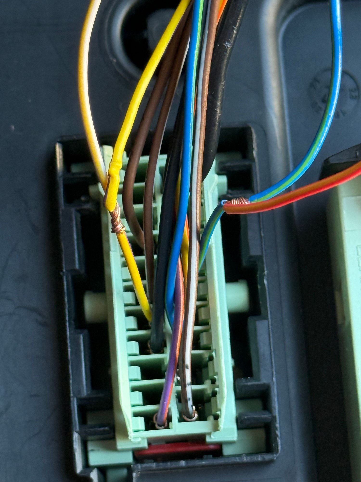

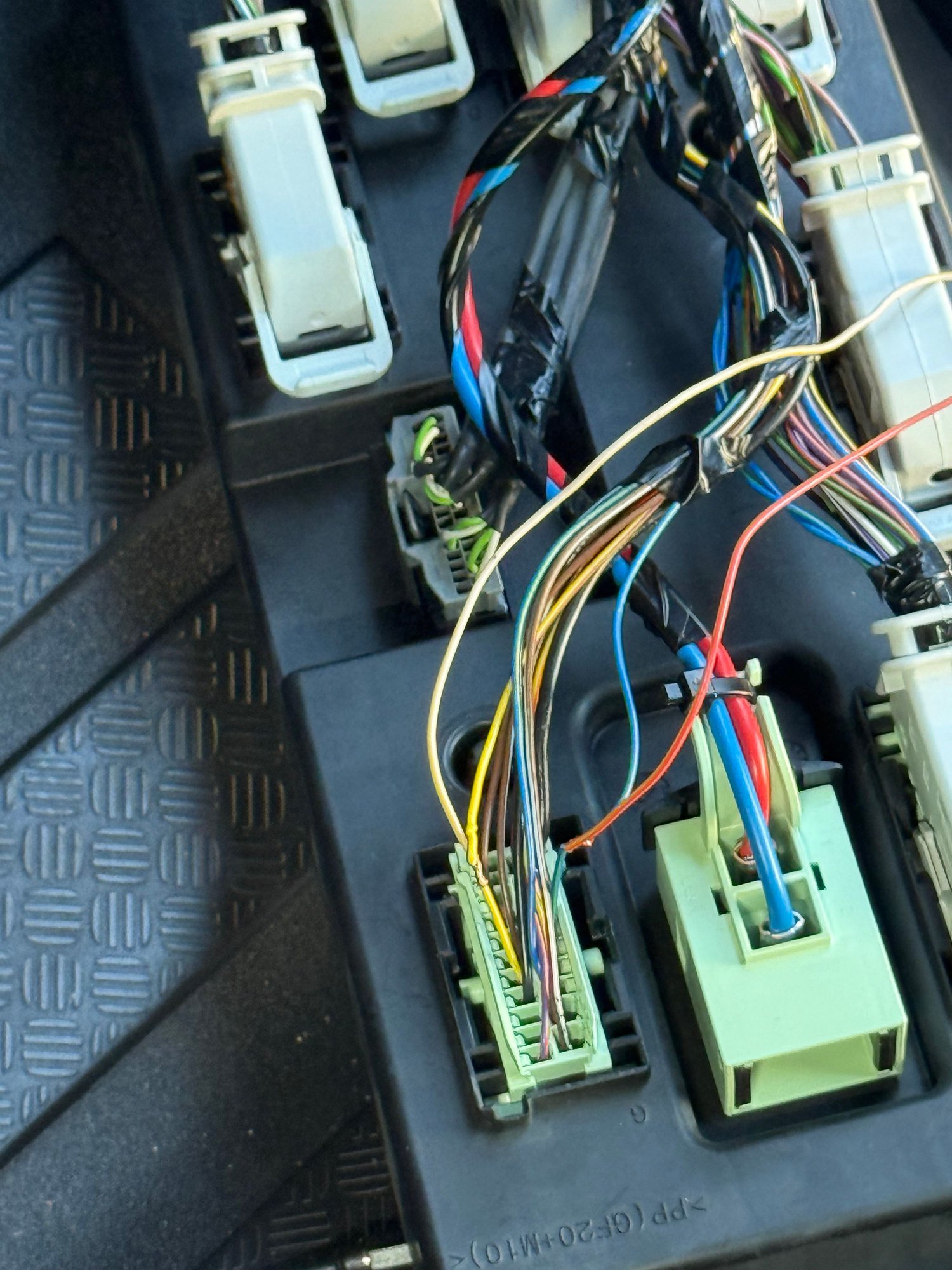

I finally managed to get everything working. I wanted to share the details in case anyone else runs into the same issue.
Even though the Land Rover service manual stated that the rear indicator wiring was already present in the loom, it turned out it wasn’t there at all. To make the rear blinkers function correctly, I had to:
  • Run one extra wire to each tail light, and
  • On the opposite side, route the blinker feed all the way back to the BCM
To make things more confusing, none of the expected wire colours matched what was shown in the diagrams. I ended up tracing and identifying the correct indicator signal wires manually before tapping into them.
After completing the wiring, I used the GAP IIDTool to set the rear brake light function so it operates correctly without the integrated indicator, which completed the retrofit.
MultiCAN-497 RrDIDrvMech New: Driven via BCM
MultiCAN-570 RearDIOpenLoad New: OL in ON state
I’m including photos of the BCM connections before everything was insulated and reinstalled, in case it helps someone else doing this job.
