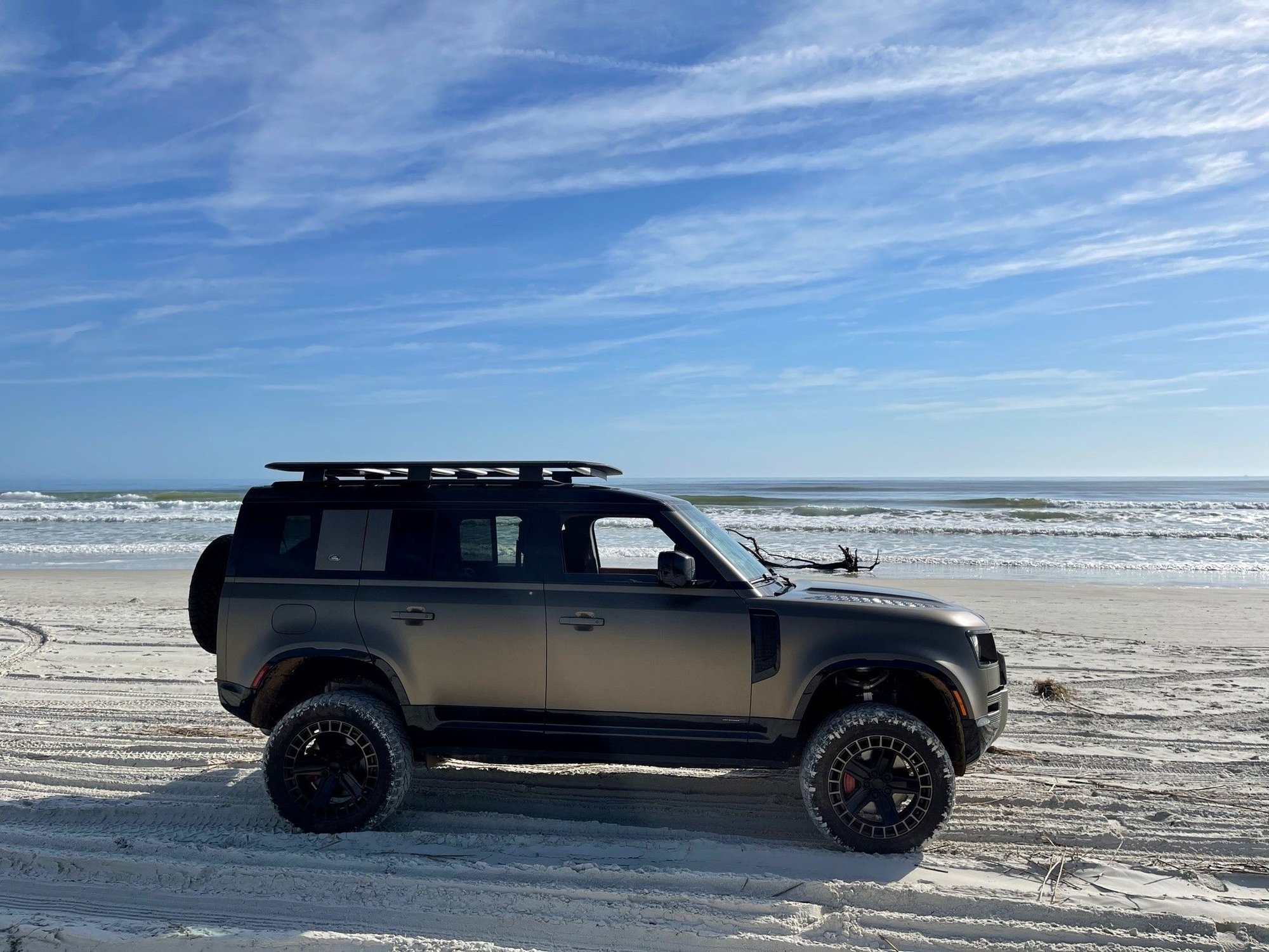

I hope that this thread isn't too old but looking for some input if possible. I currently have the OEM expedition rack (shown in the image below) and Ladder on my 2020 Defender 110X but like many, I am considering a rack that can allow more accessories and or even a roof tent. I have been reading about the concerns/problems some of you have had regarding the bolts coming off easily if at all without some problems. I spoke to someone at a shop recently who said "So the issue with the Locktite on the mounting bolts for the Land Rover Roof Rails is very common. It is absolutely important to heat up those bolts to release that locktite. Other than that the Front Runner Rack should mount up no problem for you." Has anyone done this? Any tips?
Also not happy about giving up my Extendable ladder on my driver's side, anyone found a way to solve that or have a good side mountable ladder recommendation?
Thanks in advance!
2020 Defender 110 X
